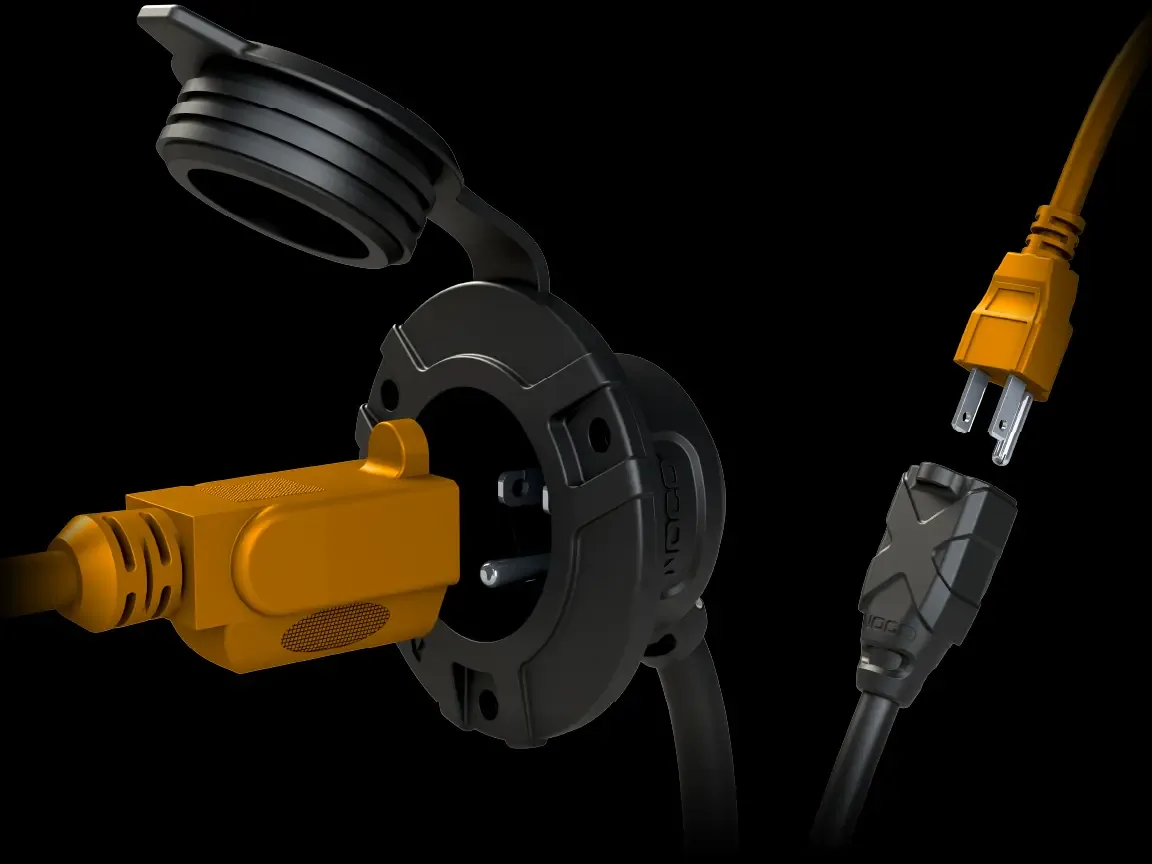

In May 2025 I traded up to a 2025 Lariat Hybrid and having all of the Genius products, installed them just in case.

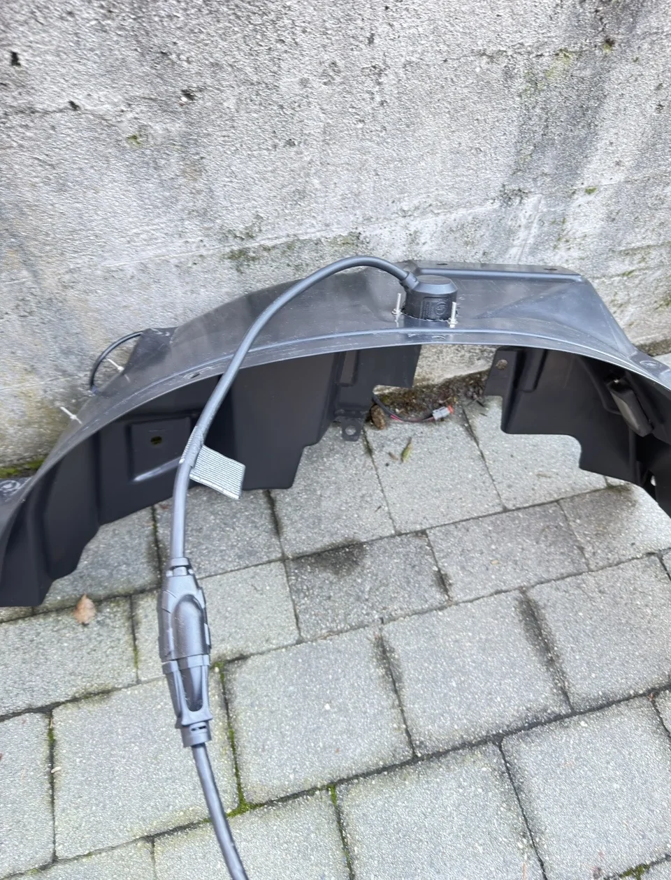

Looking for a cleaner solution for the Genius5, I purchased a GCP1 port plug and a 6 ft extension cord from Home Depot.

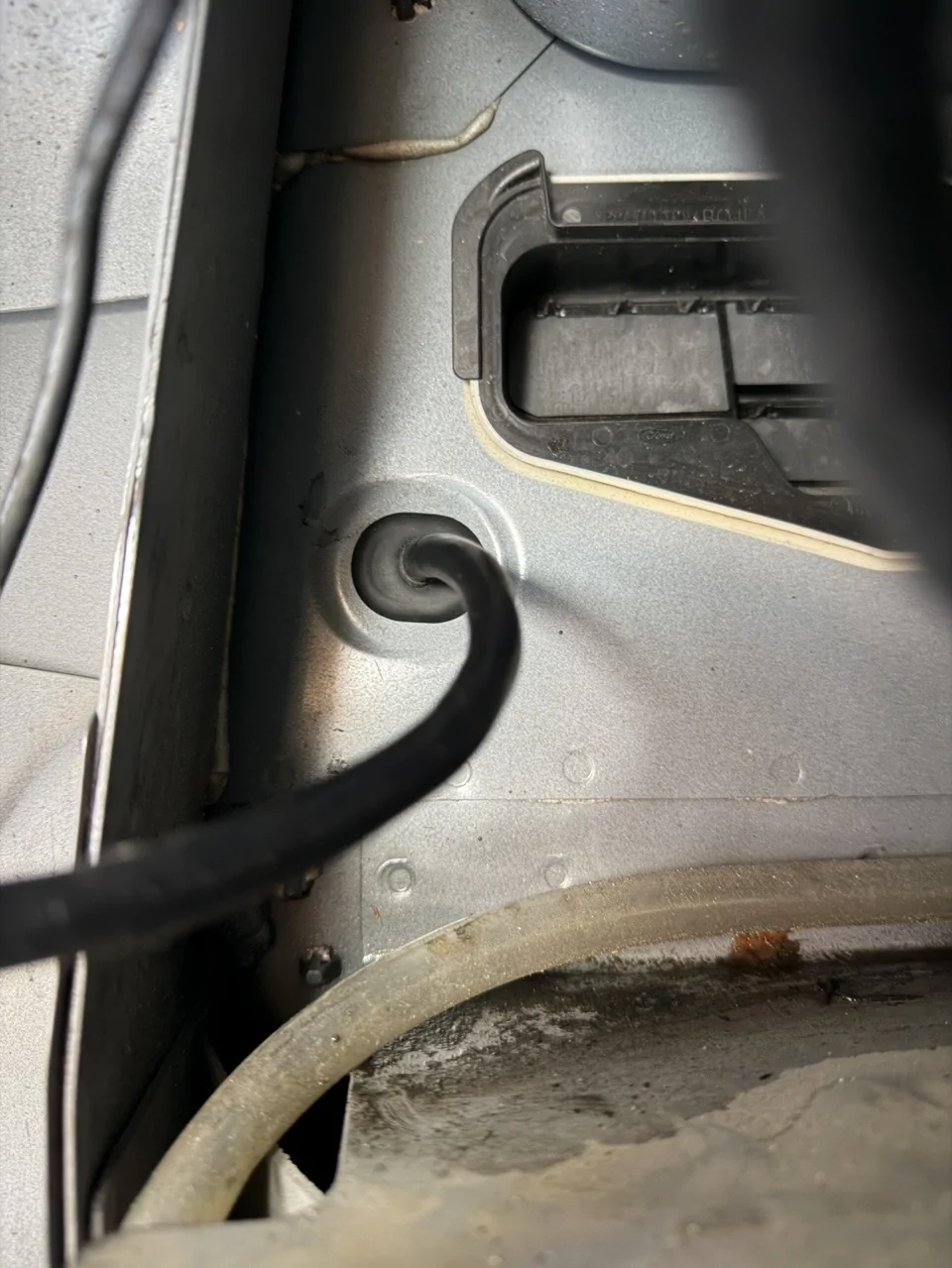

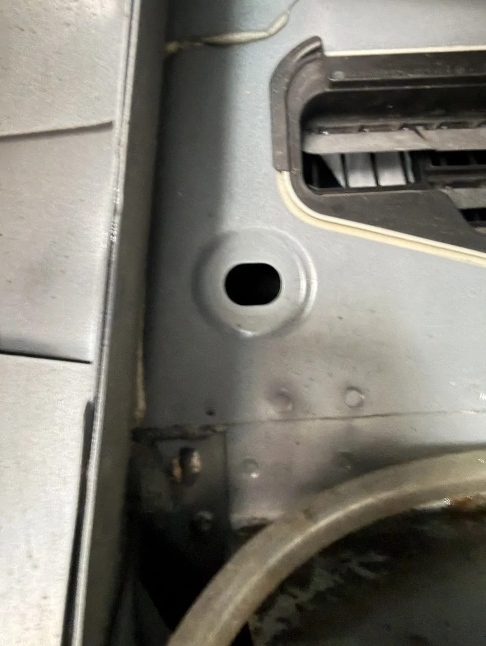

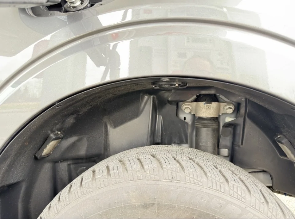

I popped out all of the plastic retaining clips and removed the left rear wheel well liner. This allowed access to the rubber factory grommet under the left rear seat.
I chose the rear liner over the front liner as it was rigid plastic and not the felt like soft material used on the front. I also placed it on the drivers side so that if I was ever in a hurry I wouldn’t forget to unplug.
I cut off the female end of the extension cord made a hole in the grommet and passed the extension cord through.
I reattached the female end of the cord on the cabin side and patched it back up. This allowed me to plug the Genius5 into the extension cord.

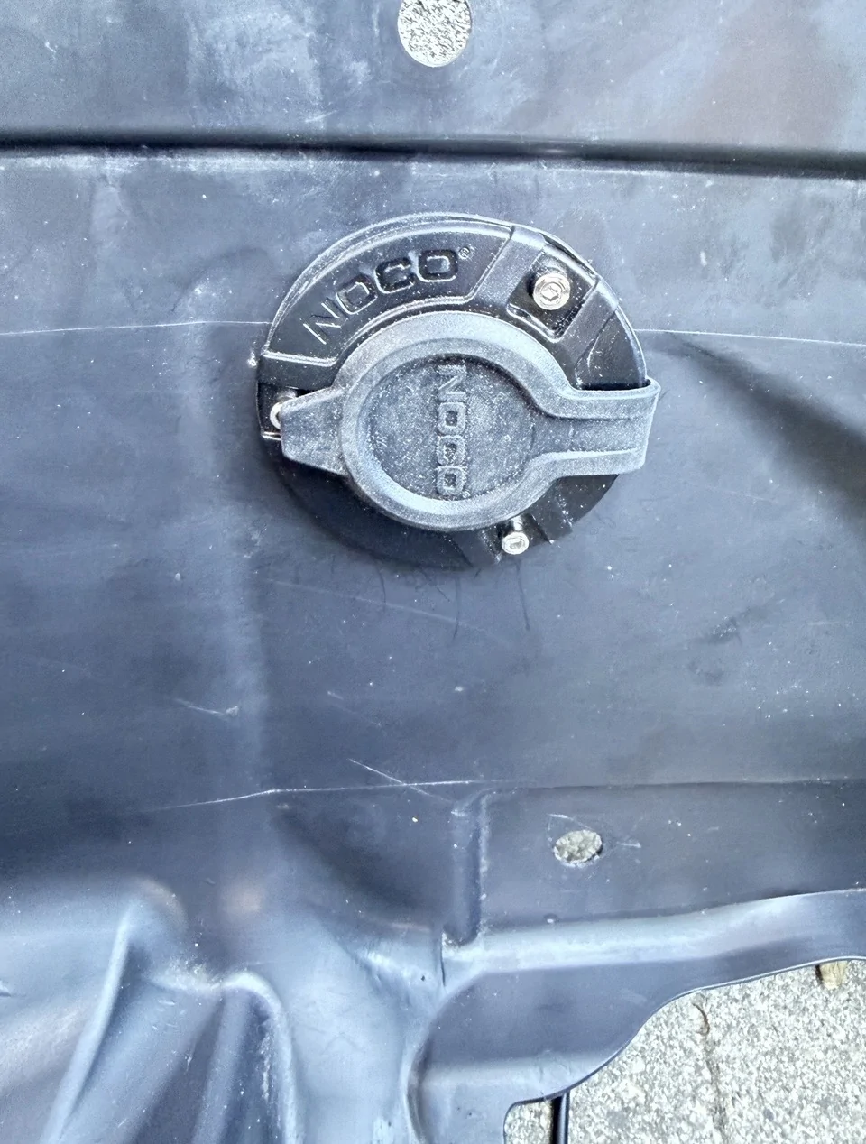

Using a hole saw I drilled in a flat spot at the top of the wheel well and mounted the GCP1 port plugging the extension cord into it.
The GCP1 is waterproof so when the seal is closed properly any water sprayed will not enter the port.

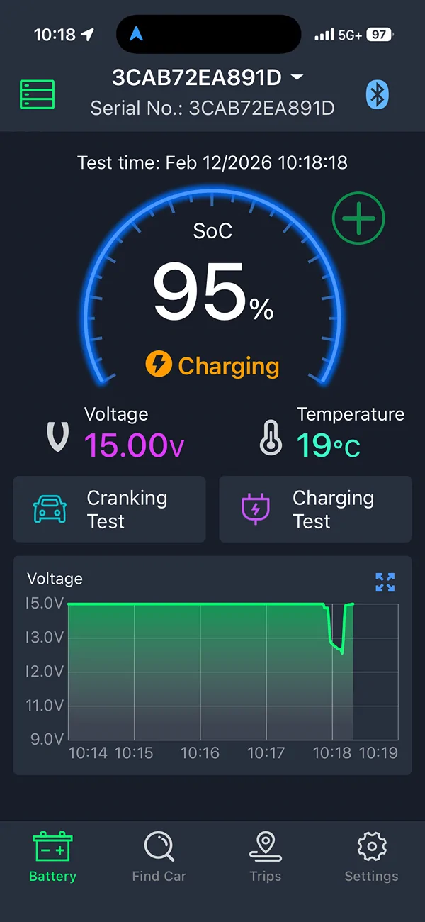

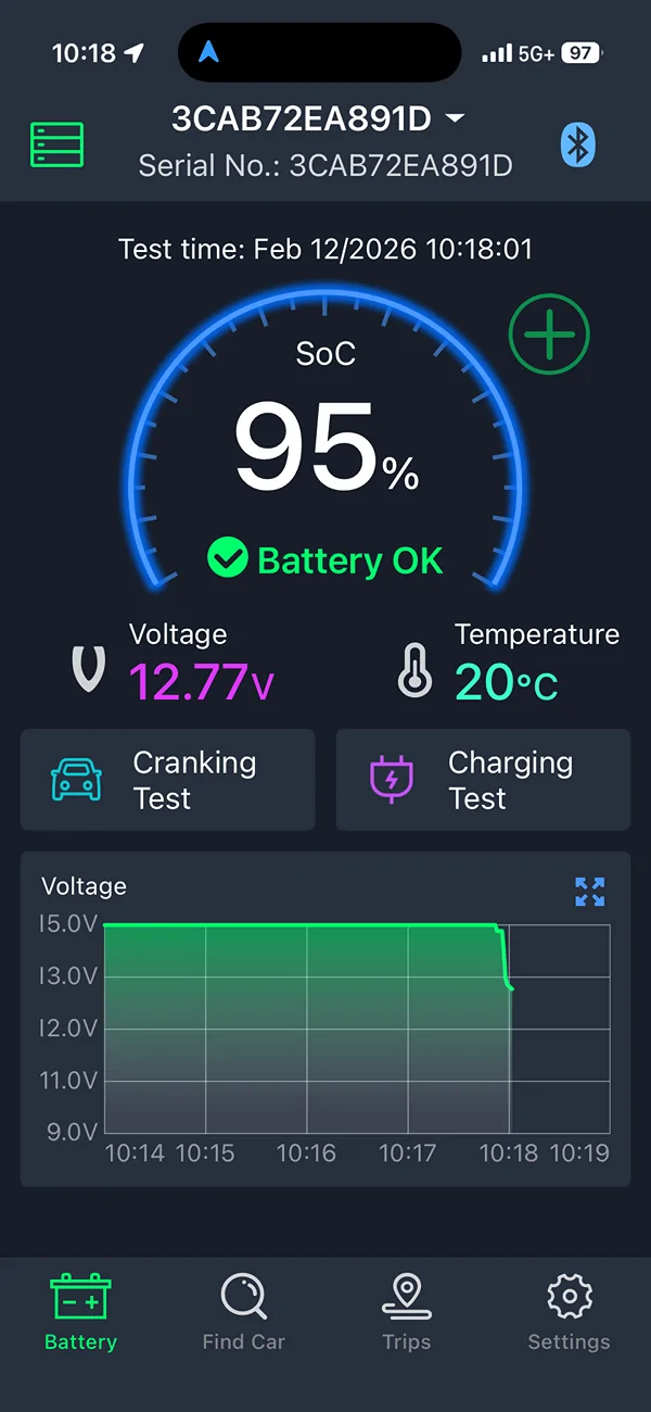

I ordered the Ancel BM200 the other day to monitor my battery.
https://a.co/d/02KI7yB6
Allows you to track your battery state of charge and voltage.

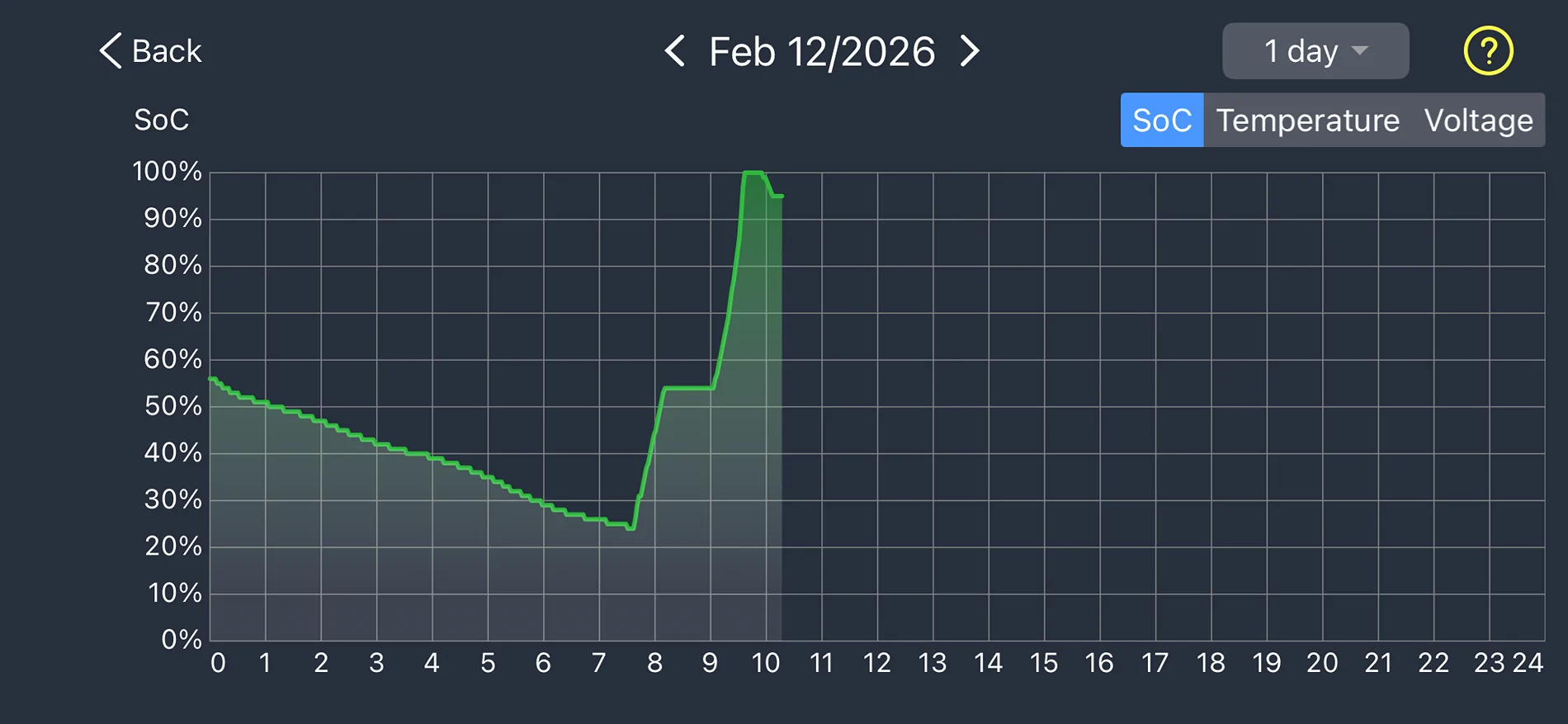

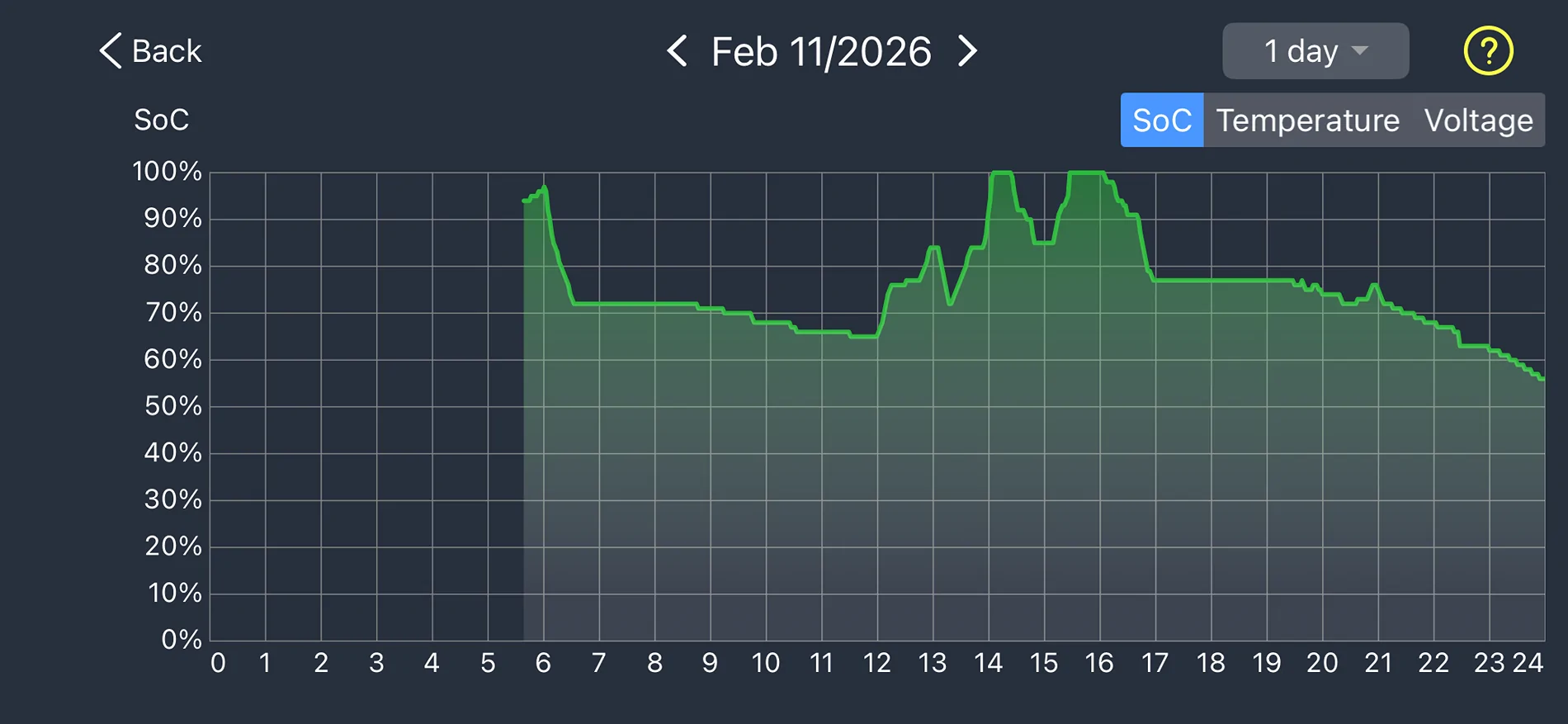

Seems after I fully charged my battery overnight, drove to work and parked overnight the SOC dropped to 65%.
After driving 2 straight hours yesterday the app showed me 100% state of charge.
When I woke up this morning the SOC had dropped to 25%.
Voltage seems ok. I’ll know more overtime as it creates a log.

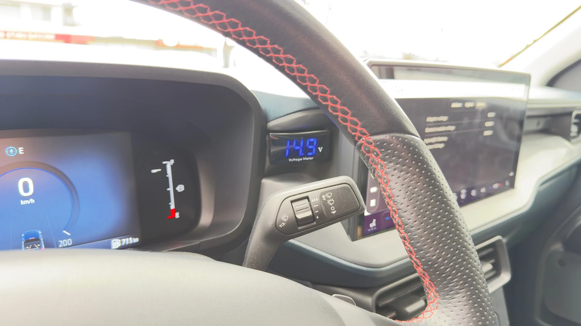

I also added this display which stays on constantly for a visual reference.
https://a.co/d/0iaIrrx7
Easy to install by popping the tray behind the screen out and feeding the wire down to the fuse panel.
Some screenshots from the app.

Nice tracking device - easy to know when it's time to recharge to keep battery up, if you don't drive much.
It's a voltage based SOC% - same as table you can look at, though they have their own scale compared to other's I've seen.
Which means any battery voltage reading, or derived SOC from it - is invalid after charging, until at least a 3-4 hr wait. And a reading while charging to get SOC from it - not correct either.
It will be interesting if you get a charging level of around 12.8 - means the BMS thinks the battery is fulling charged.
Do you at least get to tell the device what type of battery you have since AGM?
That big of a drop in voltage/SOC (though some is an invalid high start point) - you either have a battery on last legs and can't hold a charge, or you have a parasitic drain.
Have you had the SSM for AC module software update?
That will be an interesting graph after 3-4 hrs sitting, just getting in car for light to go on, then close and door lock for the next 30-60 min and beyond.
Voltage readings will be more telling than SOC graph.
