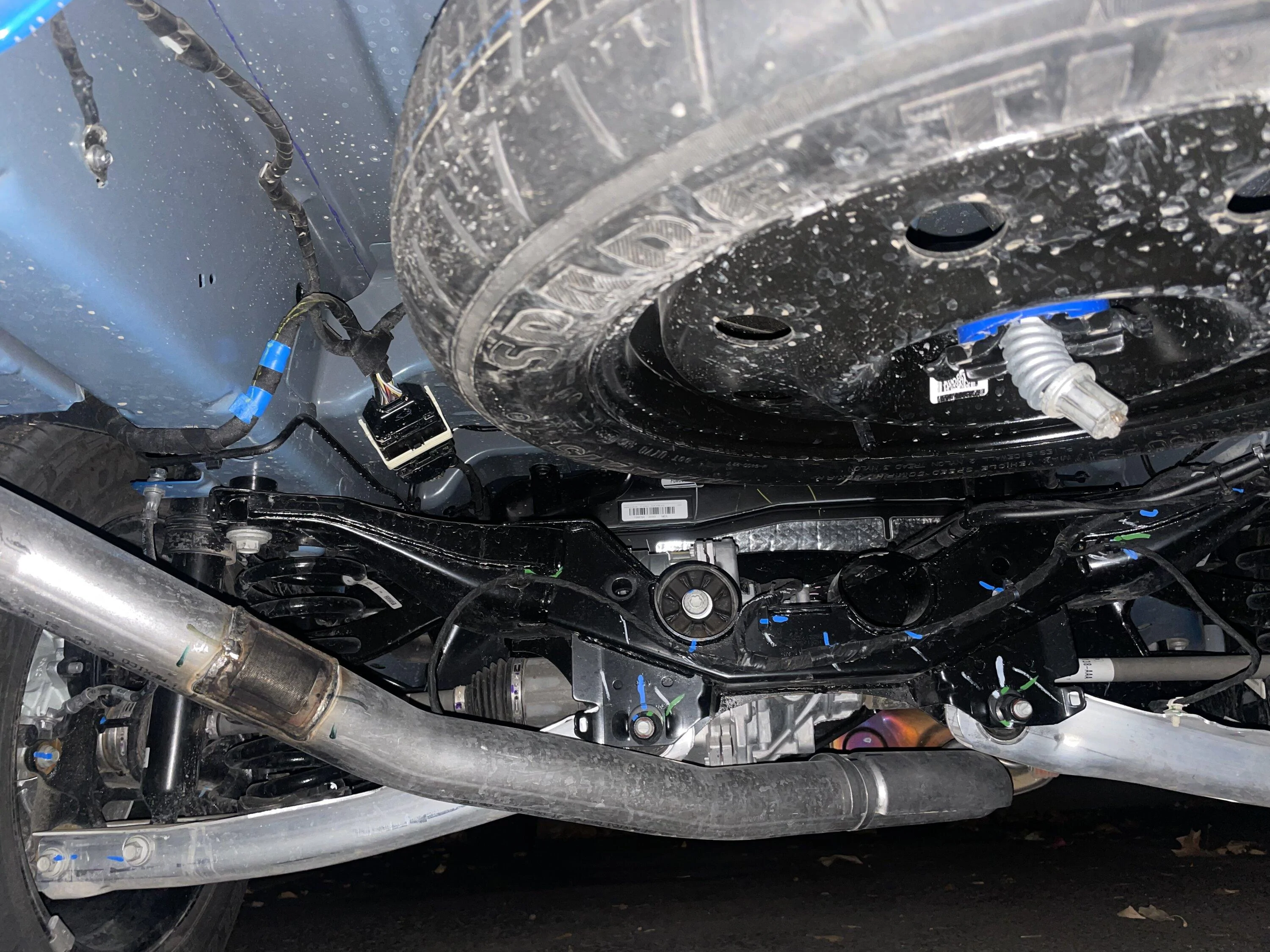

Just for comparison to earlier builds, fast forward to the 0:47 mark in the video for a shot of the older exhaust setup:
Compared to pictures I took tonight:

Somebody definitely done goofed up on the assembly line, looks more like a cut out than a patch, would definitely bring to dealers and ford’s attention though….i know for sure my EB doesn’t have something like that on the tailpipe
Mine has that too. What is it?

Yes, this is normal. On both EcoBoost and Hybrids the resonator (used to be just before the tailpipe on early builds) was deleted in favor of the resonance patch seen here. All Mavericks going forward are built this way.
You can read more about this technology here.
Very comprehensive answer!
Thanks, it's a guick read.

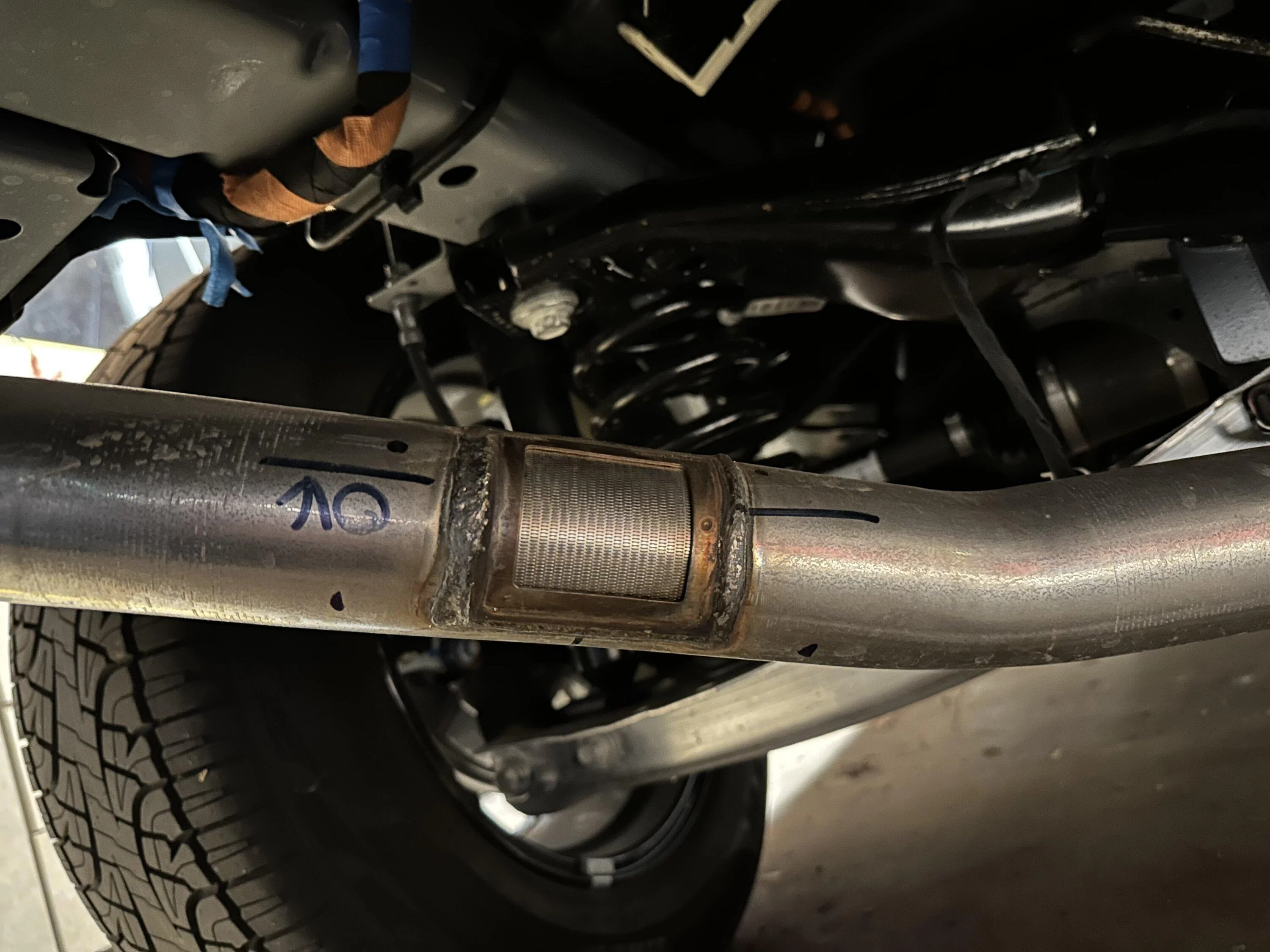

I couldn't find search results, forgive if discussed!
Looked underneath today and tailpipe has a patch (lariat manufactured 9/22)
Is this normal?
The Resonance Free Pipe (RFP) takes the place of a traditional resonator with much less weight and bulk. Some vehicle applications however still use resonators. An RFP works by venting a small amount of gas through the mesh in the pipe to break up standing waves which cause resonance in longer pipe sections. No increase in backpressure. This is used on many late model GM trucks. The larger the engine the more patches they use. So there is the answer. No drone without the back pressure of a resonator.

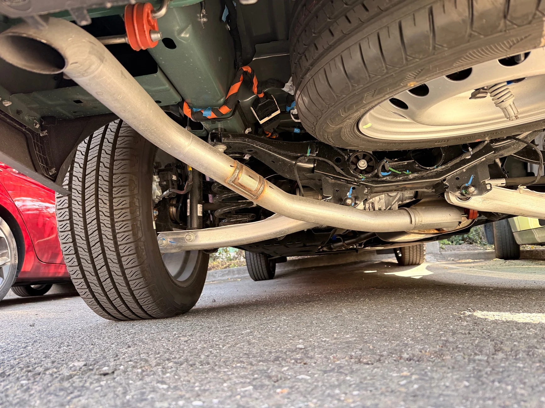

Phew. It took me a while to find this thread. Asking Google if there was a device on the exhaust pipe that was stolen. Or if there was something broken on it. I just noticed the "patch" thing on my exhaust pipe yesterday.
Good to know it's just the resonator.
