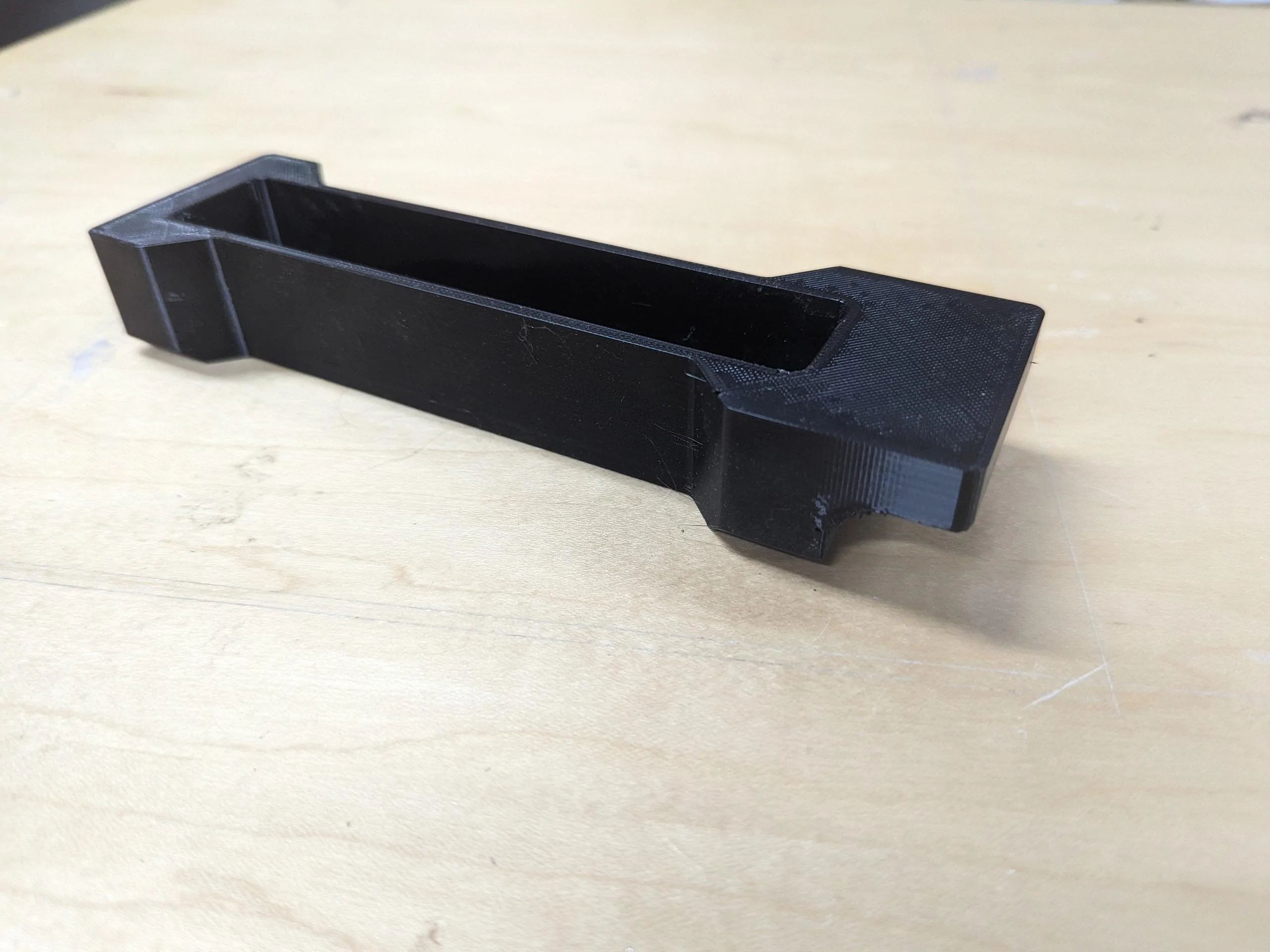

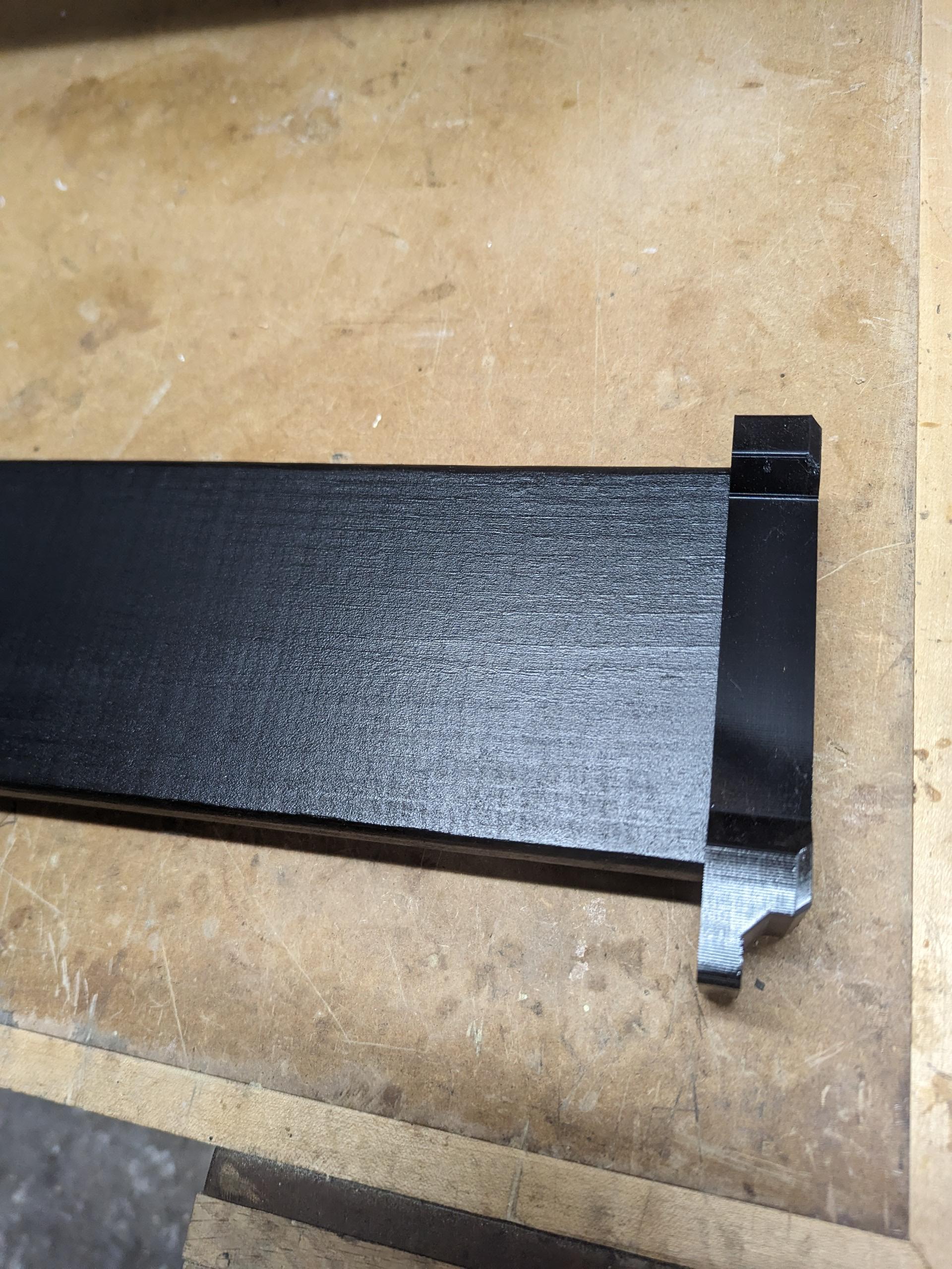

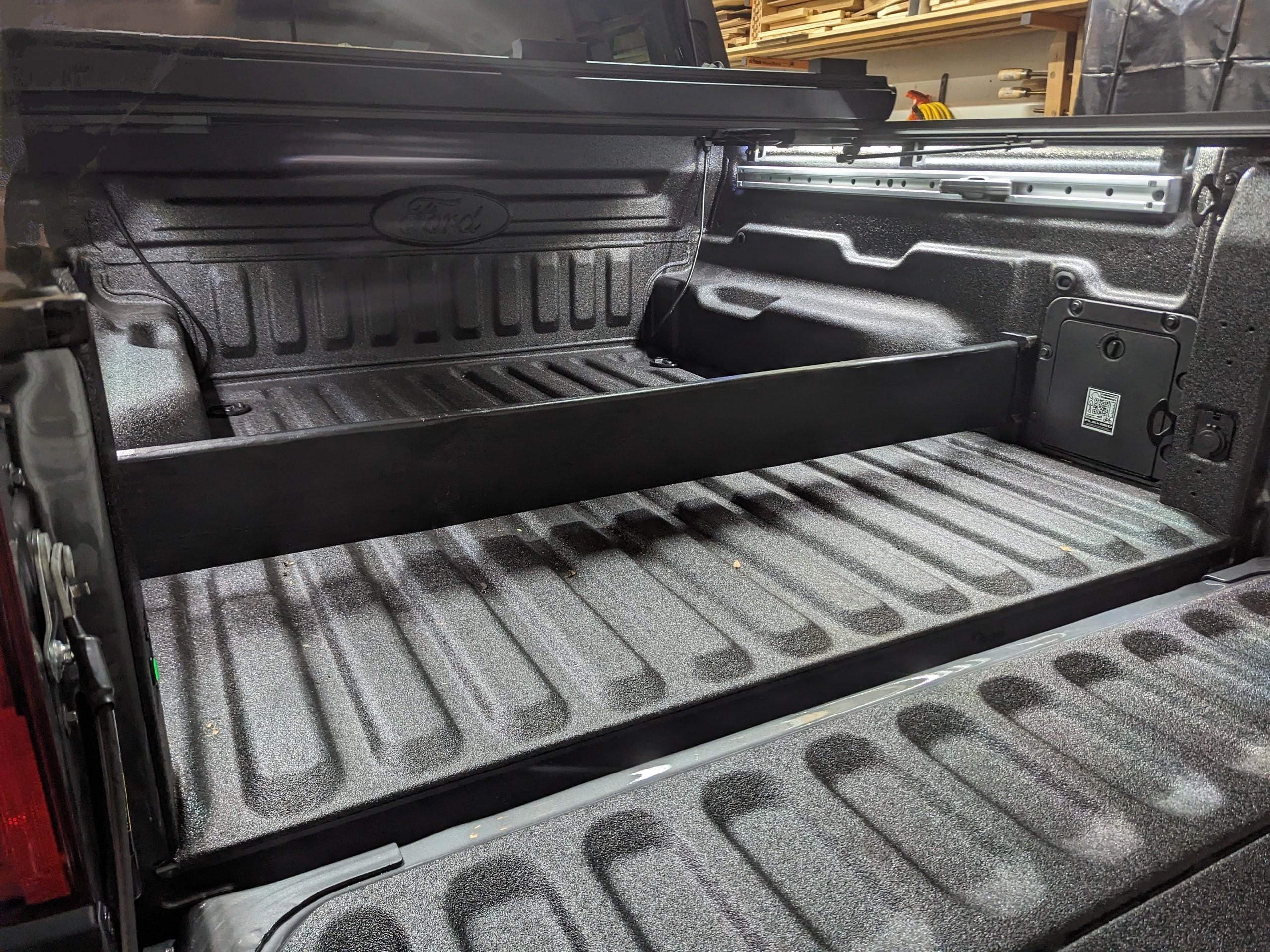

Got sick of everything sliding around in the bed so I decided to makeup a divider this weekend. I didn't like how sloppy the slots were for a 2x6 so I modeled and 3d printed some end caps and used a piece of 5/4 x 6 PT decking I had laying around, painted it black and put on the caps. It fits nice and snug and can easily be removed from one side of the bed. Would've been faster to just screw a block of wood onto the ends of the 5/4 x6 but I like the rubber-like properties of the tpu filament, plus I have to justify having this printer somehow! Print times were ridiculous though, like 5 hours each!

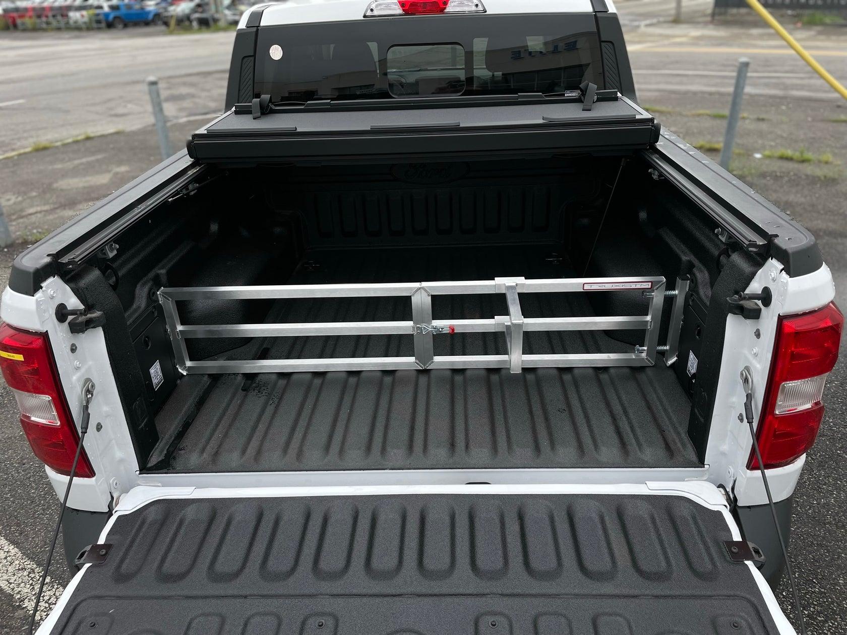

For what it’s worth, anyone looking for a really good “buy it” divider, I can recommend saving up your pennies and ordering this one.
Yes, it costs a bit. But was a perfect solution for us — we like to put our groceries back there, and the canvas grocery bags we use are a perfect fit with this divider.
It’s a cinch to take out and put in (tension mounted), is lightweight, and folds for storage or tossing in the back seat as needed.
Apologize that this goes against the spirit of the OP’s great DIY solution … but for those not so blessed with DIY abilities, and able to swing the price, this is a good solution.
Truxistm Bed Divider for Maverick

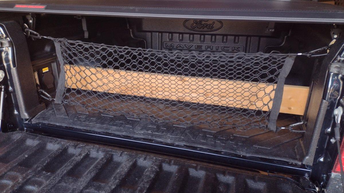

I just dropped in a 2x6. It doesn't move around and have a 2x4 that I drop on top of it if I want it taller. I do have to get in the bed to pull it out as it's a tight fit.
If you cut a couple of handle holes in the 2x6 (I used 3" hole set and jigsaw to finish ) then you can pull the 2x6 right up from the side without having to get inside the bed.
