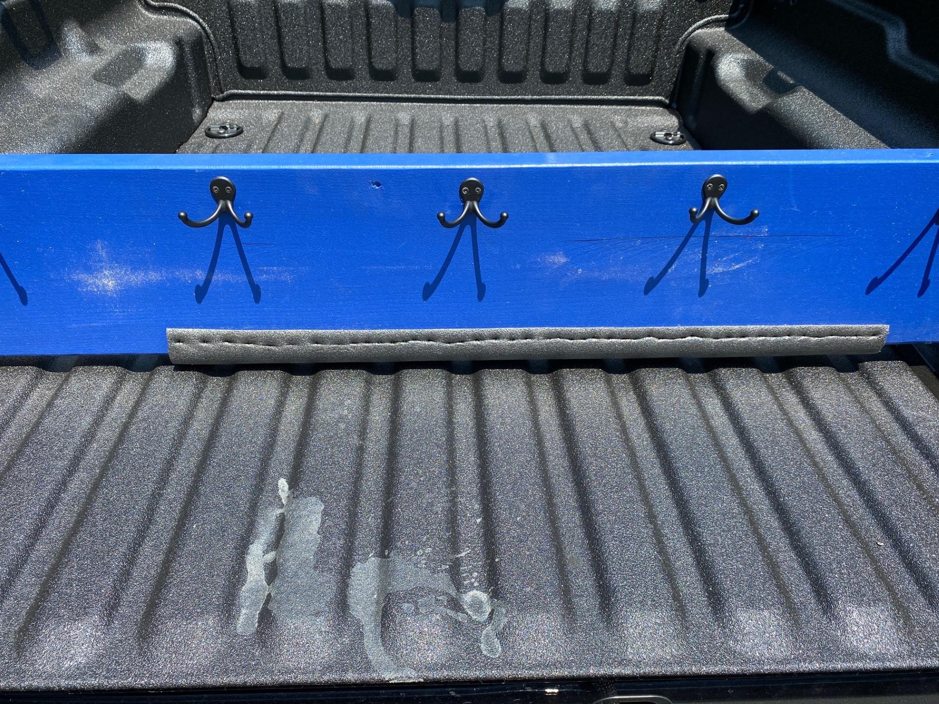

Notched 2X8 (might be 2x10) with hooks on this side and tie-down rings on the back. Used some leftover pipe insulation on the bottom and ends to eliminate rattle. Hooks double as handles to remove/insert.

Looks good, I am thinking of something similar if I find I want more height. Do the hooks work out to be high enough for grocery bags?
Nice idea on the pipe insulation.
I would move the hooks higher after having them awhile. They are adequate at best at that height.
I went out and measured. It was originally a 2x10 that I ripped down to 9”. The notches were necessary to enable the divider to rotate in/out of the channel. I would not recommend going over 9” in height.
I do find the tie down hooks on the back of the board extremely useful when hauling small items.

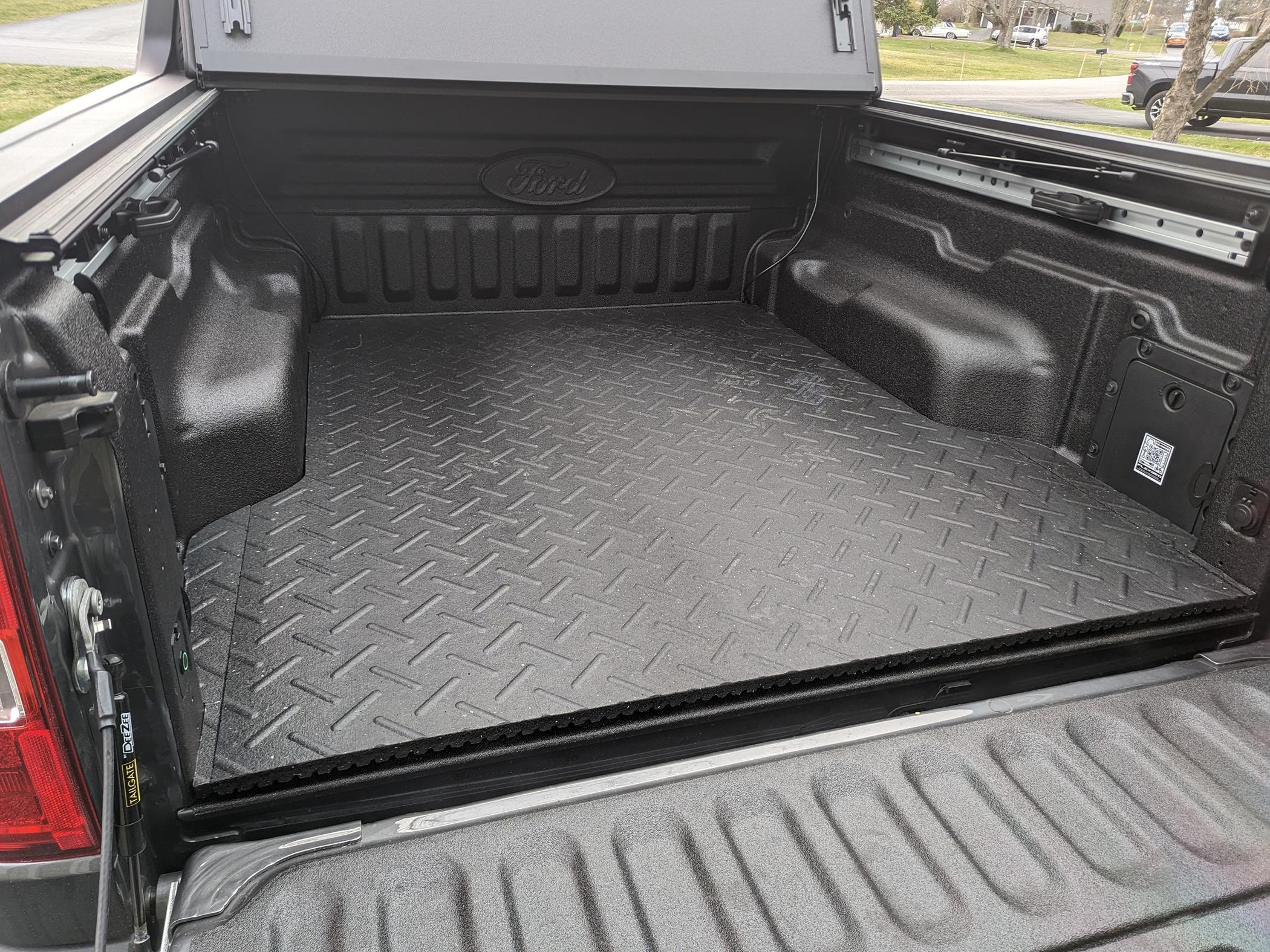

Had been debating on what to do for a bedmat to keep things from sliding around on the SIBL and decided to goo with a tractor supply horse stall mat. Heavy and smelly but should hold up to anything. I mention this because the cutoffs seem like they would be perfect to add to the ends of a bed divider for a tighter no rattle fit.
