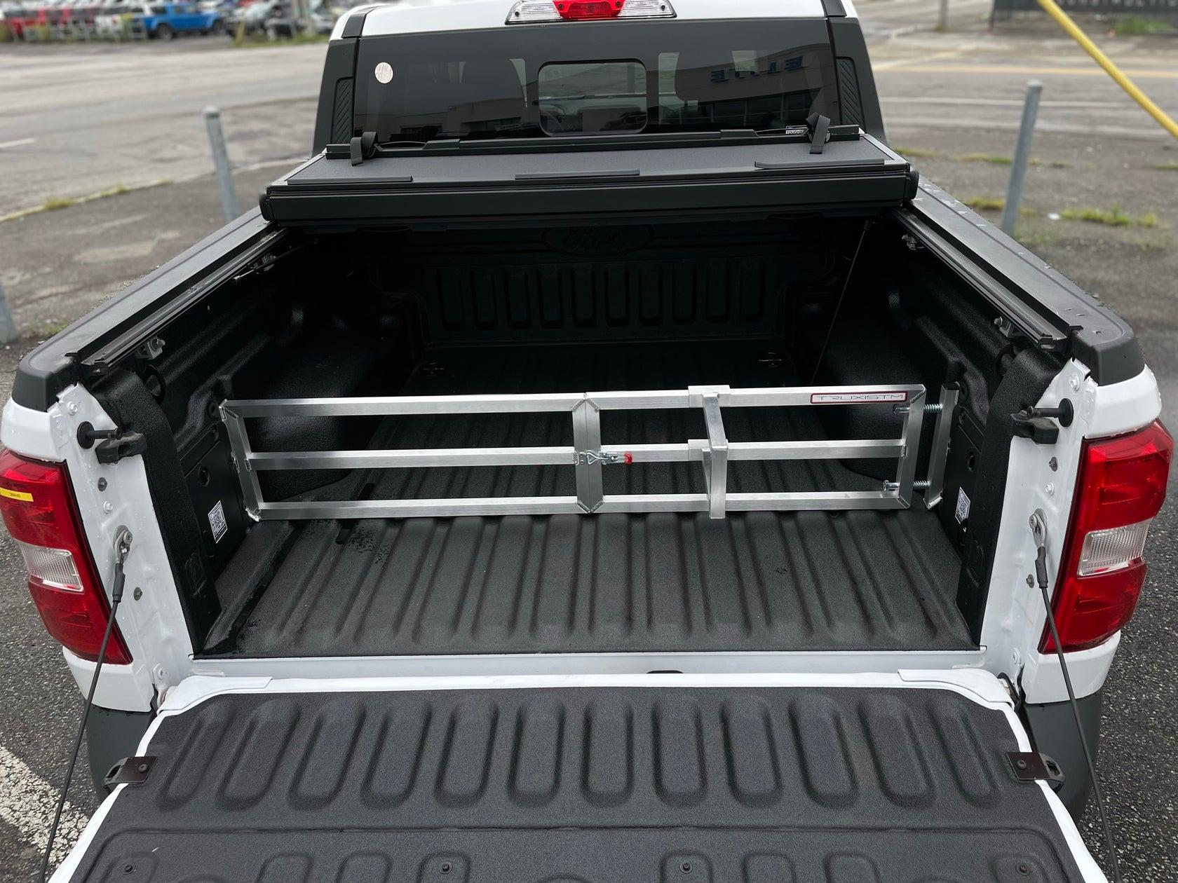

That’s a really nice divider solution. Wish I had a 3D printer …
For what it’s worth, anyone looking for a really good “buy it” divider, I can recommend saving up your pennies and ordering this one.
Yes, it costs a bit. But was a perfect solution for us — we like to put our groceries back there, and the canvas grocery bags we use are a perfect fit with this divider.
It’s a cinch to take out and put in (tension mounted), is lightweight, and folds for storage or tossing in the back seat as needed.
Apologize that this goes against the spirit of the OP’s great DIY solution … but for those not so blessed with DIY abilities, and able to swing the price, this is a good solution.
Truxistm Bed Divider for Maverick
Yikes $319 +tax/shipping. Why this looks to be the best solution, light and strong, I think I can reproduce this in wood for $20 maybe even less if I cut the board in half and use a couple KREG pocket holes. I put a 2x10 in mine and now cant get it out with the tri-fold cover rails installed.

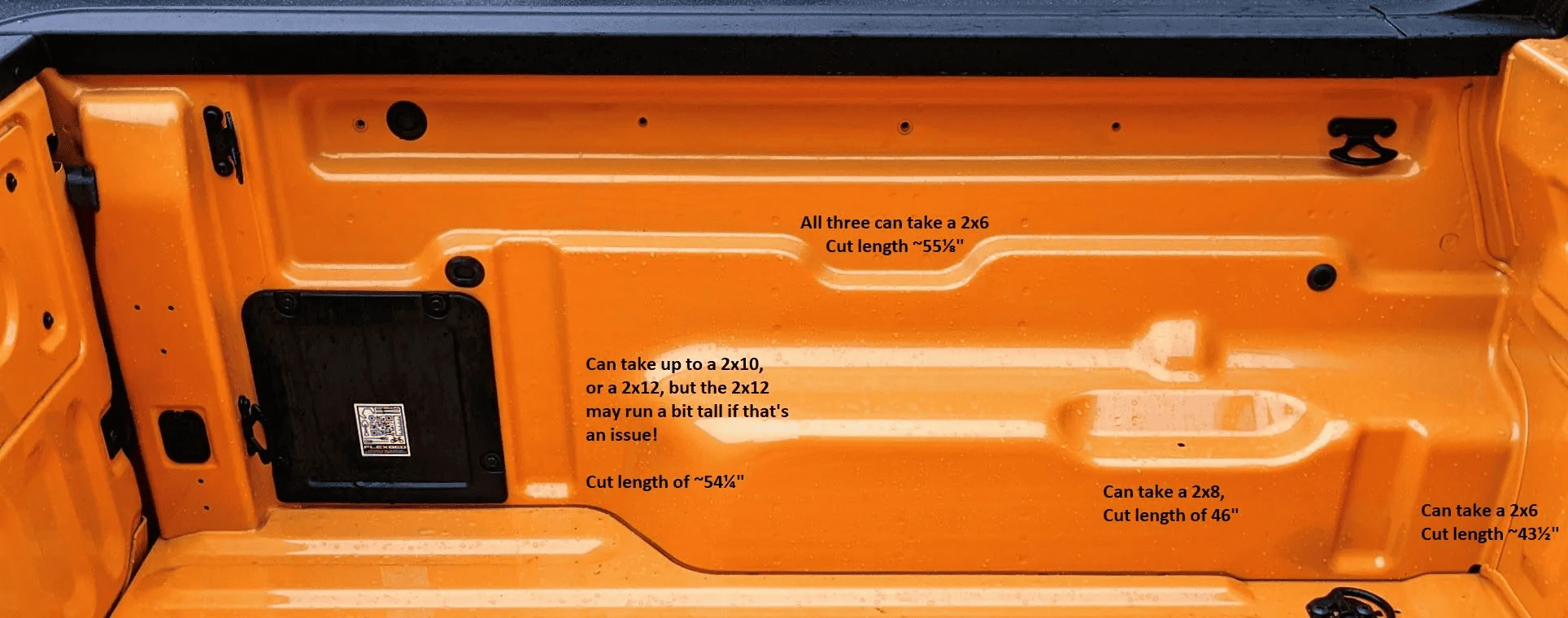

been browsing around for diy dividers, came across this guy's design and really like it, thought i'd pass it on here too. you can make it taller than a 2x4 or 2x6 and the gap gives it a nice handle or place to tie down to. reddit link
