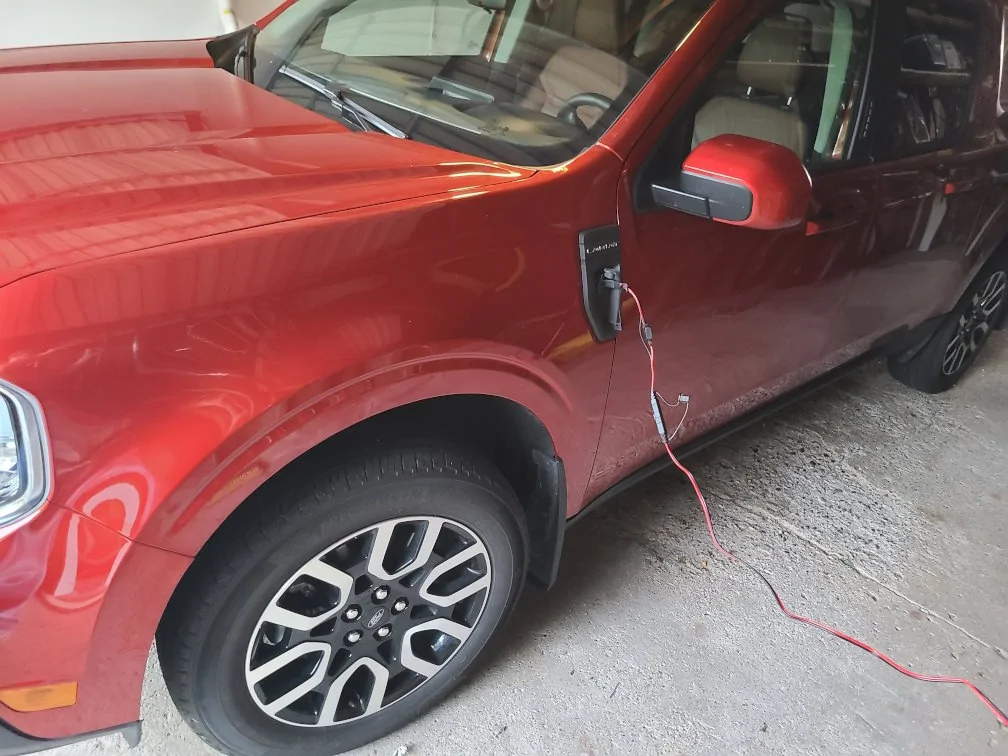

For 2 1/2 years I have been plugging my NOCO battery tender to charge the 12vdc battery when the vehicle goes into sleep mode due to not driving the Maverick for 3 or 4 days. I am retired and rarely drive more than 5 to 10 miles 2 or 3 times a week.
I finally added a quick connect to make it easier, even for my wife if she drives. Winter is coming soon in Michigan and the Maverick drains the battery even quicker. So not to start the debate, I just wanted to show others the connector bought on amazon looks factory good. Best to everyone..

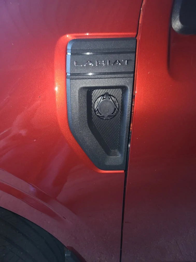

Installed mine yesterday and it looks great. On my eco this puts it close to the battery so I connected to the Battery Tender harness with no extensions.
I tried to drill the smallest hole required but did not notice the base part that will touch the side badge is bigger than the plug so I had to rout it a little bigger to get the piece to sit flush. Also the screws are tiny so you may need a smaller phillips screwdriver. If you have a tiny drill bit I would also pre-drill the holes.

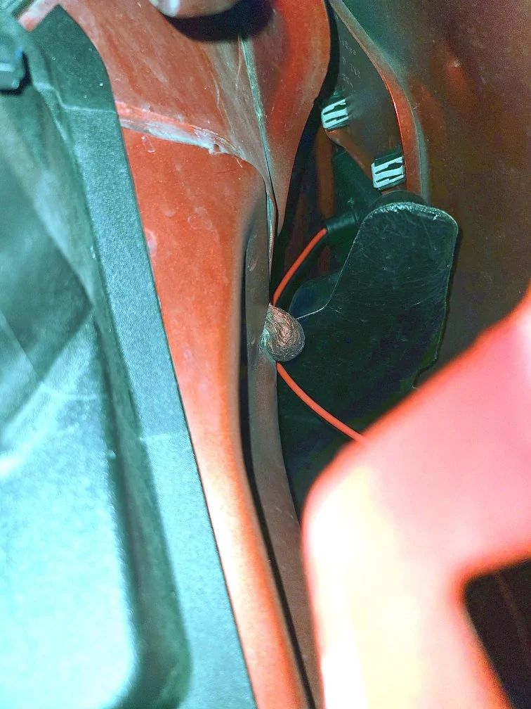

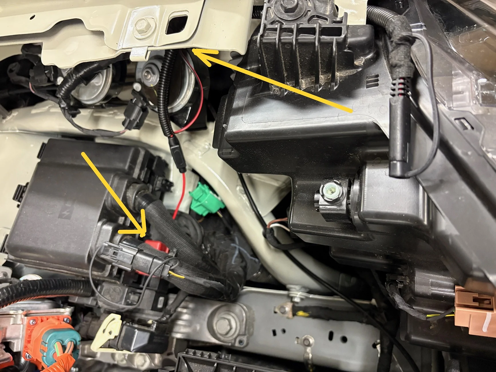

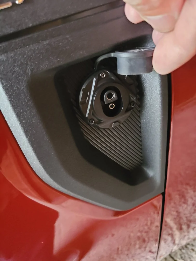

I am going to answer a number of peoples questions here and add some new photos.. The install is very easy. There is lots of room behind the side badge on the fender with very little chance of drilling hitting anything. I really like the connector I used and bought several to compare before I installed. It also has a very big waterproof cap to cover plug on the truck when on the road. see photo. Step 1 was to drill a hole using a small cone bit, then since the plug is oval I used a dremel to oval the hole for the plug to fit snug into the side badge. NOTE: as another person mentioned it is necessary to use a tiny drill bit to drill pilot holes for the tiny cheap screws that come with the plug. That's my only gripe about the plug. Step 2 was to connect the adapter cables and fit them into the hood area and then install the screws to hold the plug. Step 3 was to cut my final adapter cable and add two alligator clips positive and negative to clip onto the battery jumper post under hood. I chose to connect to the jumper post since the voltage is then regulated by the Battery Management Module. Zip tie the wires and place electric tape over positive alligator clip just in case it would get pulled off. As for my battery charger I use a NOCO genius 10 placed on a small shelf on my wall and just in case I do an old man stupid and try and drive out without unplugging, I have a small LED light plugged into the same cord adapter that is only on when my charger is plugged in..
I hope this answers many questions. It has proved very convenient for me since we only drive once or twice a week short distances in town being retired. I know others have other fixes that meet their needs that are mentioned here.

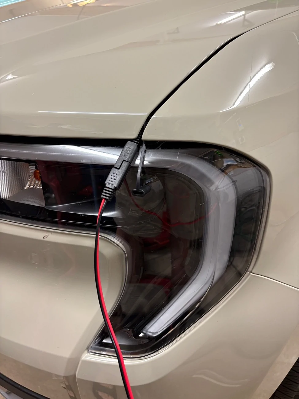

Looks great. I may try that later. For right now I went cheap and just put a quick connect under the hood. I sneak it out at the seam by the driver's headlight...
I did that too for awhile but didn't like the plug flapping around, then just opened the hood to plug charger onto battery post. Got tired and went for the look good install.

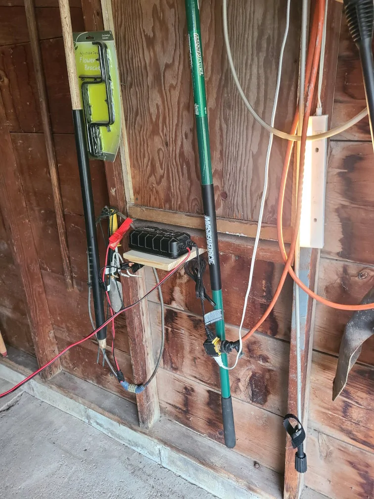

No my NOCO is mounted on a shelf in the garage, only the the extension cable from the mounted plug with alligator clips on the battery post under hood.

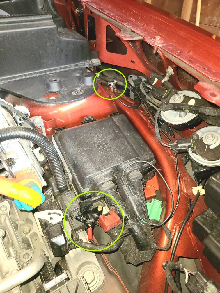

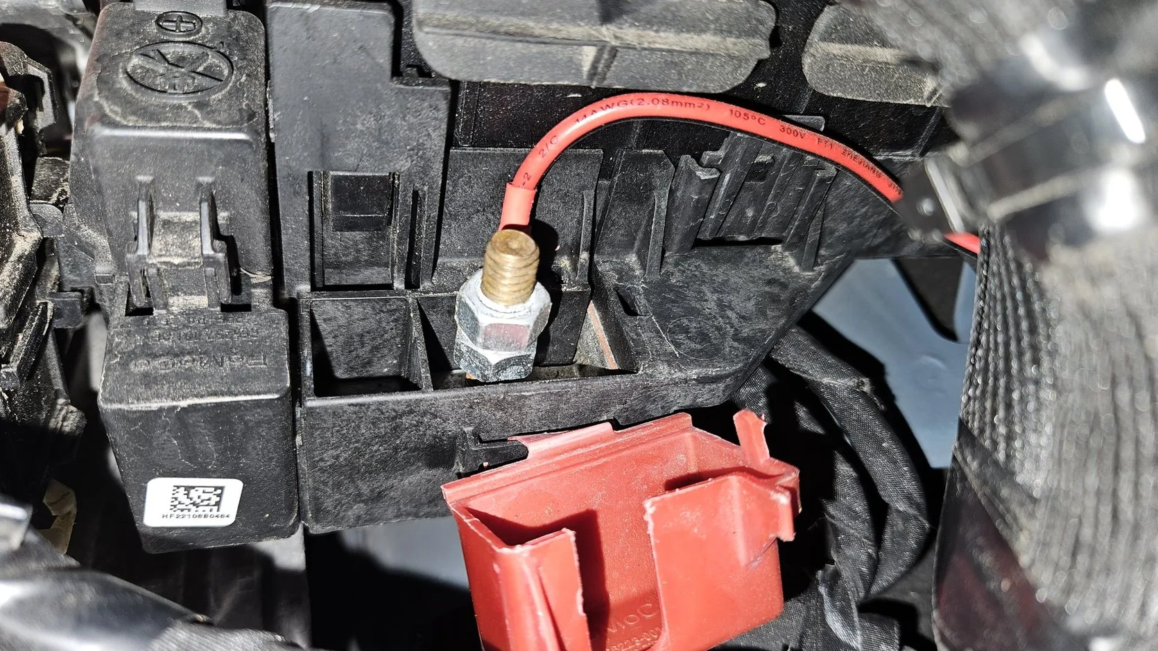

Yep I just used the 12V jumper connection and a ground by the horn. The cheap little charger wall wart came with the both clamps and quick connects with a fused lead...
How did you fasten the positive wire from charger to the positive post?, thanks
Prickly Pear
Oct 31, 2024
645
1,201
Pacific Northwest
24 Maverick XLT CG, 92 Ranger
I recently had the same question that @dmopro answered for me. Use two nuts torqued in opposite directions to make a jam nut connection. It's a clever solution and since the currents should not be too high the risk of a loose connection is probably low.
I bought two zinc plated nuts to use on mine but noticed the stud is bare copper (or copper plated something) and figured I'd use stainless hardware to avoid potential corrosion . In the pic above it looks like there might be some corrosion building up, and since those oxides are generally non-conductive if you do use zinc plated nuts you might want to put some grease on them.
