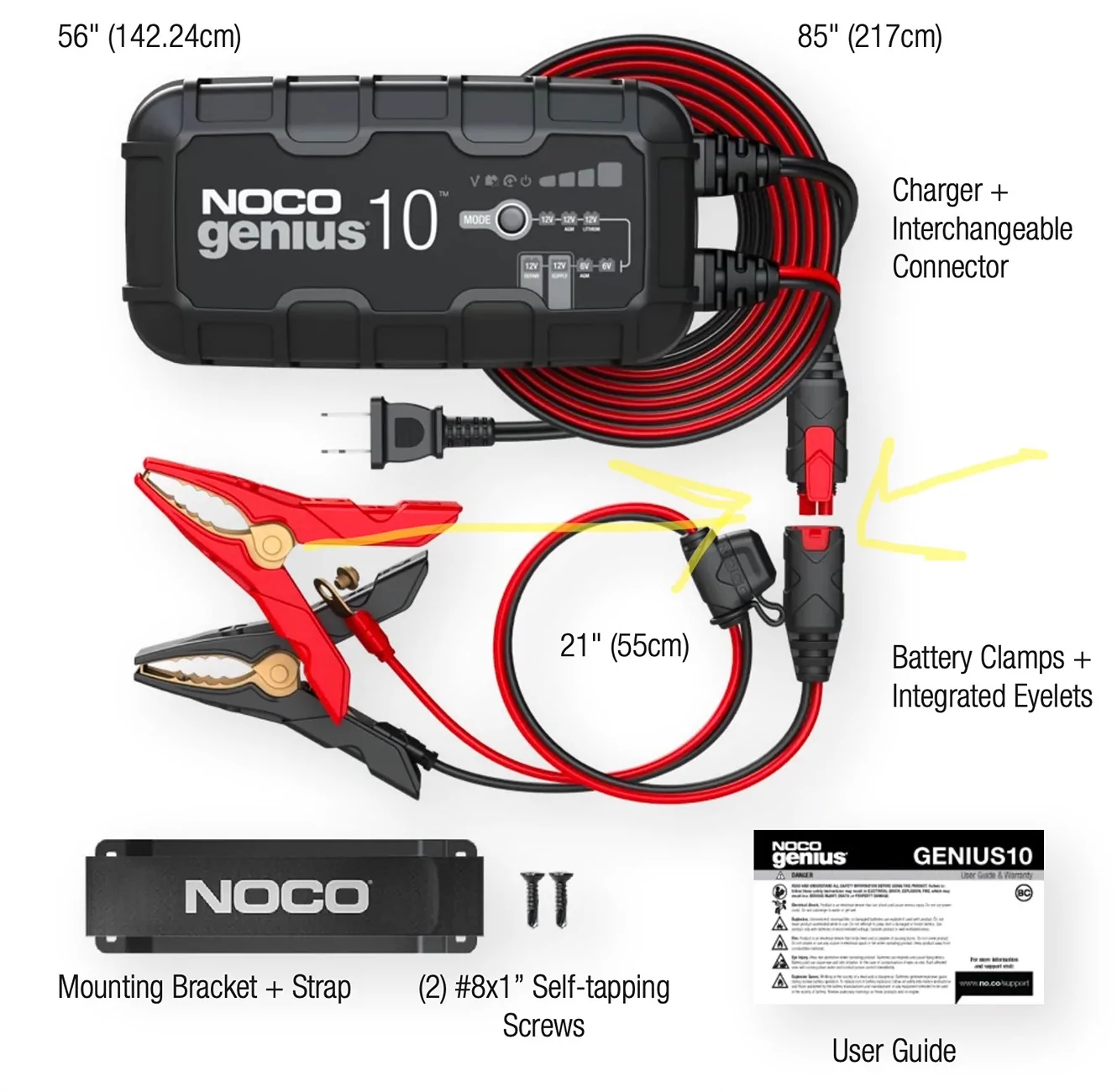

Extension cord. :’P
The part I’m confused about is I don’t see an end to his cords that looks like a regular plug. Did he splice a plug on or what. That’s my question.
It looks like the typical battery tender that we used on our motorcycles. If you are close enough to the wall outlet in your garage the battery tender itself would be long enough to plug directly into the outlet; otherwise plug the tender into an extension cord.
I would also like to see how this was hooked up under the hood just for (bad word) and grins.
That makes sense. I guess I was thinking that since he had a NOCO it was the kind he would mount inside the engine bay. At least I think I’ve seen that kind of NOCO tender.

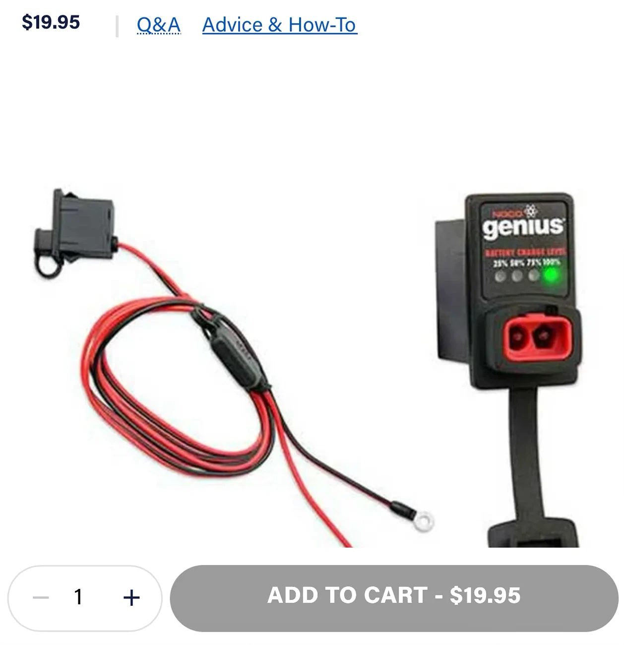

Do you have a fuse inline between this connector and the battery?
He’s unplugging the alligator clamps from his Noco and then plugging the butt connector from the Noco into the Melbree 1ft connector compatible with Noco, then the other end is going into the Mictuning socket sidewall port.

Yep I just used the 12V jumper connection and a ground by the horn. The cheap little charger wall wart came with the both clamps and quick connects with a fused lead...

So this keeps from driving around with the noco under the hood which is nice - as a prior thread showed a similar connection thru the badge, and plugging the 120V thru the badge port.
Noco also has operating temp range - I had it hit too cold last winter and not charge.
I like this better - except OP said he used clamps under hood.
I know the little noco integrated eyelets are maybe too small to actually be slid and screwed on to the pos/neg posts under hood, but that would be an improvement.

Looks fantastic. Could potentially be even less hassle with this 80” long pigtail with a Noco x-connect wall plug, skipping the step to convert it to the SAE plug.
