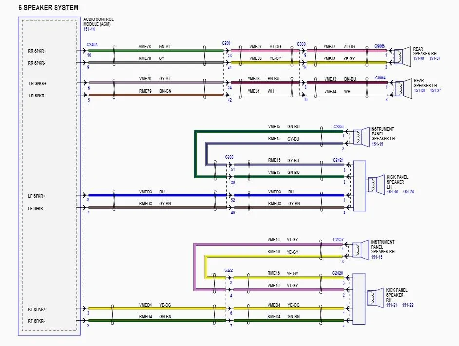

I assume you have the base, non-B&O system.
You do not want to tap into the rear speakers for your HS10. You can tap into the door speakers pretty easily. You can find discussions about the ACM wiring in this forum, and here's the diagram. If you want to use a plug & play harness adapter that will save you some time and hassle but they are pretty expensive for this purpose, you'll pay for the convenience.
For your HS10 you could also take it straight from the RF speaker, yellow/green, if you want to wire back through the door hinge boot. I don't know if I would say that would be easier than manually splicing into the output side of the ACM harness.
There are several threads here showing pics of a HS10 or similar sub mounted behind the rear bench seat. The depth at the bottomw is more than you'd think, probably 4-5". You can make a cardboard model if you want to use some new placement but I'd probably just copy what you find in another thread.
