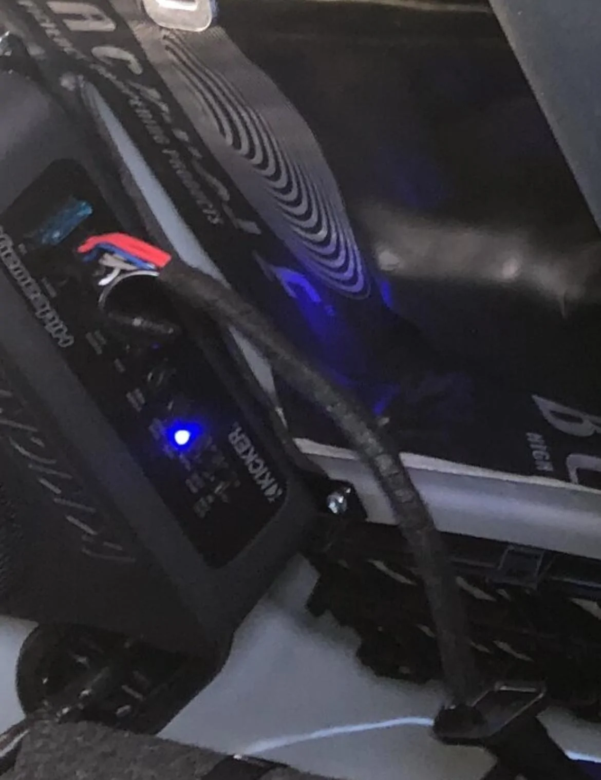

could find my other pic, but this is basically where it sits without removing that vent (this is the passenger side)
**re-thinking that the HS10 would fit…. That extra 1/4ā€ might be a killer

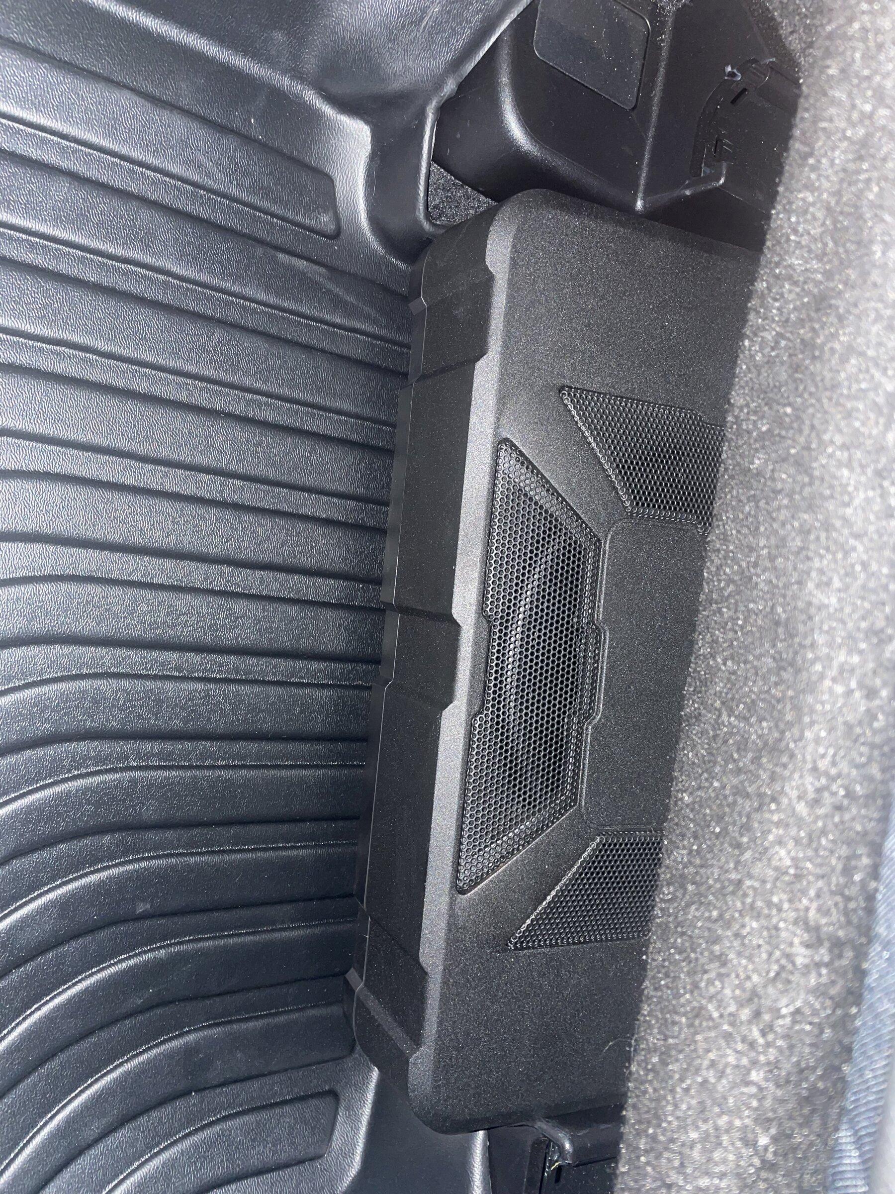

I cannot tell from the photos whether LadyMav's HS-10 is mounted to the "amp bracket" or if the bracket was removed or flattened somewhat.
I was looking closely at this last night and I see a piece of wood behind the hs10 which leads me to believe the bracket is gone
I just checked, it is not wood, it's sort of a rubberized tape.
Thanks for checking that. Not sure if you can tell, but did the installers retain the original bracket, or remove it? Also, regarding the vibration, I know you mentioned the sound deadening helped. Do you have any sub-related rattle or buzzing with that location?

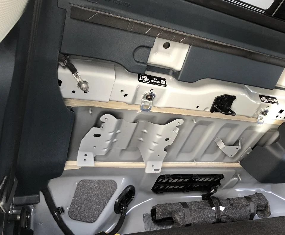

I had to go back to my before pictures to see what the original bracket looks like.
It's hard to tell because everything is covered with the black material. It doesn't look like they used the original bracket, or it may be flattened. There is no rattling or buzzing whatsoever.
Now you can see what you thought was wood, this is the before picture.

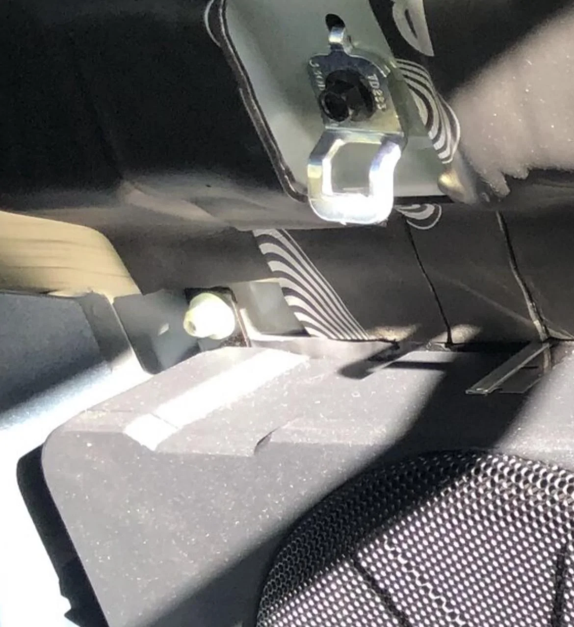

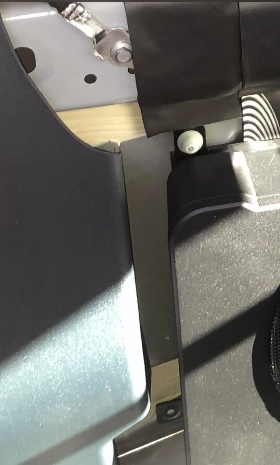

What’s dumb is I had figured that out the night before (as per the two pics below) and when I woke up the next morning I tried to validate when I was responding and that pic fooled me (cuz I didn’t look at the others
Ford Maverick Kicker Hideaway HS10 installed behind rear seats 6E9E5E58-F667-42BA-BFD6-90A2113C34E1
on this 2nd picture, can you tell what that screw is mounted to? Sorry, I’m just curious as I’m kind of an enthusiast when it comes to audio installs for the Mav šŸ˜‚)
Ford Maverick Kicker Hideaway HS10 installed behind rear seats FAC6716D-C82D-4987-B0D8-DD4FA805D6A7

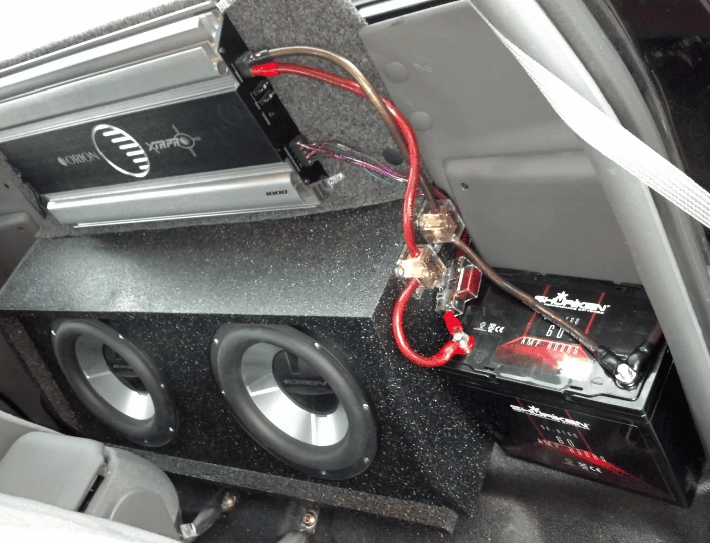

First off 1K watt amp is way over kill for the truck. Get yourself a good amp 400watt amp and it wont overheat.
I like over kill LoL this is in my 2001 single cab Ranger. My Orion amp is running at 1 ohm with 2 dual voice coil 10" only 149db at the competitions 😁
I'm old school, when I was competing, I had the original Orion Red Amps. 2 HCCA225's. One amp running at .25 ohms, the other at 1 ohms. Best amps money can buy, have many awards, and 2nd in the PRO 0-100 watt category at IASSCA. My systems were all about stealth installations.
