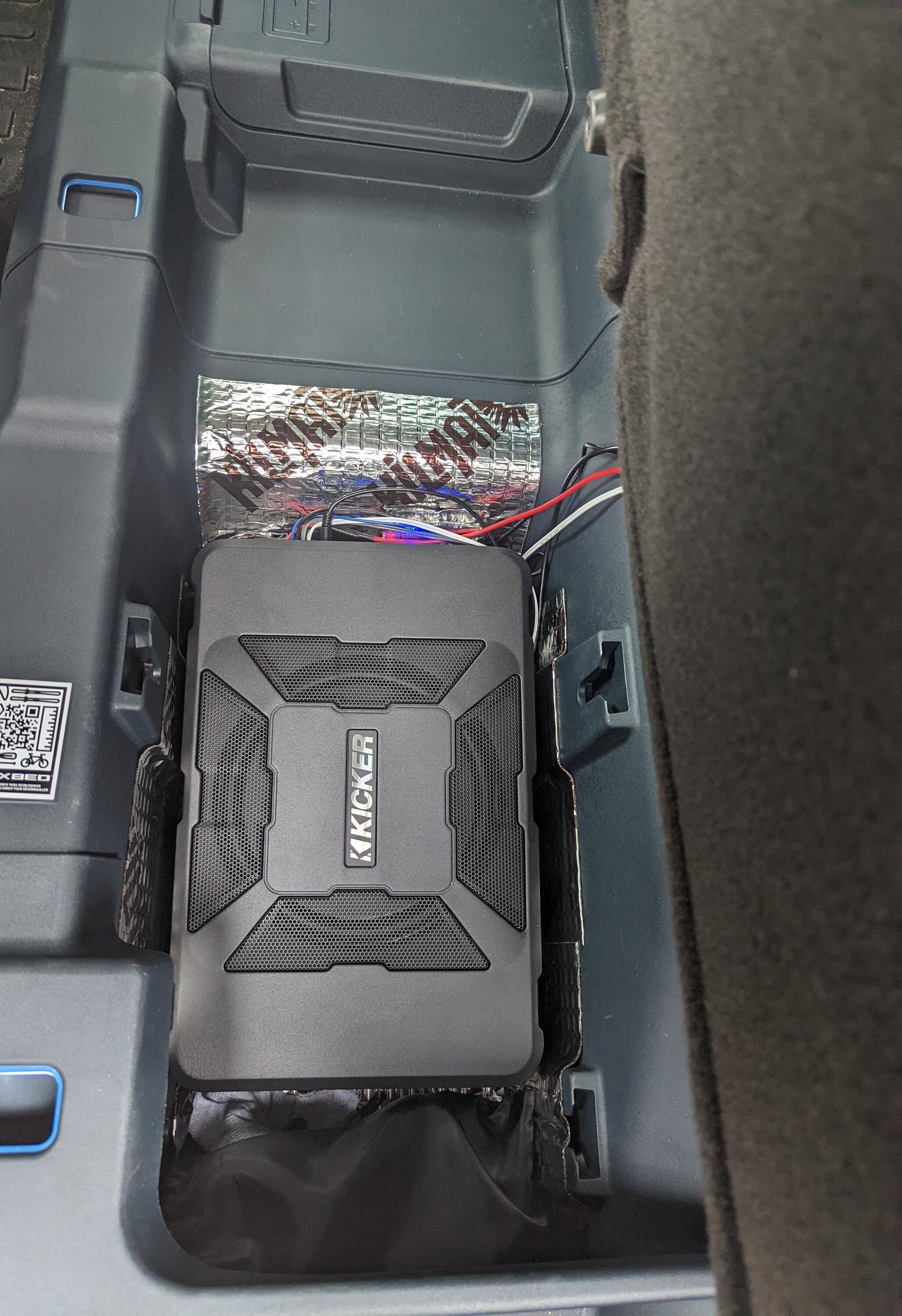

My kicker HS8 has been great!
Previously had a dual 10" box in my 2005 Sport Trac.

Thanks for the feedback! obviously a single 8 in a tiny box will not compare to dual 10s but is the bass substantial enough? My sound ordinance under seat just REALLY disappointed me and im really hesitant to go that route.

I was actually surprised by the Bass. I keep the dial on less than half and it's more than enough. I will say that I recently put one of those old MTX 10's I had in a box I bought on Amazon, in the trunk of my Mustang with a Sony Xplod(old) Amp, and it is quite a bit more bass than the Kicker.

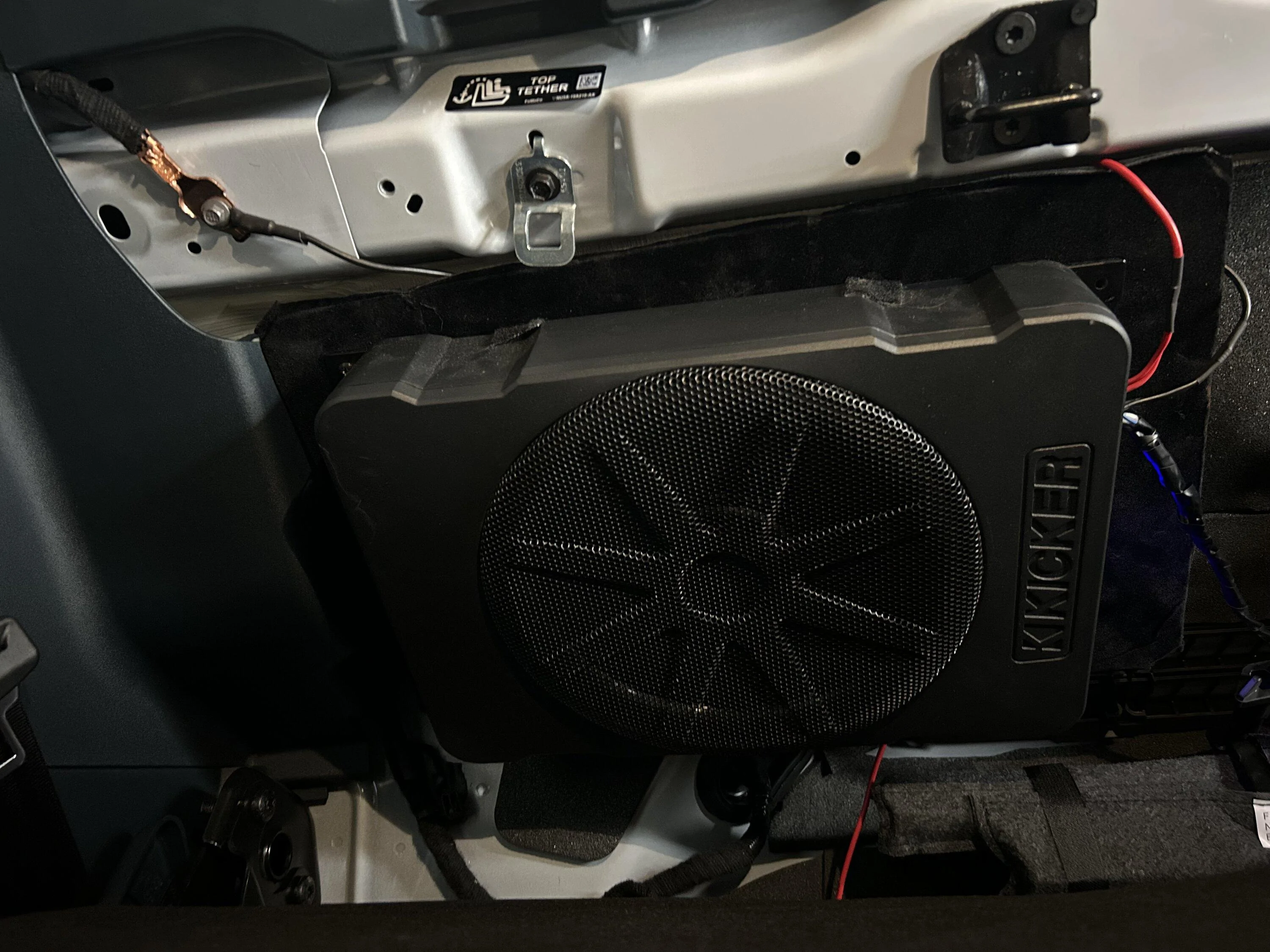

I love my hs10, I put it on the back wall and used the plug n play.com kit for wiring. I love the sound of it… but I’m not an audio snob, just like to rock out every once in awhile.
