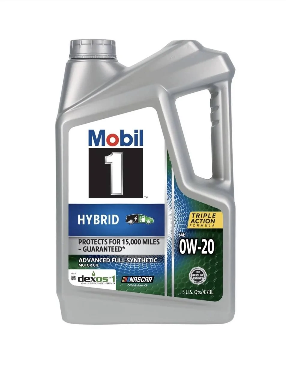

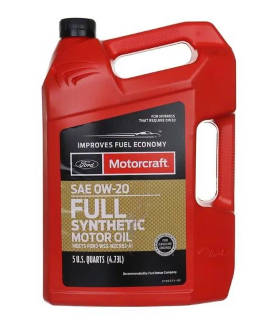

I’m quite aways from my first oil change (currently at 220 miles) and I plan to use a trusted shop that I’ve used for years verses a dealership my mechanic has advised me to use either one of these but I’m leaning more towards the Mobil 1 full synthetic at 7500 miles intervals
Dave O - YES, hybrid specific is the way to go. It has additives that take into account the hybrid ICE runs "cold". I watched my temp guage. It went down from 4 bars to 2 after I got off the freeway and ran mostly in electric mode in stop/go traffic.

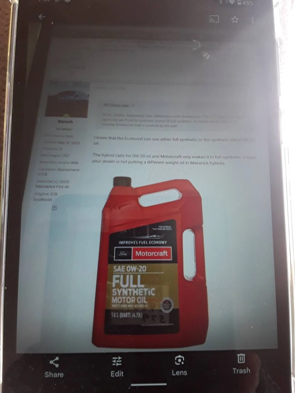

Interesting. I just looked up the oil for my 23 hybrid. According to the Ford workshop manual it is full synthetic and it quotes the Motorcraft full synthetic part number (CXO-0W20-LFS6). I also looked in the Oils reference manual and there is no mention of having a synthetic blend. Now that having been said its possible it is a new product recently released But there isnt a part number on any of the Ford systems or new release bullitins

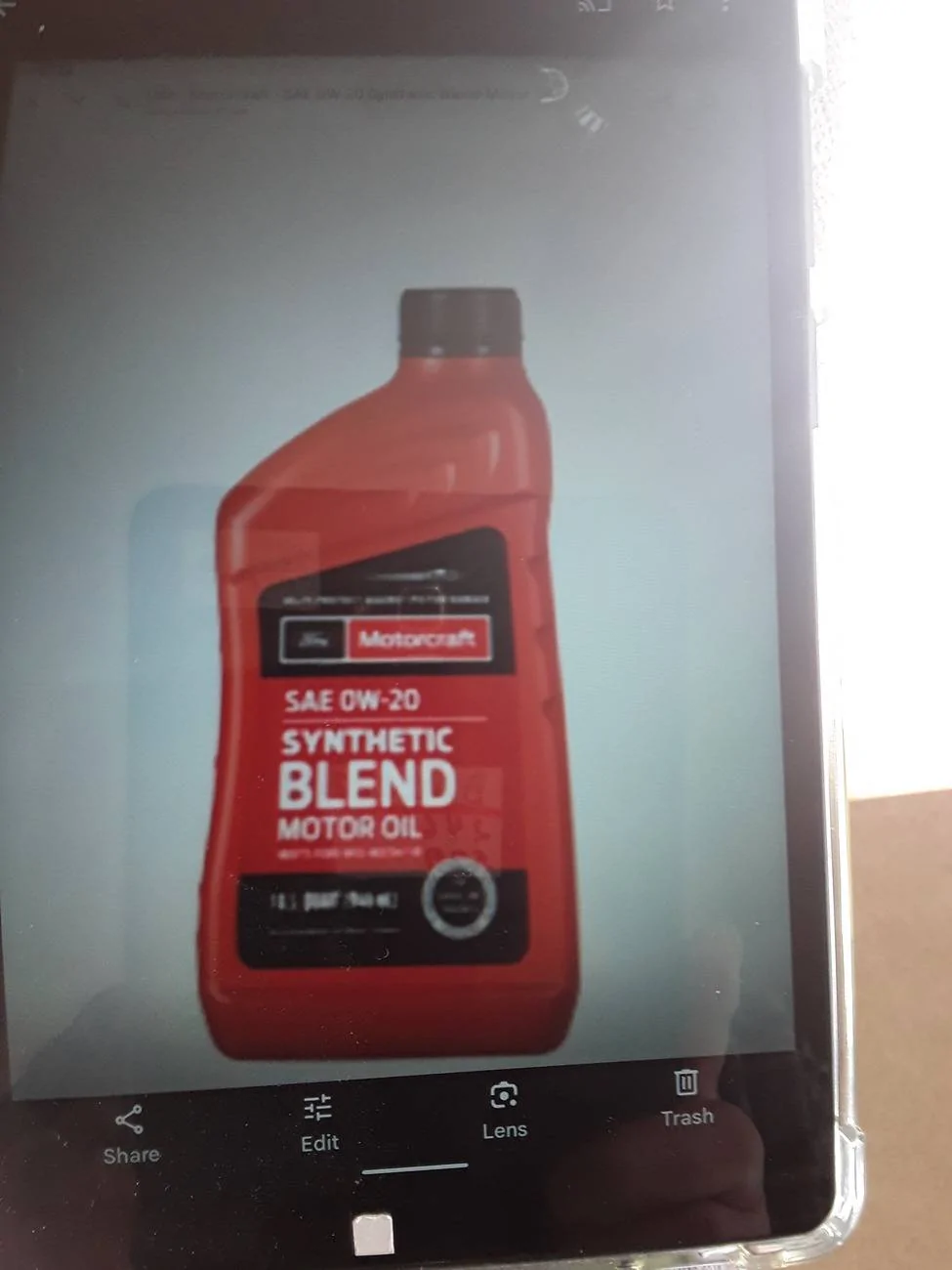

On my last XL oil change at the dealership, , the service technician listed * ow - 20 BLENDED SYNTHETIC OIL * on my report....after calling the service manager when I got home he assured me that * FULL SYNTHETIC OIL * was used....after reading a post on this forum someone posted that AII motocraft OW -20 is * FULL SYNTHETIC OIL *....this may not be accurate and I still don't know if I am using the right oil for my 2023 maverick.....
Ford/Motorcraft used to offer 0w20 synthetic blend. Currently, they only offer full synthetic 0w20.
