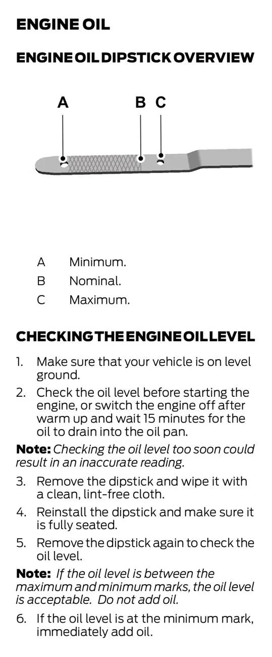

Related question: On the dipstick of my '24 hybrid, there are two holes leading one to believe the upper hole is the full mark. BUT WAIT! When I wiped the dipstick I noticed faint cross-hatch marks and a horizontal line. My question is, is the horizontal line the "full" mark or is the upper hole the "full" mark?
I did the oil change myself using Mobil-1 hybrid specific 0w-20 and a Motorcraft 910S filter. I filled the filter with oil prior to install and added 5qts of oil from the jug. The oil level on the dipstick is just below the horizontal line [above the faint cross-hatch marks] on the dipstick.
Engine sat overnight and when I did the checks, presumably all the oil had run back to the oil pan.
Thoughts?

Ford Maverick Motocraft SAE OW - 20 discussion.... IMG_7173
