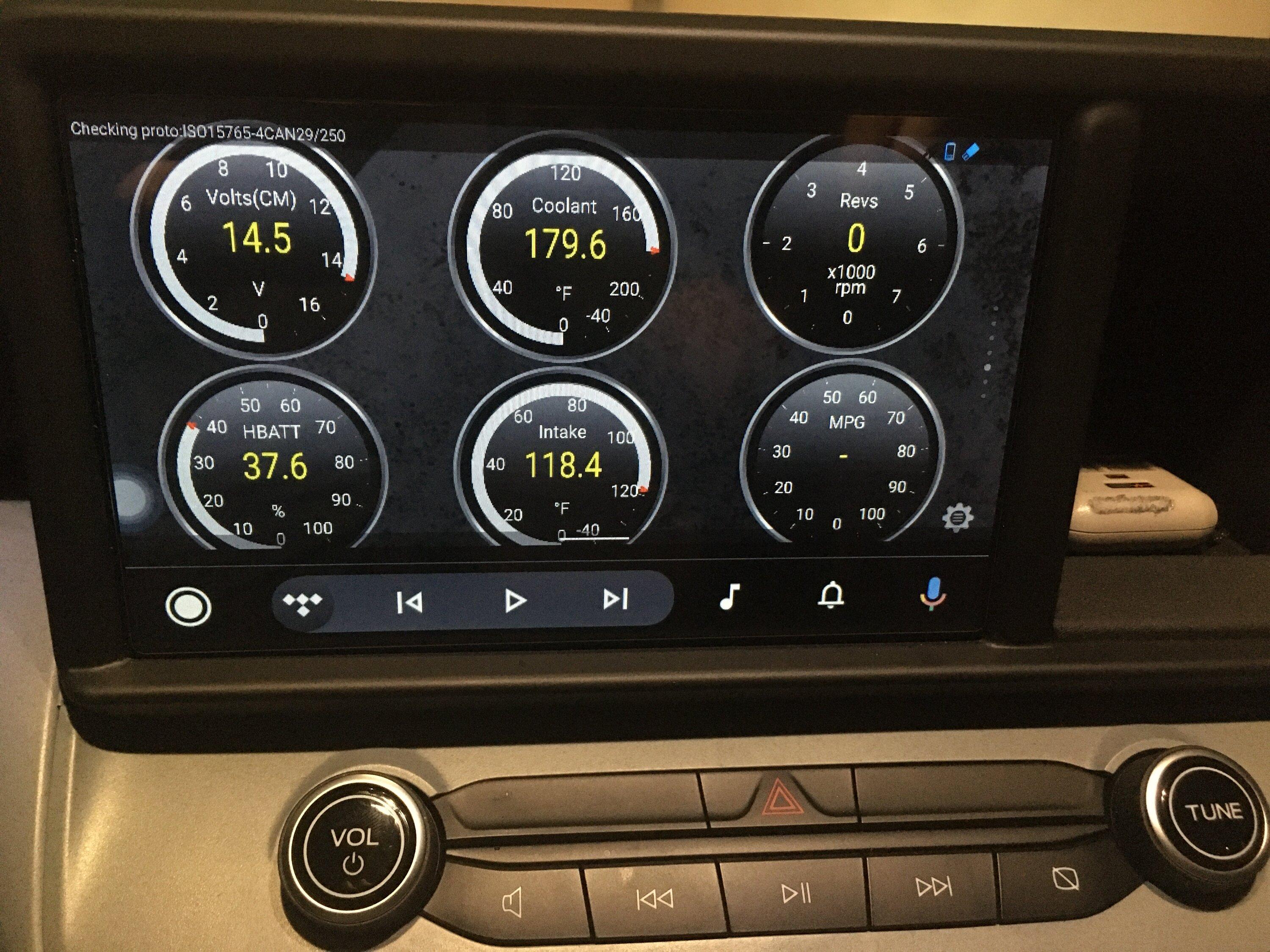

I agree that is a great way if you want to permanently view the truck data. I do not, I just want to occasionally monitor it. Which is why I use my $12 Bluetooth OBD2 plug I already had as well as the $5 Torque Pro app. Just another option.
I rarely use it, but it's handy when I want to.

I really like what Gullzway did here. I really explored that option. It's beautiful to look at and an even larger screen than SGIII.
Just you can't have maps or music data or anything else going at the same time. Plus I have never used Android in my life, didn't have any Android equipment, and really wasn't interested in learning a new operating system. That plus I wanted more or less full time monitoring. SGIII is on a magnetic mount and I take it indoors to not tempt thieves sometimes but I use it every single day.
With Android Auto, if you're using navigation it shows up on the bottom status bar as far as where to turn next. Same for music if you're using apps like Spotify/Tidal.
On Sync 3, Lariat Lux, you can also display what music is playing as well as the source on the 8-in instrument cluster, and control it with the steering wheel controls.
