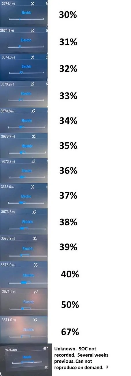

Crude and not linear.
But it is somewhat helpful.
That bottom one is 70% with 72% the maximum ever allowed and only occurs when braking on a significant downhill.
I can get that longer bar solid at a couple parking spots reliably, on 1st startup, and not so cold the ICE turns on immediately.
One parking spot proceeded by decent coast down to it, other barely above 10% power usage ICE running and full charge by the time I park.
I'm not sure I've ever enabled the scan logging because usually part of short trips I don't bother with, so not entirely sure what SOC is claimed when well beyond normal.
ETA: had one yesterday on startup ready to drive off. 64% SOC.
Despite the line being much longer than full would be.
Wondering if a glitch, though sometimes when it starts like that I can go above the 10% power and not kick on ICE.
