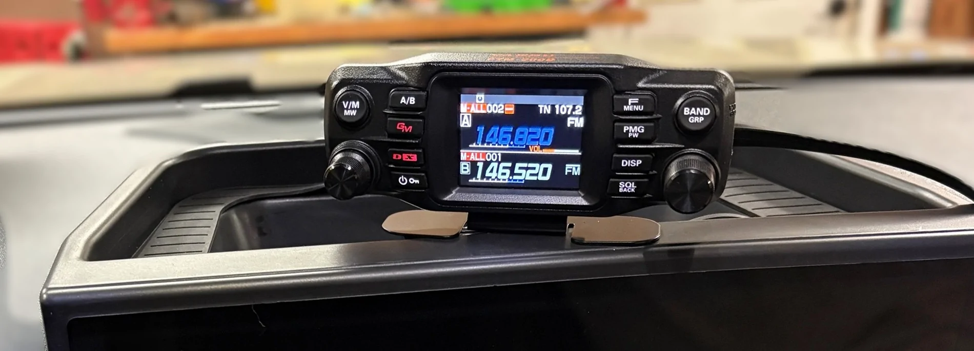

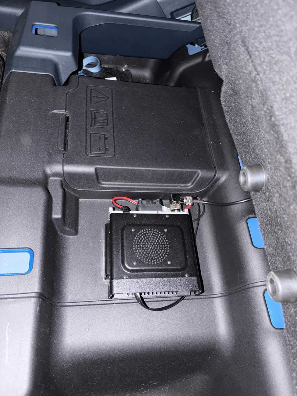

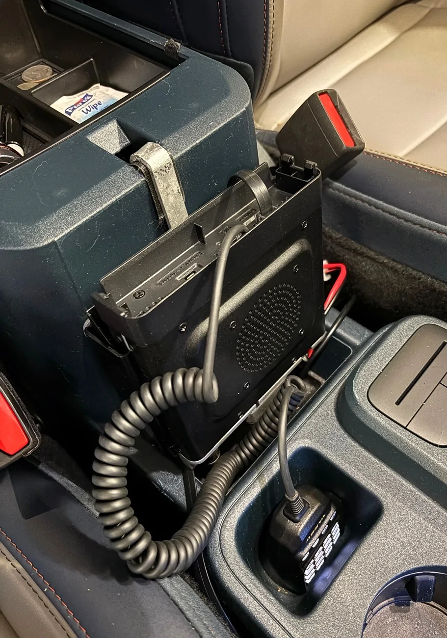

I tapped the battery under the rear seat. For a mount, I put my dual bander hanging from a bent piece of aluminum stock that hooks into the center console armrest hole. It has a remote head. I sticky-taped a magnet on a drop-in plastic tray (that fits behind and around the top of the screen) to magnetically hold the head. I can pull the whole thing out of the truck in about 10 seconds but when it's in it is very secure.

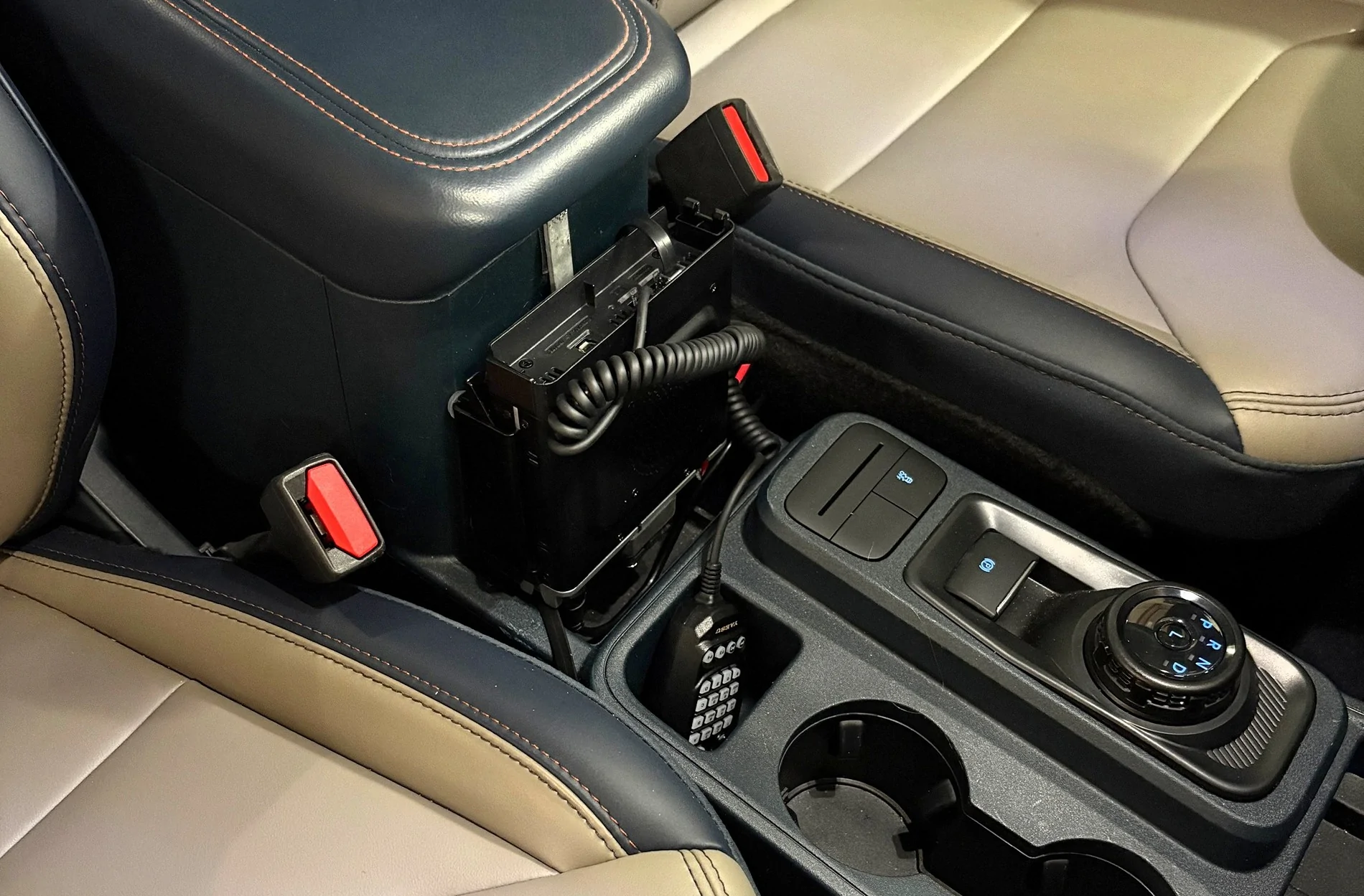

If you ever get a chance I’d like to see how that mount for the radio body mounts to the radio.

It’s the mobile mount for the radio. A small nut and bolt secured the aluminum piece

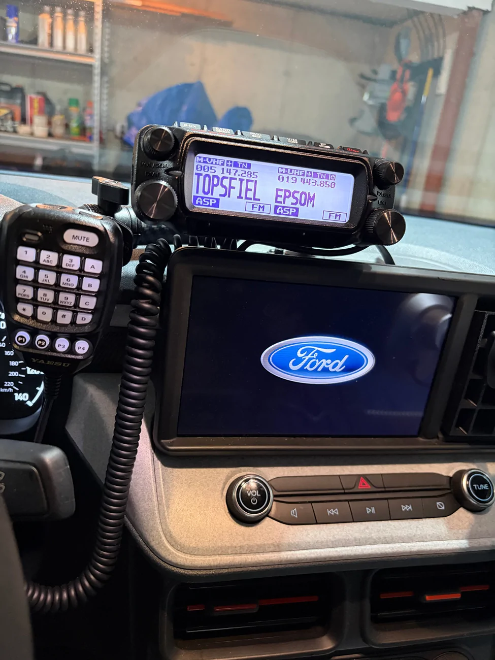

Got this Mabbett mount: https://a.co/d/02E3OR4p
The old GPS acts as my GPS for my APRS and receives the positions of others and displays them on the map. Uses ball mount - adjustable arms allow any alignment. Changed the mag mount out for a mag mount charger.
