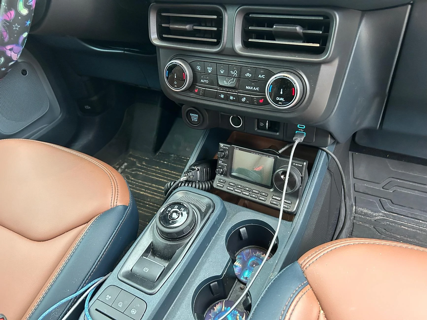

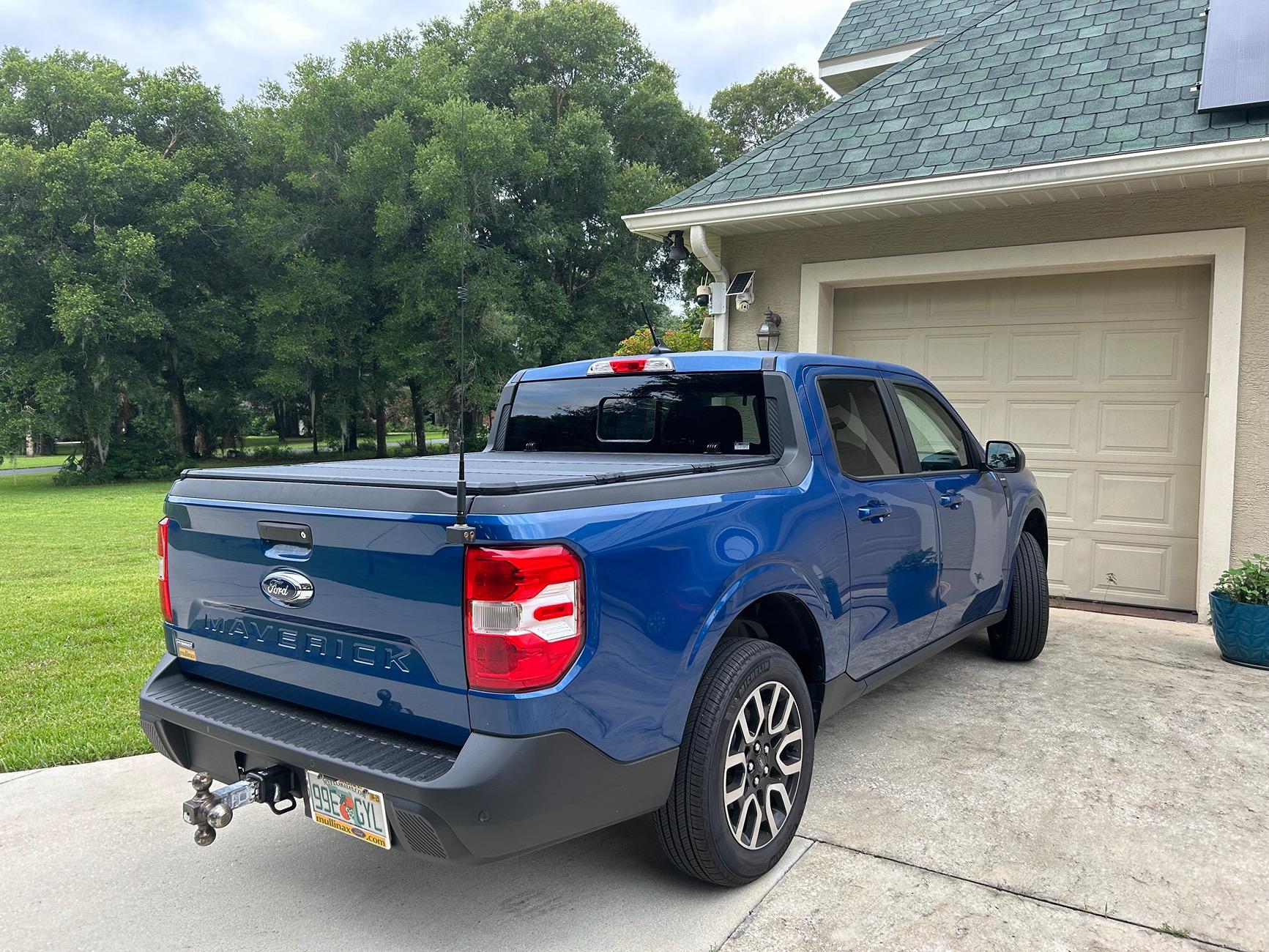

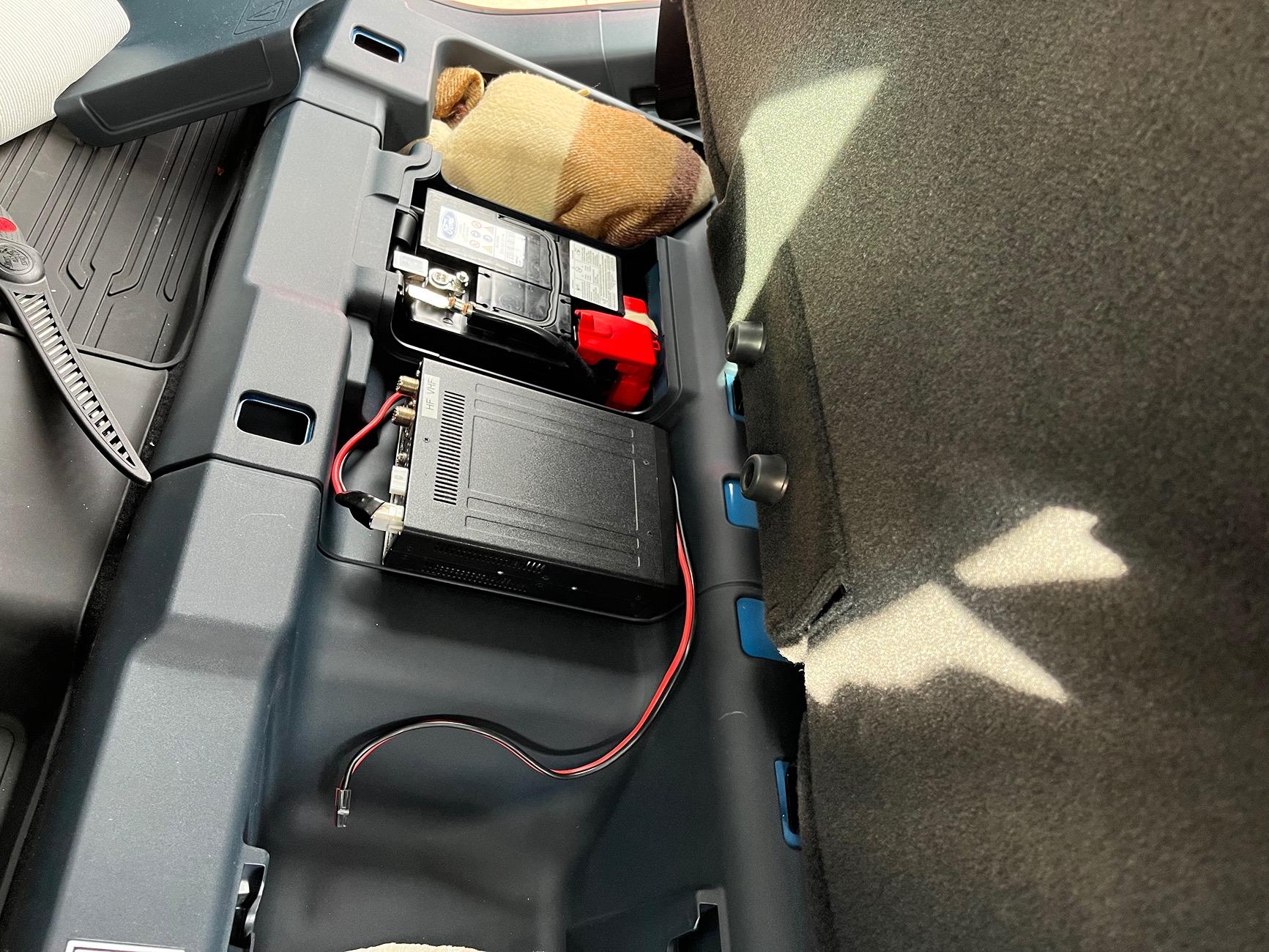

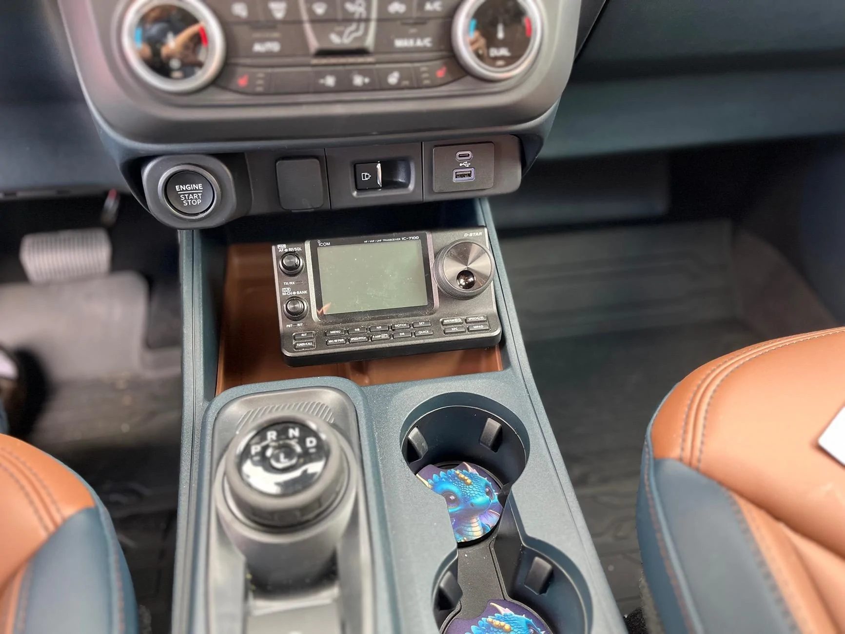

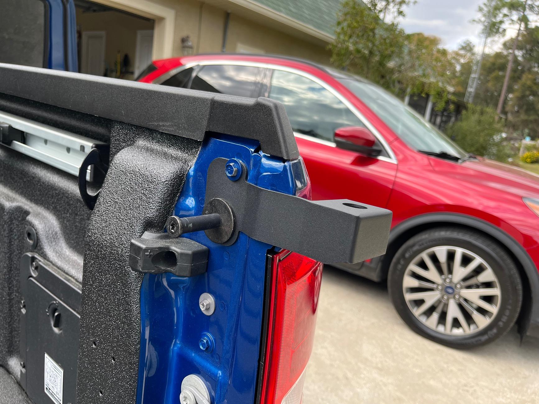

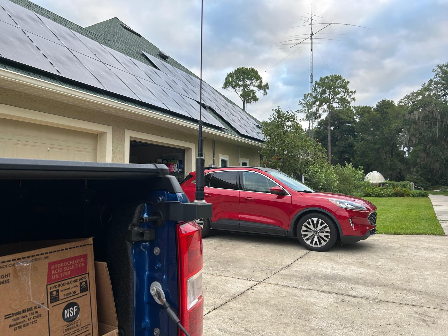

It will handle a 100 watt radio. I placed the IC-7100 under the back seat. Short power cord to the battery. Easy run of coax through the rubber plug into the rear passenger fender and out another rubber plug to the antenna mount mounted in the tailgate area. The radio has a single CAT 6 cable to the front under the dash. I made a simple clip-on for the tray and used camera mount hardware to mount the control head. Simple, no holes to drill. Almost plug and play and I have all modes plus DSTAR 160 through 440. I will attach a set of picture that ought to be self-explanatory. I will add another mount to the driver's side for a screwdriver antenna. I am also considering a mounting point at the third light above the bed of the truck. They make some very nice third light mounting brackets and the third light mount would be far better than the tailgate mounting point.
Any questions let me know. Terry - W6LMJ/N4OLT/A

Thanks for posting those pictures but where is the coax running to that passenger side mount? I have the mount and RG316 coax but not sure where it runs from the tailgate to the console.

Great setup. Do you have a link for the rear antenna bracket ? I've seem similar things on Amazon - but folks said what was being sold did not fit.
Thank You

You've probably read about all the things you can do now including installing your radio on a Hybrid. Please also get yourself an AGM battery. The Maverick charging system is setup to charge AGM batteries and will sulfate your flooded battery within a few weeks with a Ham radio set up. Just my two cents.

Can you give more detail on how you ran the coax? I see some rubber plugs but I don't see an easy way to route the coax from the cab to the tailgate. Appreciate any insight you might share. '73 Rick Nz2I

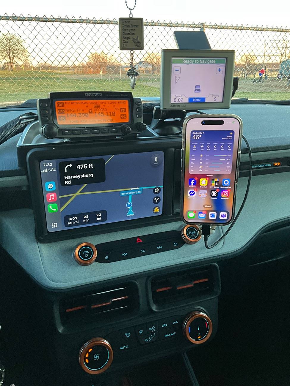

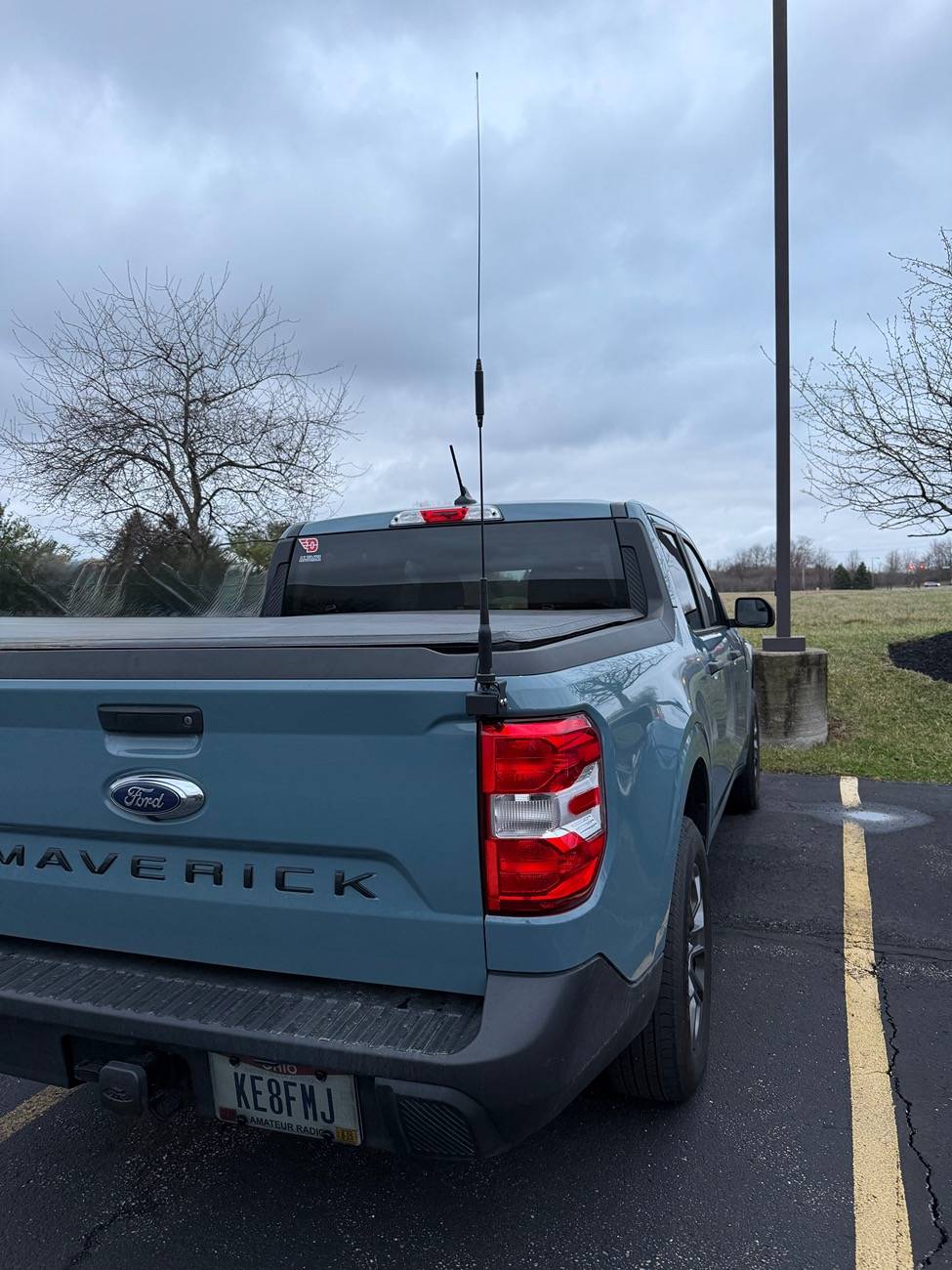

Hi! I just completed mine. I love how it turned out!
