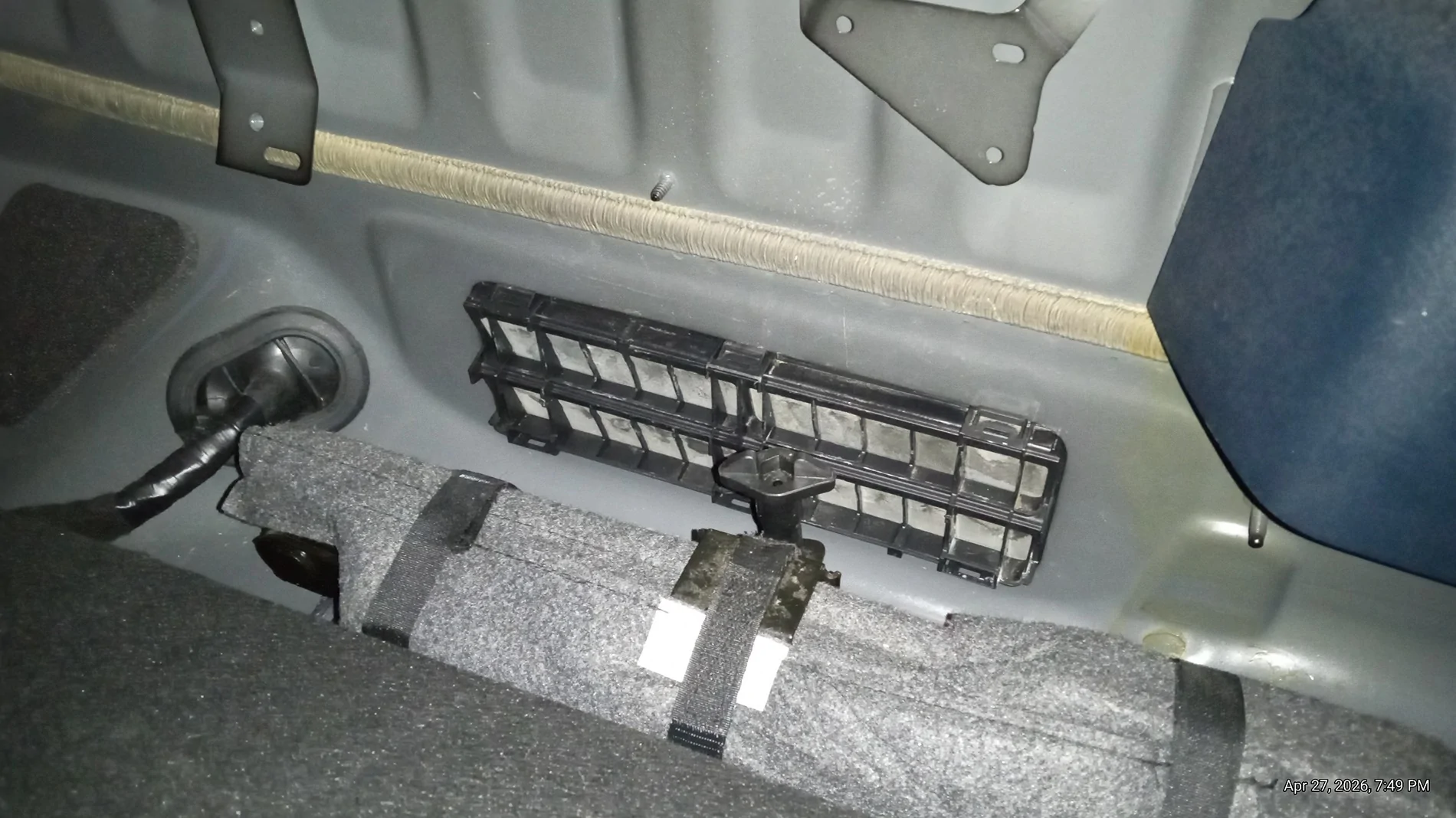

While I stored my maverick in the garage over the winter the little critters got in my Maverick. An awful smell was emanating from the vent behind the back seat and I had to sniff it out. I believe the mice got in under the vehicle. The vent itself can't be taken out inside the cab but can be pushed in and would result in losing the whole vent assembly unless your willing to do hours of work removing Shields under the vehicle to get to the vent assembly. Had to flush some odor band in there and flush the smell out with a garden hose.
Ford Maverick Mice in my Air Box cab vent

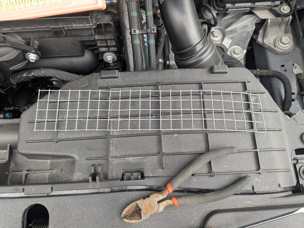

So I cut a piece of 1/4" hardware cloth (weird name for what it is) and just let the filter hold it in place against the opening. Good idea but not sure it'll work since they say a mouse can get its body through any hole its head can go through. We'll see. I'll keep an eye on it.
Certainly shouldn't obstruct airflow in any way.
Is that 1/4" ? Looks larger. Like 1/2"...
Anyway, a mouse gets into small areas because it can flatten itself down and scooch through a 1/4" gap. It can't fit through a 1/4" square.
There is always 1/8". It's harder to find as most want the more ridged welded version but woven is more flexible (like cloth).
