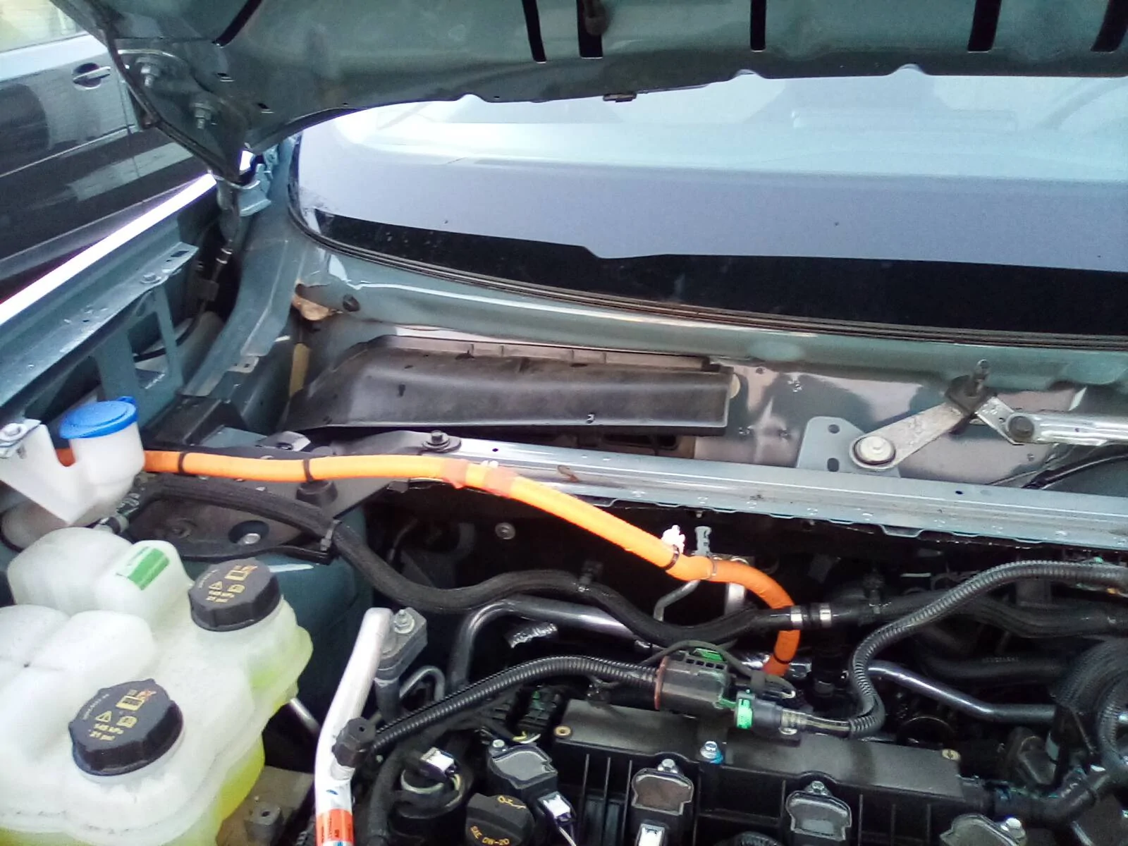

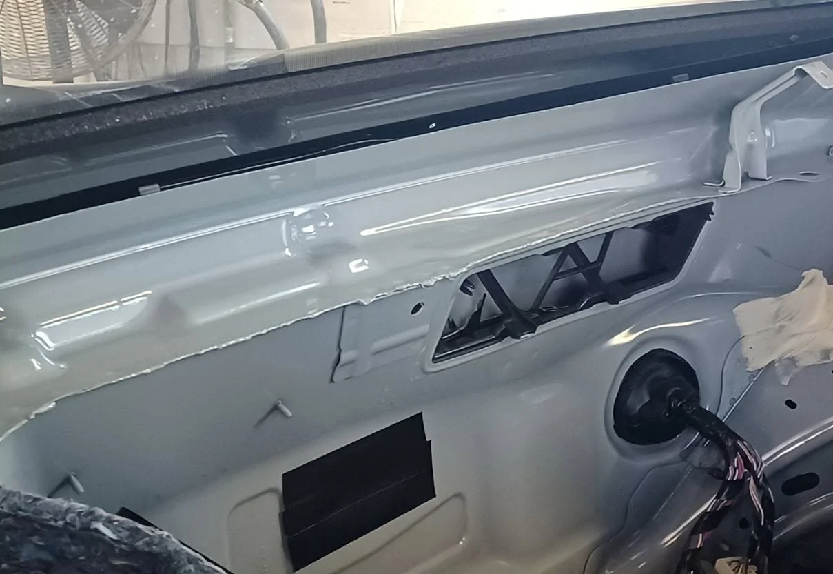

Rear cabin vent looks easy for rodents to get in. Not sure about fresh air intake below the cowl.
Cabin Vent - https://www.mavericktruckclub.com/forum/threads/mice-rodent-entry-point-behind-rear-seat.23845/
Air Intake below drip shield passenger side:

Thanks for the pictures. They are very helpful. I checked and my rear vent it is intact with no signs that a mouse has been messing with it. The cabin air vent was clean and no signs of mice activity. I have a trap set up inside the cab (I caught one there yesterday). I also sprayed the front wheel wells and engine compartment with eucalyptus oil. But that didn't have any effect. I found the beginnings of a nest on top of my battery this morning. Guess I'll put traps in the engine bay.

What am I looking at in the third picture. The first one shows exactly how my rear air vent looks. The second is obviously under the hood. Where do I look to find where the third one was taken?
That's below the removed plastic cowl at front windshield passenger side.
I was looking at mine and don't see an obvious way a mouse gets there unless they can squeeze in behind felt in engine compartment that is below that.

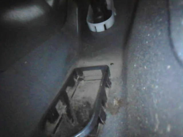

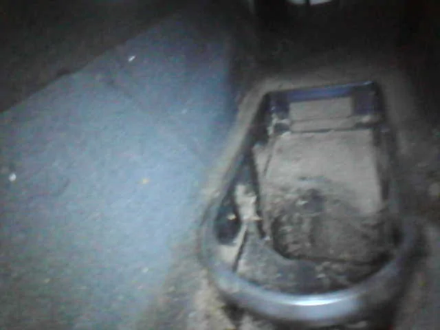

Pulled my cabin air filter & stuck in borescope past the recirculate valve that was open.
Looking toward center of truck saw a harness grommet and another black one.
Ford Maverick How to keep the mice at bay? Fresh Air Intake - From Air Filter Housing to LH - Cowl Panel Drain Valve - IMG_2244
Ford Maverick How to keep the mice at bay? Fresh Air Intake - From Air Filter Housing to LH - Cowl Panel Drain Valve - IMG_2245

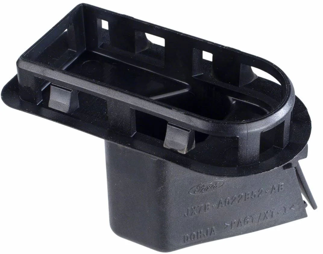

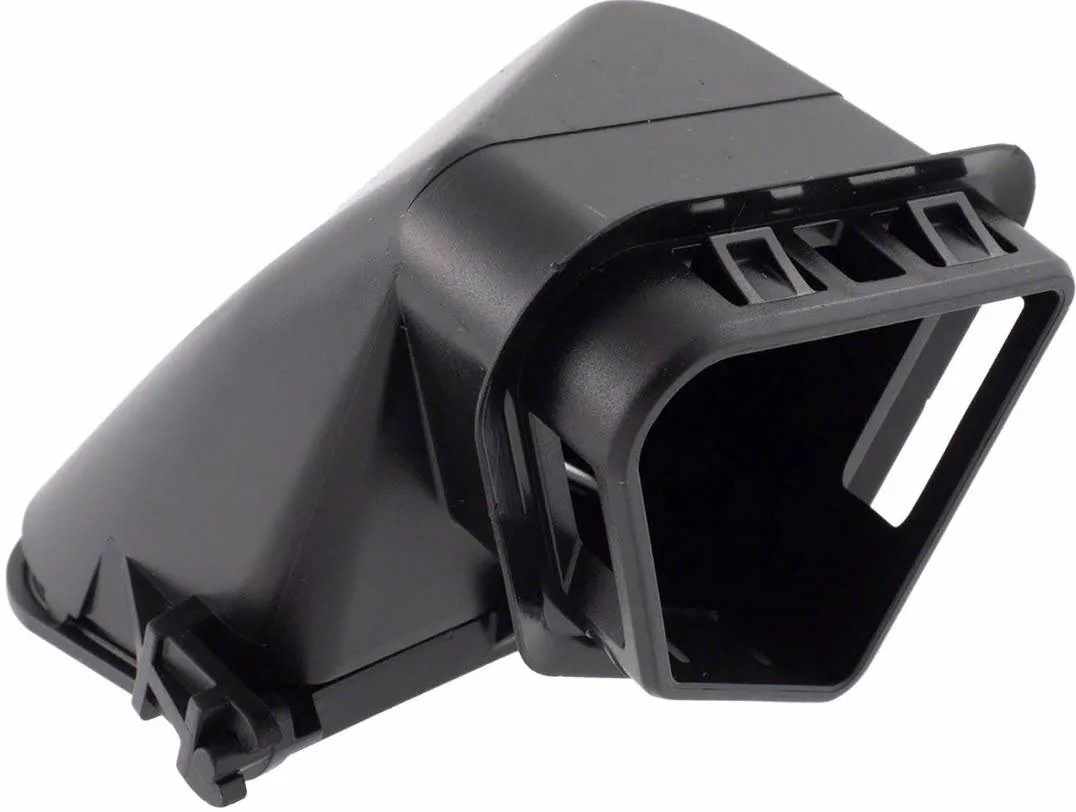

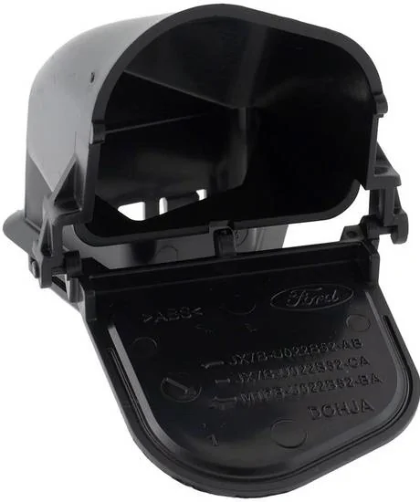

Checked Ford Parts and found Cowl Panel Drain Valve.
It drains water that comes in thru the cowl plastic grill and drains down to engine compartment somewhere. Might be a mouse could climb up thru it.
RH/Center Cowl Drain Valve
Ford Maverick How to keep the mice at bay? Cowl Drain Valve-1 PN JX7Z58503A20B
Ford Maverick How to keep the mice at bay? Cowl Drain Valve-2 PN JX7Z58503A20B

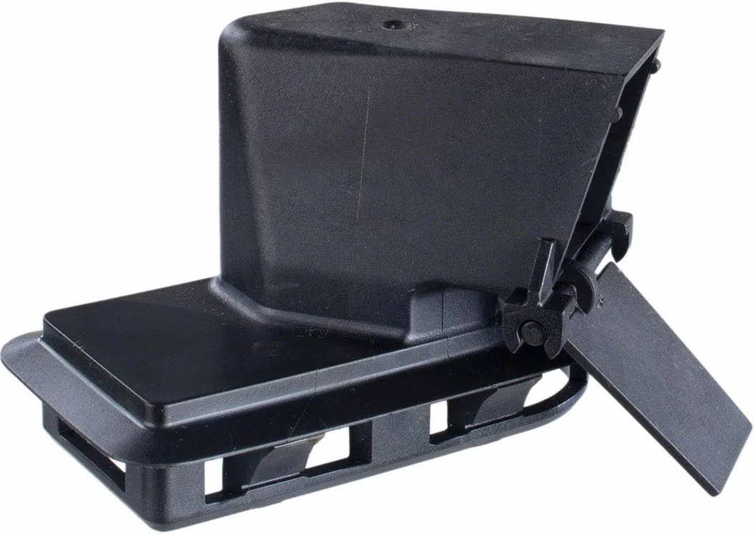

LH Side Cowl Drain Valve:
Ford Maverick How to keep the mice at bay? Cowl Drain Valve-2 PN M1PZ17503A20A
Ford Maverick How to keep the mice at bay? Cowl Drain Valve-3 PN M1PZ17503A20A-1

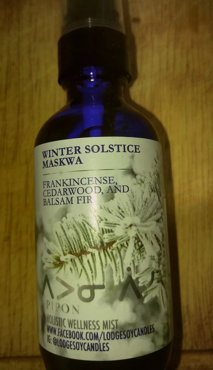

After reminding myself the other week that the major component of fresh cab is balsam fir, I spotted this in the bargain bin when I was at the pharmacy... so I am going to give it a whirl... not that I have a problem yet, so it might work just as good as the elephant repellant brick I keep on my front porch, but better safe than sorry. It's pretty potent, though not unpleasant...
Ford Maverick How to keep the mice at bay? balsamfrisionplues
Also have some dollar store hotsauce for if there seems to be evidence of nibbling anywhere. (Stuff without sugar, ofc, but if you want to get an insect/ant problem, since they are unaffected by the pepper, do what you like.)
