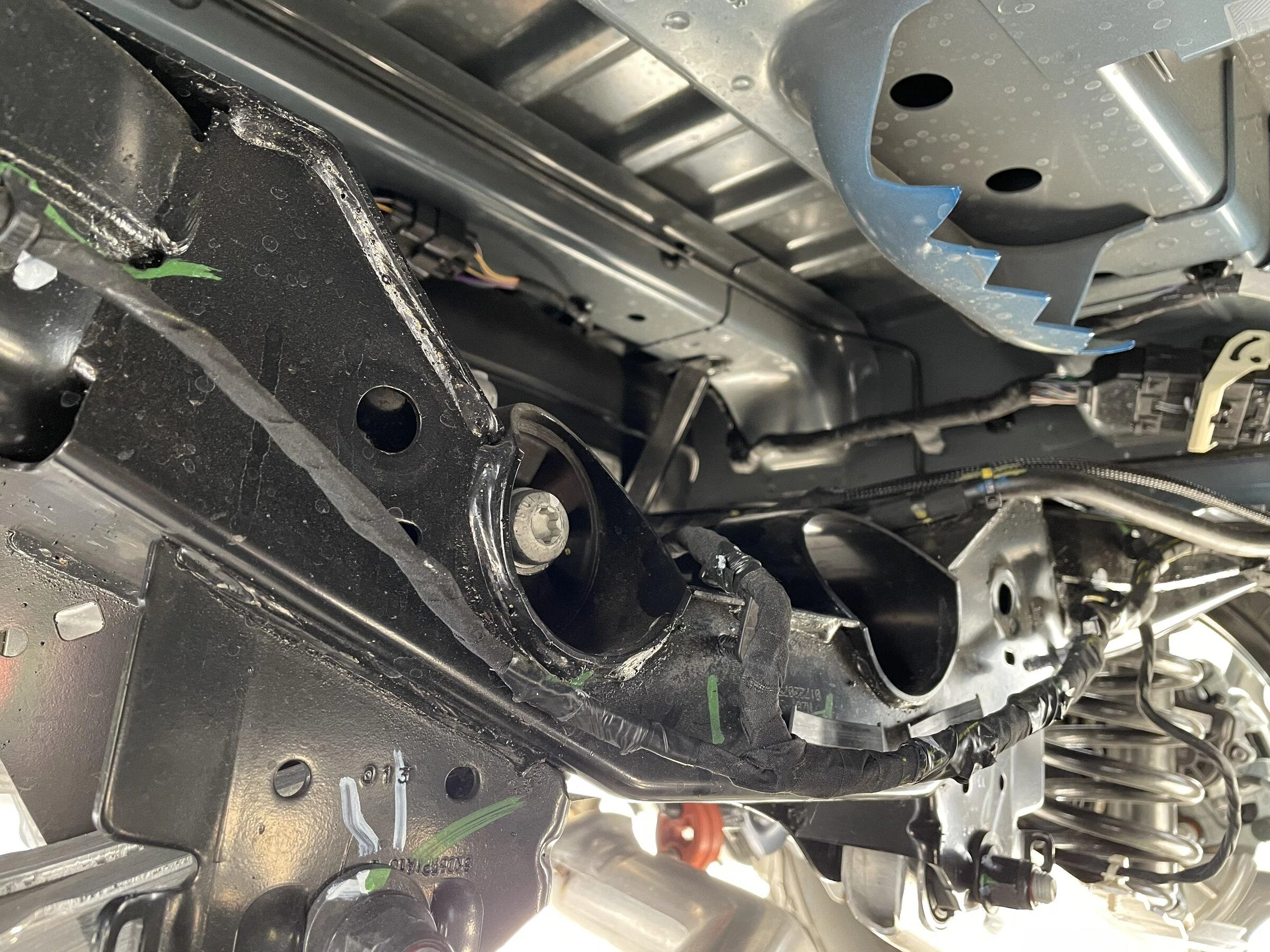

Finally got a set of five (5) 245/65R17 Vredestein Pinza ATs mounted. Today I got the spare mounted underneath. First I bent the teeth on the front down with a large crescent wrench. It went in pretty easy and was tight up against the downward facing teeth with room to spare between the tire and cable and tire and tow hitch.
Ford Maverick Maximum Spare Tire Size 20241113_142501~2
Ford Maverick Maximum Spare Tire Size 20241113_142434
Ford Maverick Maximum Spare Tire Size 20241113_141728
Ford Maverick Maximum Spare Tire Size 20241113_141735
Ford Maverick Maximum Spare Tire Size 20241113_142536

I know this is an old thread but 235/70r17s are in my future eventually. Couldn't you just crawl under the truck with a die grinder and cut those teeth a half inch shorter? Giving you clearance for a larger spare but still functioning teeth in a collision.

That tire size is 30.0 inch diameter. I went with 245/65R70 which is 29.5 inches. I took a hammer and vise grips and bent those teeth out of the way. I'm sure you could easily mount a 30 inch in that space.

The factory 215-width undersized spare fits ok. The factory 225 tires only fit with the tire-ripper teeth inside the tread spaces. Not sure about the Tremor 235 tires, but presumably they would fit the same as the 225s. Maybe 245 low-profile tires with about the same diameter as the factory 225s would also fit, but certainly not a higher-profile tire without torching off the tire-ripper safety device.

Make me wonder why Ford, after 5 model years, hasn't moved the tire-popper forward an inch, to provide more clearance for larger diameter tires.
HRG
Not my pic, I snagged it from another poster years ago.
Ford Maverick Maximum Spare Tire Size PXL_20240112_011658665

Here are before and after pictures showing the teeth in front and tow hitch behind the OEM donut, teeth after bending down with crescent wrench and hammer, and my mounted full-size 29.5 inch diameter 245/65R17 spare. I think you can fit up to a 30.5 inch tire.
Ford Maverick Maximum Spare Tire Size 20241022_180455~2
Ford Maverick Maximum Spare Tire Size 20241022_180519~2
