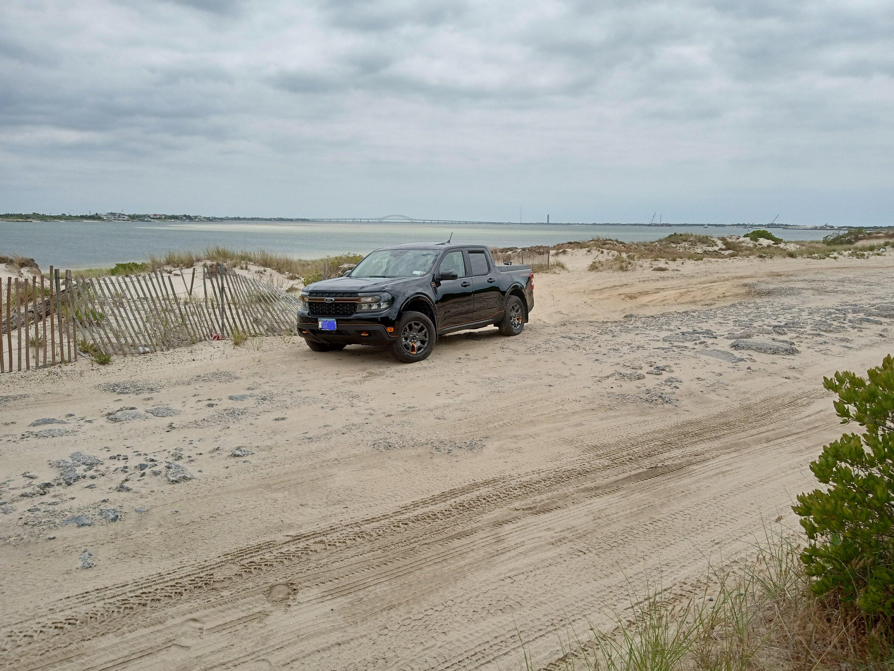

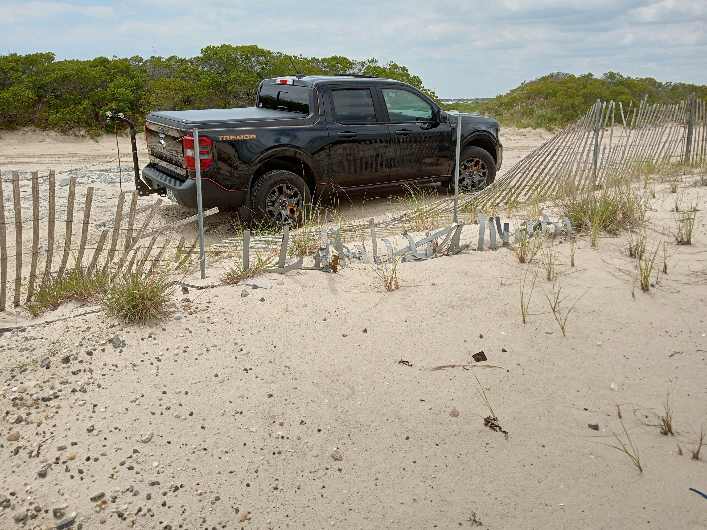

I am very happy so far. However to be fair I have only logged over 2k on the vehicle. LOL It's a new vehicle what do you expect.😊 What impressed me the most was the way it handled on deep sand that's precisely why I purchased the Tremor option. The locking differential is the ticket. My Blazer did well on the beach however the Maverick was much smoother. Must be those good old computers doing there thing. I'll get back to you in another 15,000 miles.
Ahhh I just got scheduled today for a Black tremor exactly like yours and I got it precisely for the same reason-deep sand. Living in Baja we got lots of the stuff! Cheers

I know you are excited about that. Good luck with your new Tremor and don't forget to air down on the beach.!! 😊
