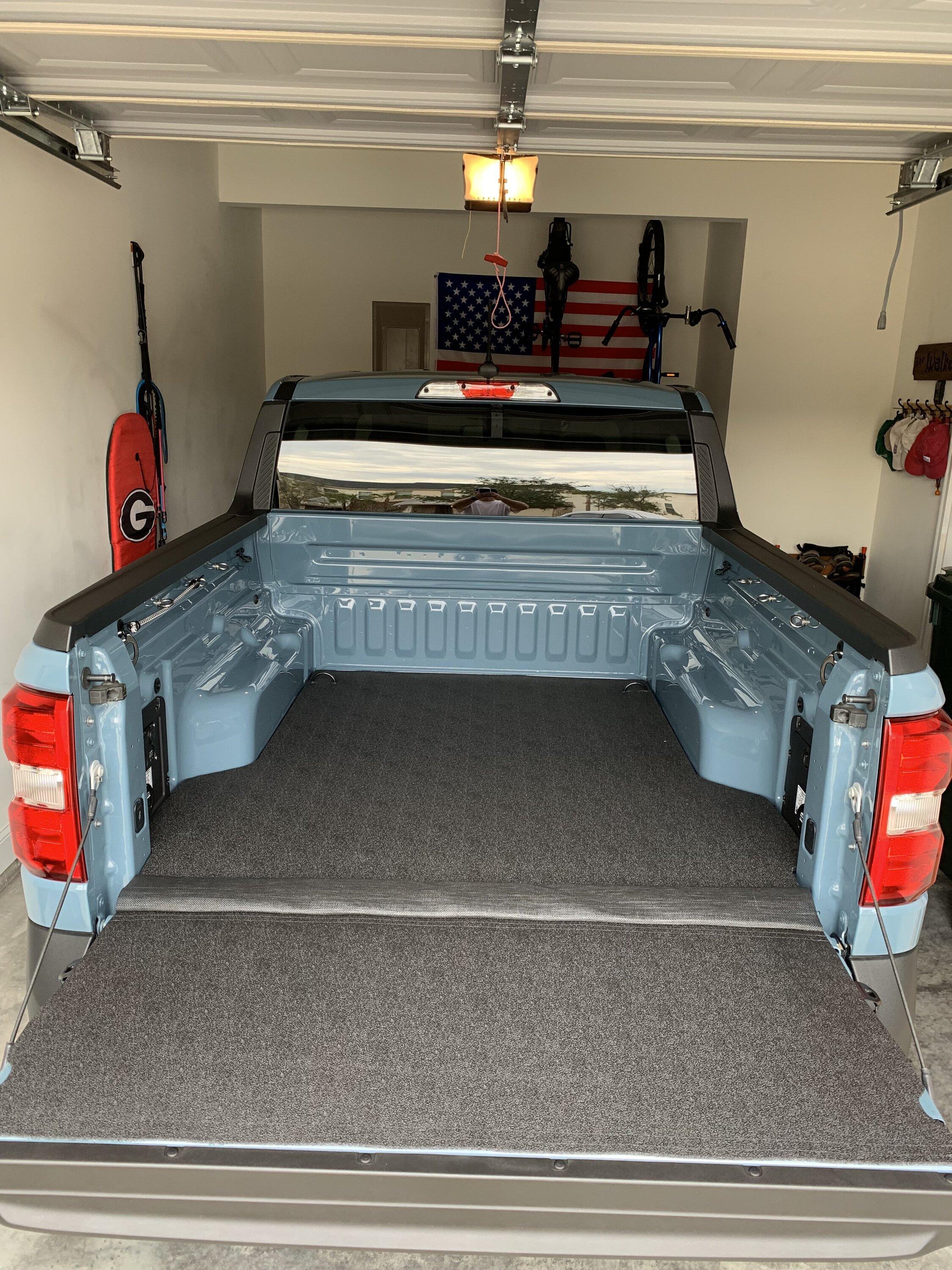

Hey Silverado90, where did you get the bed rug and what kind is it ETC. Thanks!
