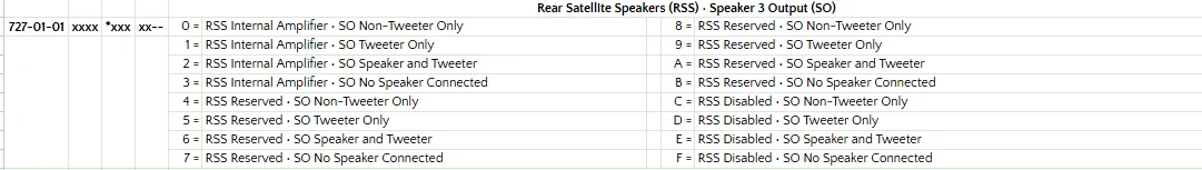

I added a set of components to the rear doors of my F150 and it made a very noticiable difference in being able to hear the rear speakers. I also made a FORScan change to the ACM to tell the ACM that there was a speaker and tweeter. This was a long time ago.....I don't remember if I had a 0 or a 1 here from Ford, but I changed it to a 2. I used a resitor on the tweeter to filter out low and mid-range frequencies from going to the tweeter. Below is from the F150 ACM......not sure if the Maverick ACM has these same values in this bit.

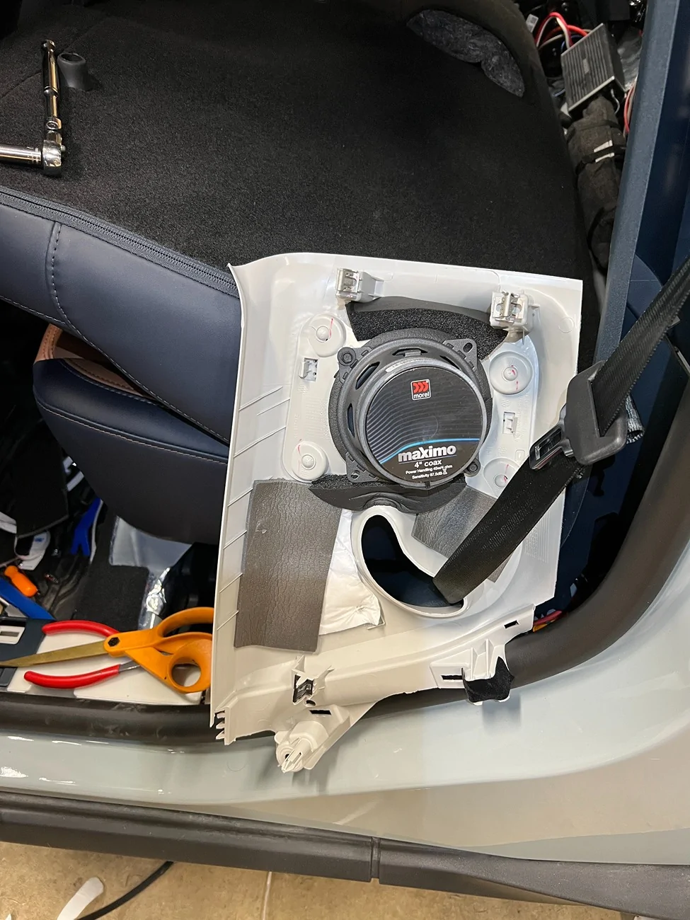

The rears really don't do much. They were the last thing I did after upgrading the front stage and adding a 10" sub. I went with entry level Morel Maximos (I put Morel Tempo Ultra's in the front.)
Sound deadening made a big difference as well.
