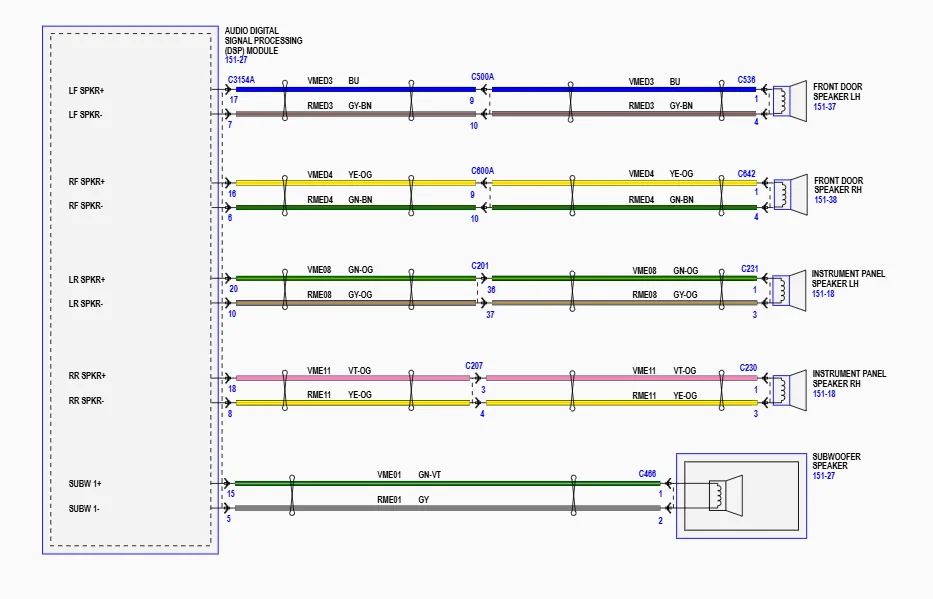

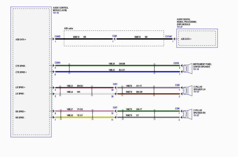

Attached are the wiring diagrams for the 8-speaker B&O system. The c-pillar speakers are powered by the ACM. Unfortunately, the B&O systems in Ford vehicle are tuned to be front-stage bias and the rear speakers are just there for fillers which is why you barely hear them.

If you get a component set and put the mid/woofers under or behind the seat, it really won't help a lot. Vocals will be almost gone and muffled, because the tweeters only play the upper ranges where little vocals actually exist. It just isn't a recipe for good sound, regardless of sound level. Even if you managed to mount the mid/woofers somewhere not behind/under the seat, there still wouldn't be a huge improvement, simply due to the way the B&O is set up to be so front biased. I promise you a good set of 4" 2ways in the factory location will help just about as much as the component set, and will sound better for 90% of the frequency range. Just let them play the 120-140hz range and up.
If you plan on upgrading the rest of the system eventually, just get some good 4" and put back there, and you can make them louder later when you get an amplifier/DSP setup that gives you full control over their sound level, and have that extra space for your sub. Once you have the amp/DSP setup, you can cut everything below 150hz, and let those 4" speakers sing without worrying about them popping, haha. Now, a component set in the front is definitely the way to go. Of course, Forscan is also a must. I just don't think you're going to be happy at all with your initial idea is all I'm saying :)
Im having trouble wrapping my head around that it would not sound good, its very front biased because the amount of sound coming from the front plus alittle software jazz, adding in a woofer and tweeter x2 that will be crossed over in the back and receiving full range would play way better no? it would just be like having door speakers in the rear like most cars do. Its from the ACM and would not be a tempered with signal going through the B&O amp.
