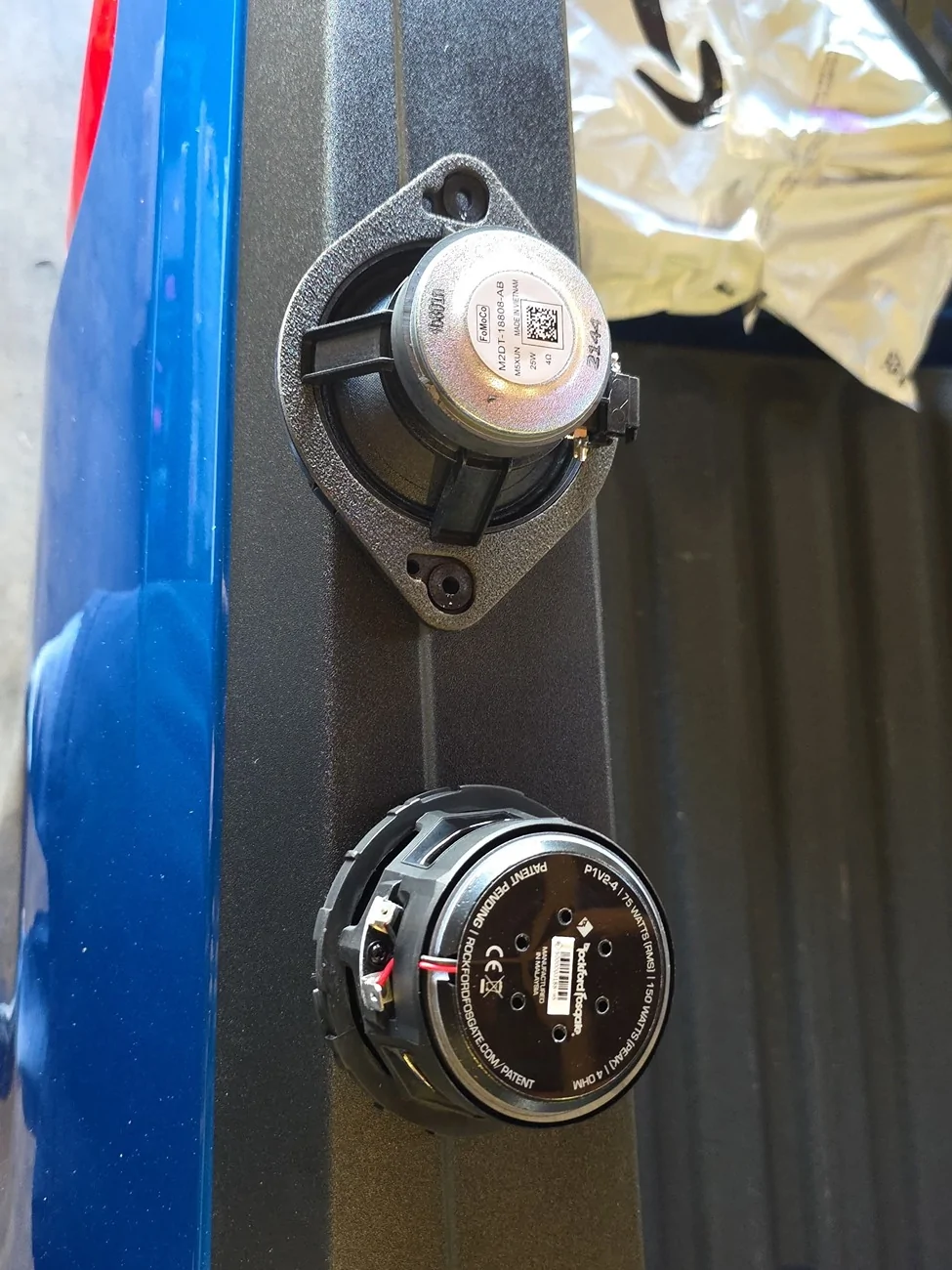

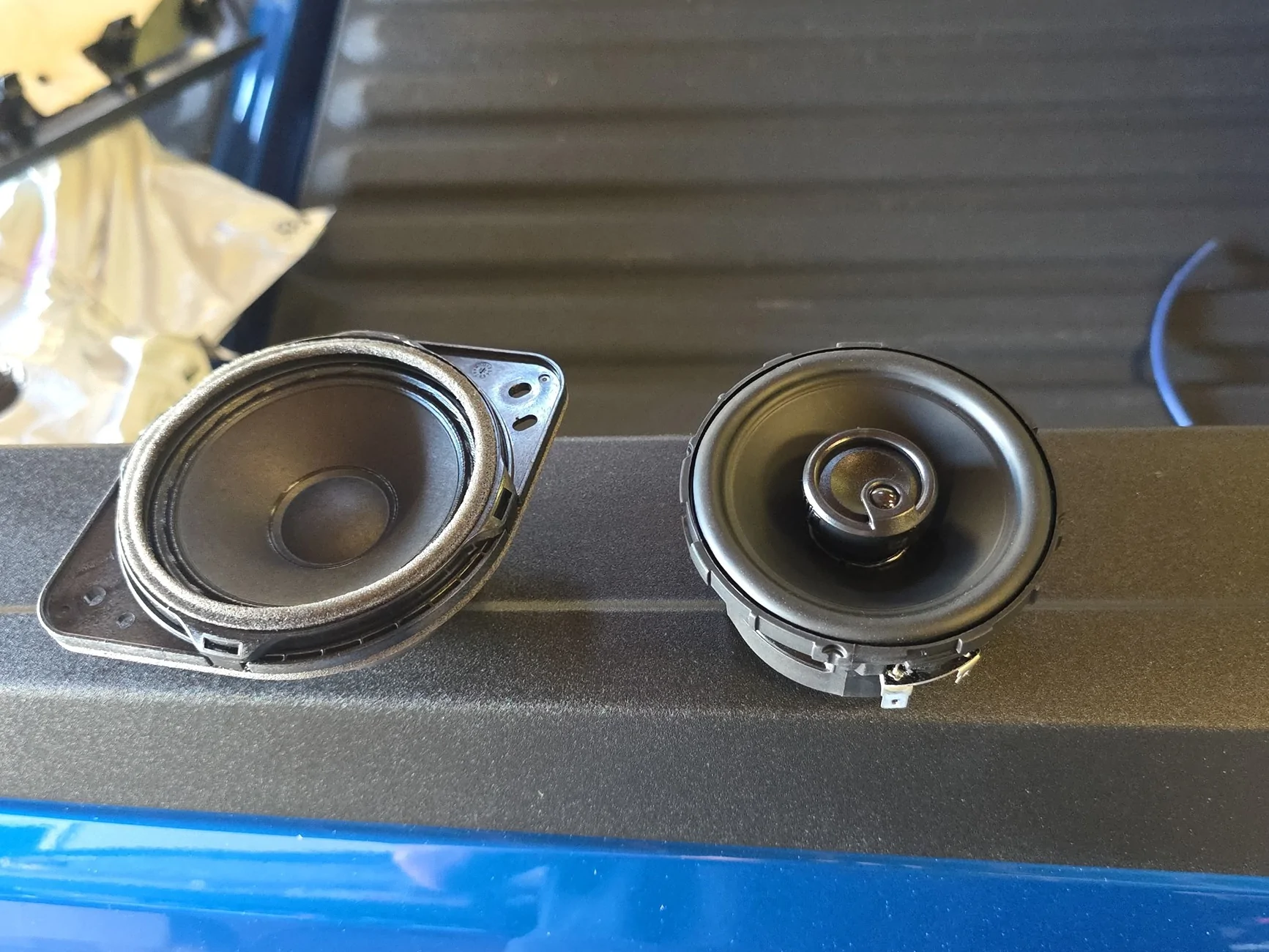

Here are the factory speakers next to what I replaced them with. And forscan controls the crossover for the rear
