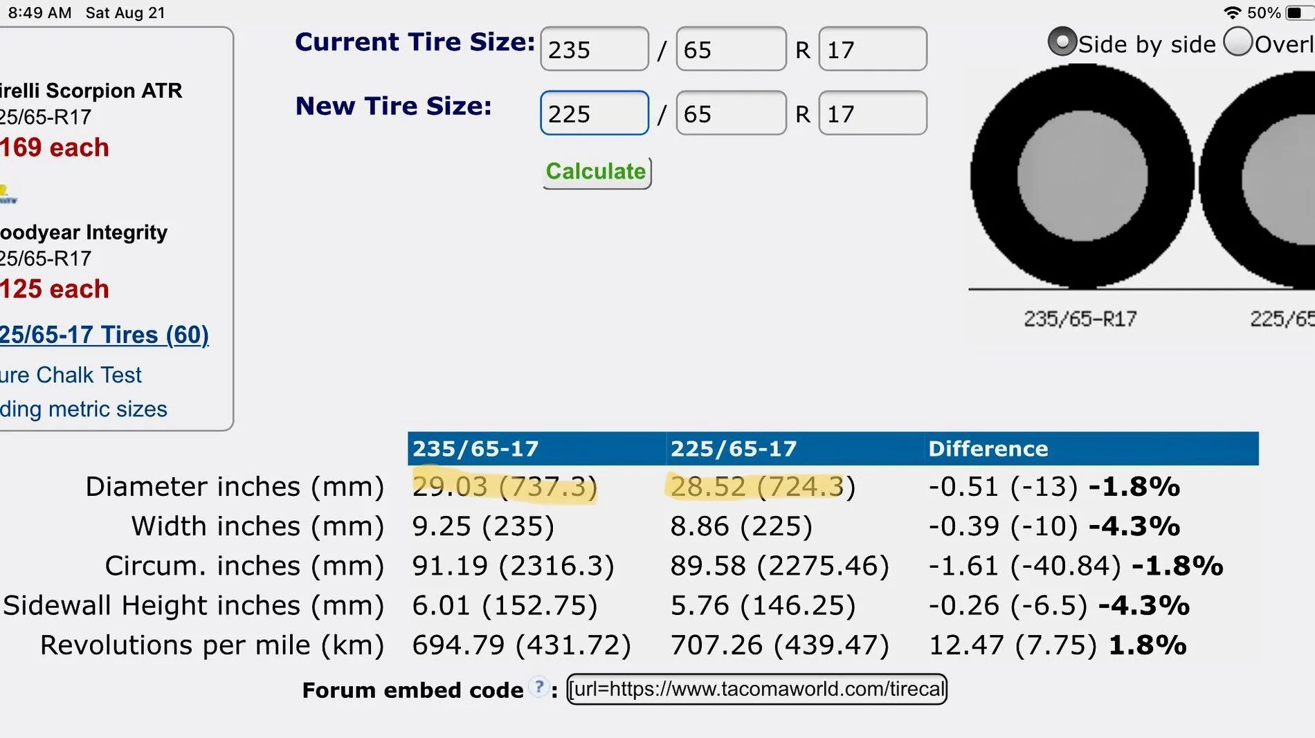

You are incorrect, sir. A 235 tire and a 225 tire do in fact have different "heights". The poster you quoted is correct. All Mavericks will have the same 8.3" of ground clearance UNLESS fitted with the 235/65R17 Falken Wildpeak tires giving that particular truck 8.6".
This…

Sir, 235 and 225 are width of the tires in mm. The tires have identical side wall heights = 65mm, both on 17" rims.
That's not what the 65 means. The second position in tire measurements is Aspect Ratio or percentage of width as sidewall height. So 235 * 65% = 152.75mm. 225 * 65% = 146.25mm.
So, let me get this straight, you are saying tyre diameter /2 is not tyre radius but some other magical wizardry that when multiplied by the aspect ratio gives the height of the tyre?
talk about your non Euclidean geometry
Darnon
Jul 4, 2021
5,745
7,274
WNY
In P-metric sizing overall tire diameter is not a specification. Nominal width, aspect ratio, rim diameter.
But it lists the diameter of the tyre it’s highlighted in yellow next to the words “diameter tire inches(mm)”
That's not a value listed in 235/65R17. It's an inferred value. In fact, it's not uncommon for same size tires to have 1/2" or more difference in overall diameter.
(235mm * .65) x 2 = 305.5mm + 431.8 (17 inches) = 737.3mm
Again you are saying diameter does not equal diameter.
Not worth discussing with you.
Agreed because you clearly can't read. I initially said "65" is not 65mm but 65%. Nothing about diameter or radius.
/plonk the discussion is about the height of the tyre
