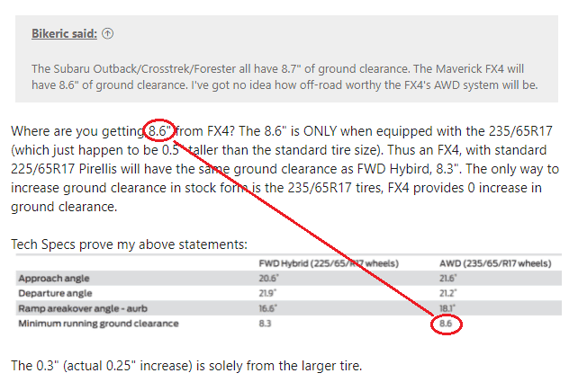

Where are you getting 8.6" from FX4? The 8.6" is ONLY when equipped with the 235/65R17 (which just happen to be 0.5" taller than the standard tire size). Thus an FX4, with standard 225/65R17 Pirellis will have the same ground clearance as FWD Hybird, 8.3". The only way to increase ground clearance in stock form is the 235/65R17 tires, FX4 provides 0 increase in ground clearance.
Tech Specs prove my above statements:
The 0.3" (actual 0.25" increase) is solely from the larger tire.
I'm not sure if you're joking or not, so I drew a red arrow showing where I got the 8.6" from. Also, the FX4 package is only AWD. You cannot get a FWD FX4.
Ford Maverick Maverick FX4 off-road capability? XsboZDc
The FX4 package itself does NOT come with 235/65R17 tires. Those are optional tires. The FX4 comes with 225/65R17 Pirelli's, thus giving you the same 8.3" of ground clearance as the FWD. I'm glad you can connect two circles with a line though (y)

Yup, the 225/65R17 Pirelli Scorpions are ~1/2" shorter than the optional 235/65R17 Falken Wildpeaks.. Appears to me that the additional 1/4" of clearance is solely from the optional tires.
Edit to add: They also show the 235/65R17 size right there on the specs, so it pretty much confirms the taller tire is what's driving the difference in the posted tech specs.
Exactly, some want to keep arguing but it clearly shows AWD (235/65R17) on the Ford specs, it does NOT say FX4 AWD. If the FX4 were taller or providing the clearance, it would be noted.
