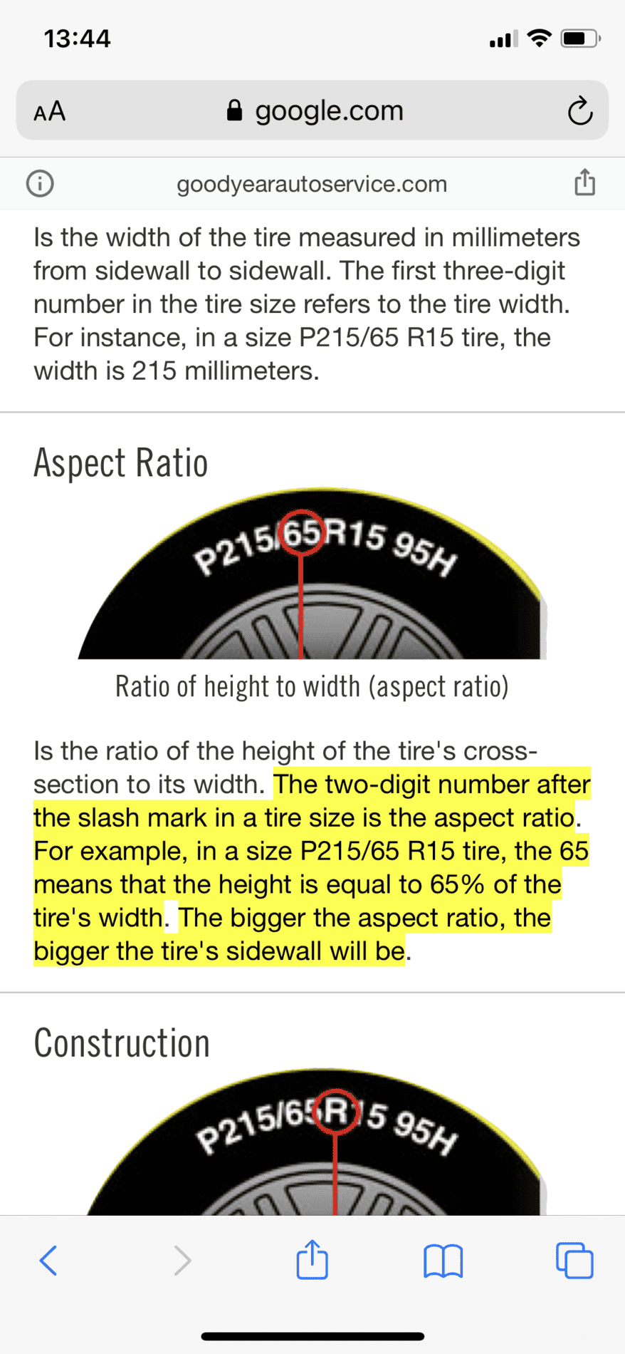

Sir, 235 and 225 are width of the tires in mm. The tires have identical side wall heights = 65mm, both on 17" rims.
Lasty, all FX4 are AWD. The extra height comes from suspension changes not tires.
Side wall height is NOT 65mm, it's 65% of the width. The suspension does not change height in any way between FX4 or non-FX4. Monotube rear shocks don't provide lift. As far as we know, there's zero difference in the front suspension either. If Ford lifted the FX4 model, we'd know about it. They wouldn't keep their descriptions of the suspension vague with no mention of additional lift, we'd see it hyped up everywhere.
Also notice, how they explicitly list the tire size right there in the tech specs? That's because it's the driving factor for the difference in the numbers. An FX4 equipped with standard 225/65R17 Pirellis will be identical in height/ground clearance as the FWD hybrid. Sorry if this isn't what a lot of you wanted, it's the facts Ford has provided. Drive modes and tow hooks won't get you any further along "off-road", might give you a little mental boost to hit up some gravel roads, but this "off-road" package, isn't turning your Maverick into something that can follow right along the same trails as a Bronco Wildtrak or something.

Hope this helps. Go tired of reading the whole post
Ford Maverick Maverick FX4 off-road capability? D4414A48-F1AD-4FE4-BECA-14294D0AA26F
