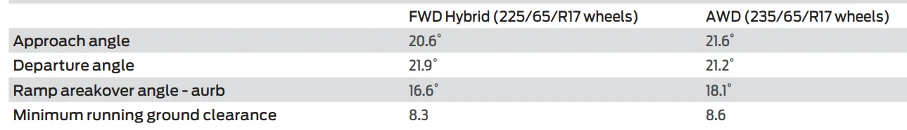

Where are you getting 8.6" from FX4? The 8.6" is ONLY when equipped with the 235/65R17 (which just happen to be 0.5" taller than the standard tire size). Thus an FX4, with standard 225/65R17 Pirellis will have the same ground clearance as FWD Hybird, 8.3". The only way to increase ground clearance in stock form is the 235/65R17 tires, FX4 provides 0 increase in ground clearance.
Tech Specs prove my above statements:
Ford Maverick Maverick FX4 off-road capability? 1629510118361
The 0.3" (actual 0.25" increase) is solely from the larger tire.
Sir, 235 and 225 are width of the tires in mm. The tires have identical side wall heights = 65mm, both on 17" rims.
Lasty, all FX4 are AWD. The extra height comes from suspension changes not tires.
You are incorrect, sir. A 235 tire and a 225 tire do in fact have different "heights". The poster you quoted is correct. All Mavericks will have the same 8.3" of ground clearance UNLESS fitted with the 235/65R17 Falken Wildpeak tires giving that particular truck 8.6".
