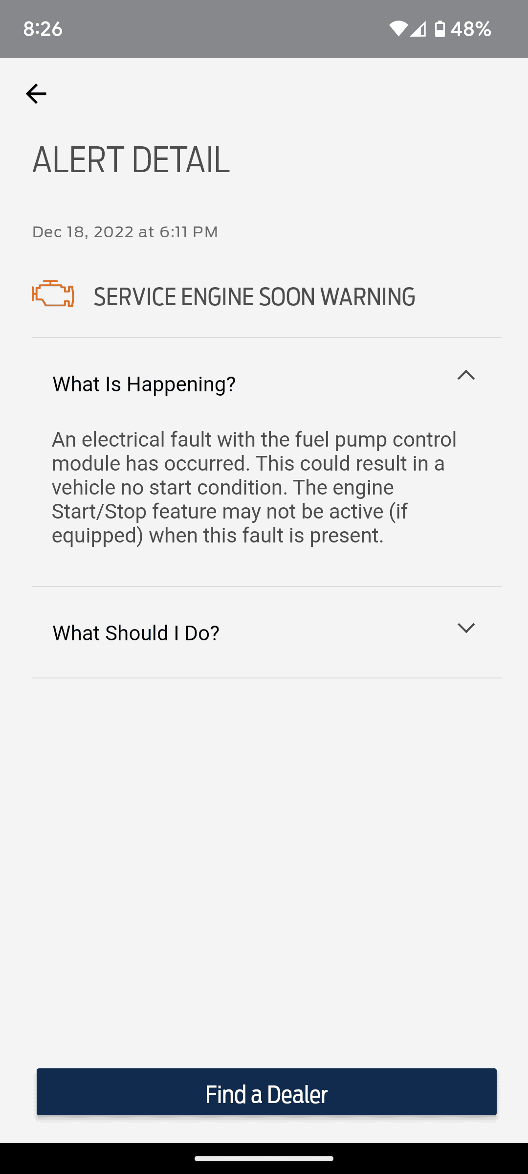

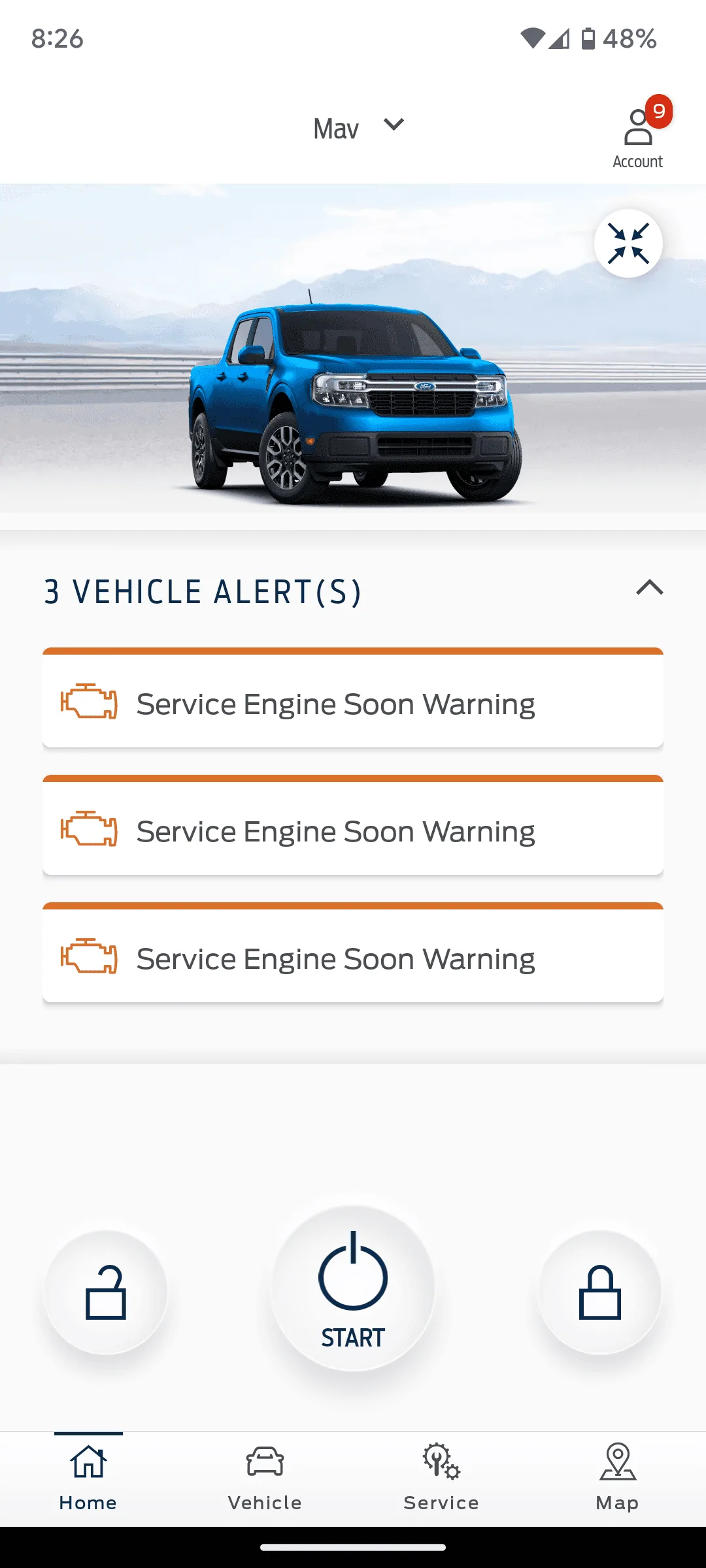

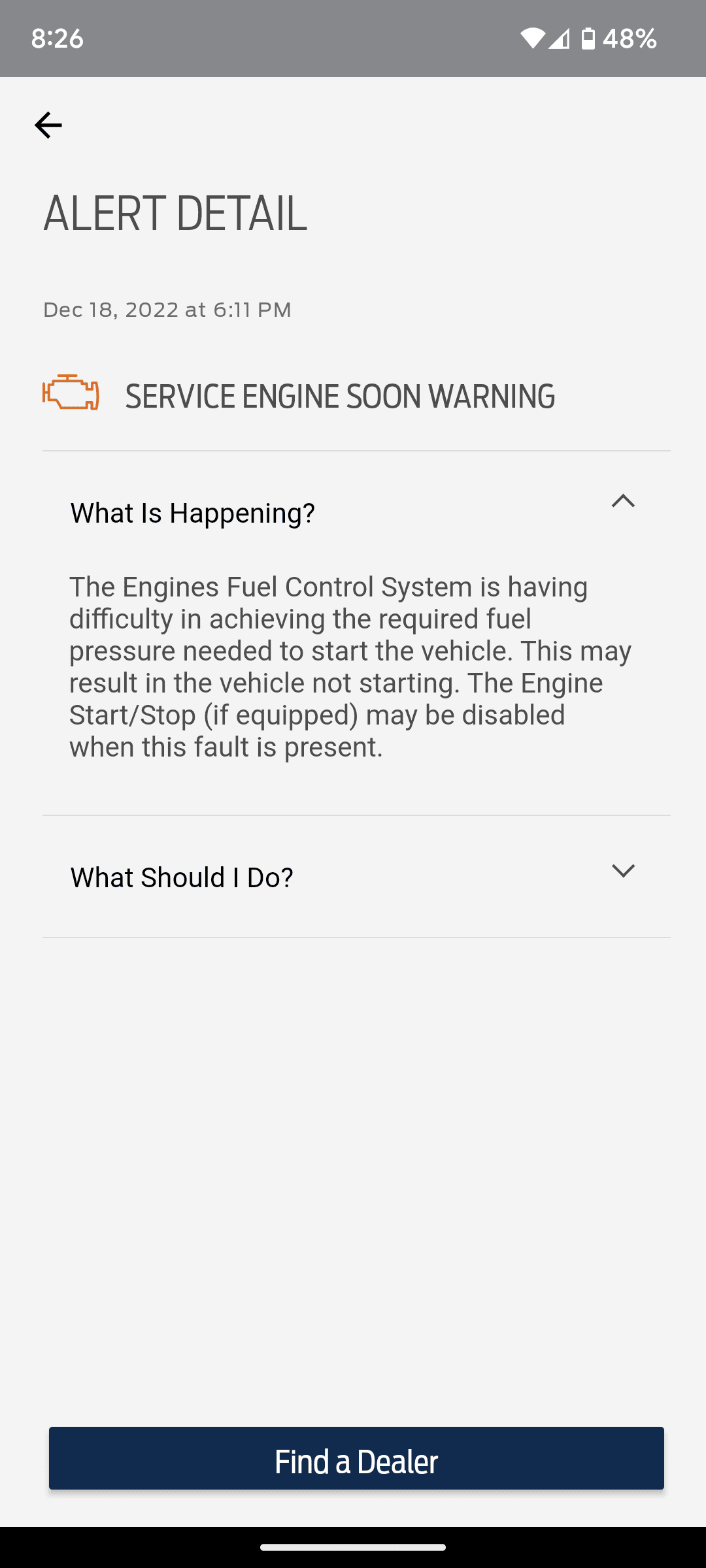

Brand New, parked outside in single digit temp's for 2 days. Got check engine light and car wont start.
Looks like battery is giving the ignition(click sounds) but car won't start.
Any ideas please. I see these messages in the ford pass app
I have heard a few members having battery problem even in the ecoboost, so definitely recommend the dealership 1st and the main reason to buy a NEW vehicle is warranty with free towing if/when needed. They should be able to determine if there are any other problems, but the battery itself can cause many codes since all the sensors need proper voltage to work correctly. Good luck, sorry for your problems so soon.

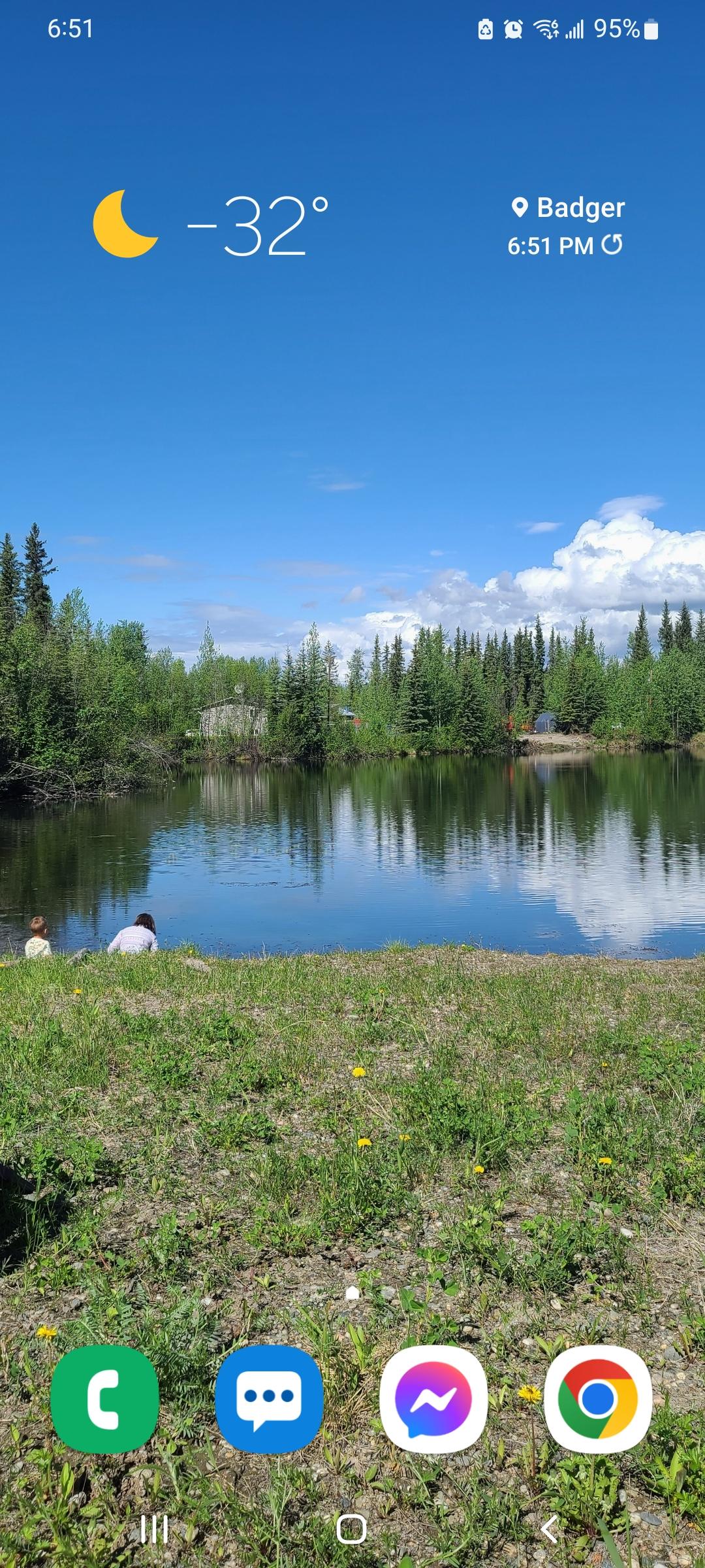

I am fully weatherized in North Pole AK. I keep mine plugged in, and have zero issues starting. Block heater, trickle charger, oil pan heater, and transmission heater. Good luck.
I use to live in fairbanks area back in the 80's
