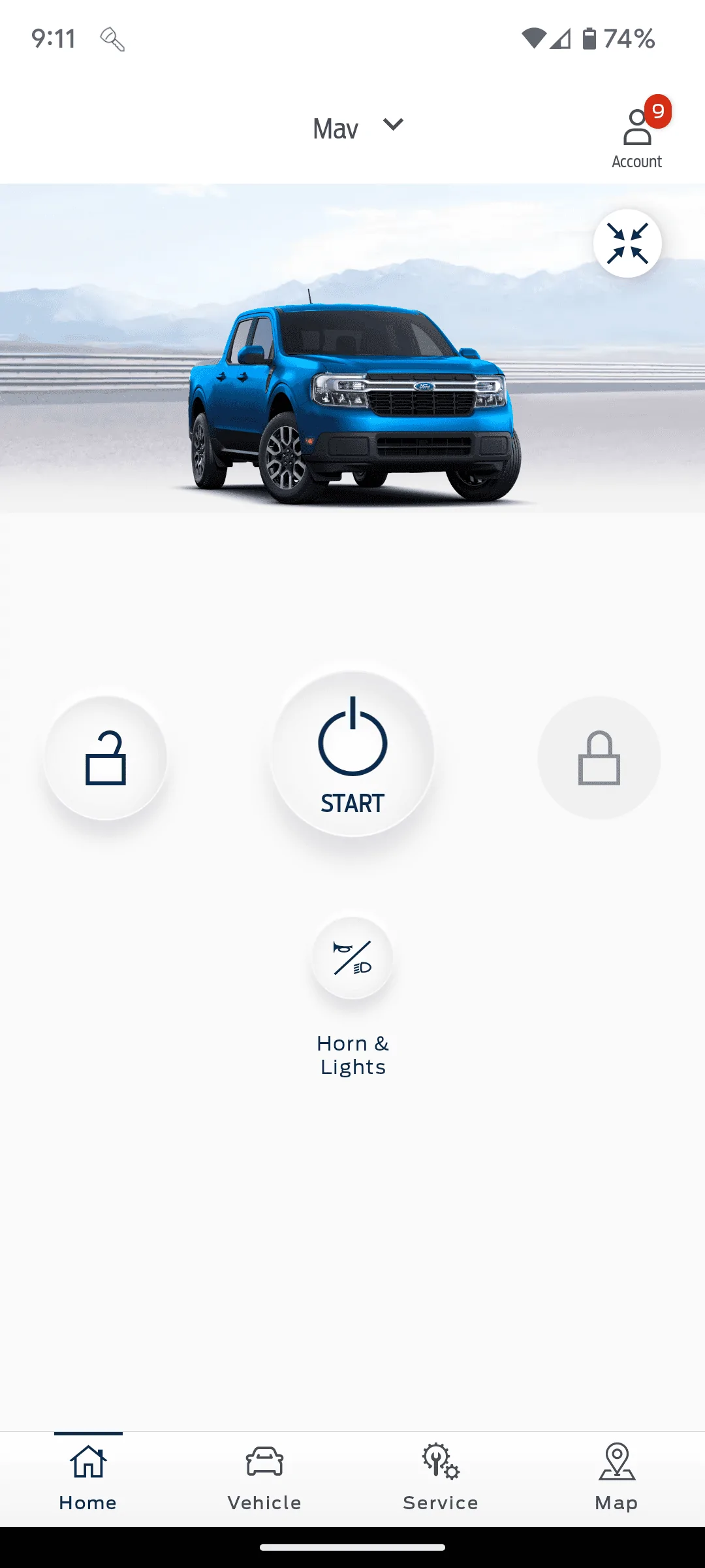

As I said, truck started in the morning with out doing anything(but the check engine light is still on)
Started it again this evening and it started and check engine light is gone 🤯😯.
Opened the Ford pass app and all the alerts are also gone. 🤯😯
Ford Maverick Mav outside in single digit temp's. Got check engine light and car wont start Screenshot_20221219-211124
Sooooo, is that it.
Am I good 🤔
Should I wait for next time to consider seriously 🤔
