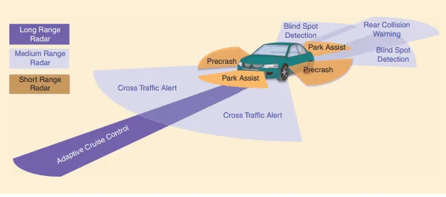

Here is some interesting reading for those who want to know where the Radar systems are and where they are going.....
Thanks for posting the article. I noticed it was published in 2017, going on 5yrs. I wonder what and how much has changed in that timeframe?
Not much has changed or will until 2025

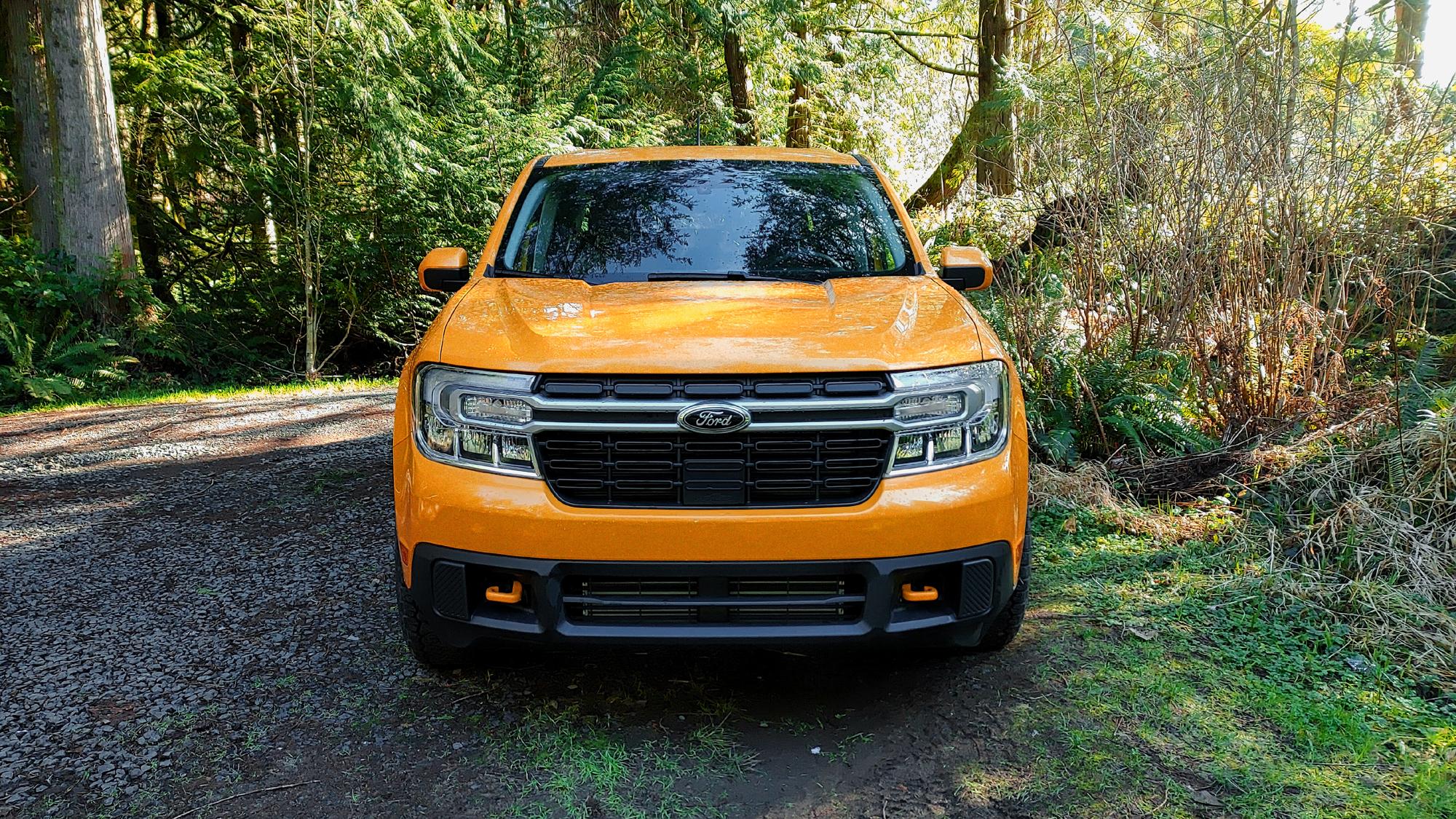

I now have about 2,300 miles on it since I applied the Forever Black to the ACC Panel. It is slowly losing its darkness. Probably half the darkness. It is fading evenly. If it ends up needing to be reapplied every 4,000 miles or so, that wouldn't be too bad. I also painted my tow hooks cyber orange since the original post.

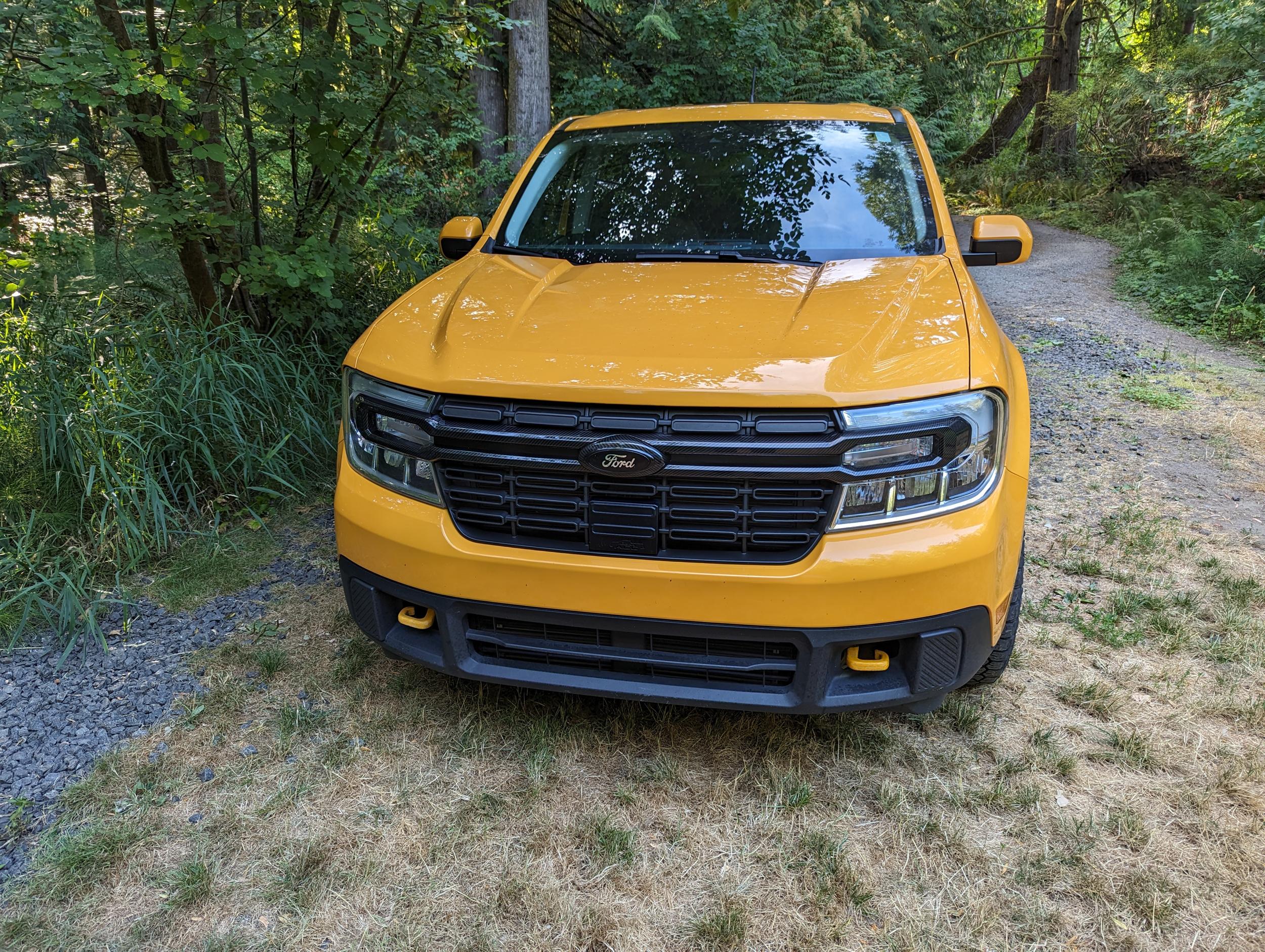

I'm at 15,000 miles now. In the heavy rains, it seemed to last well for about 2,000 miles or so. Then would fade away quickly.
Now it's lasting about 5,000 miles in the dry summer. Or it might be that the plastic has oxidized more and not so glossy, so it is adhering better. Either way it's lasting longer now.

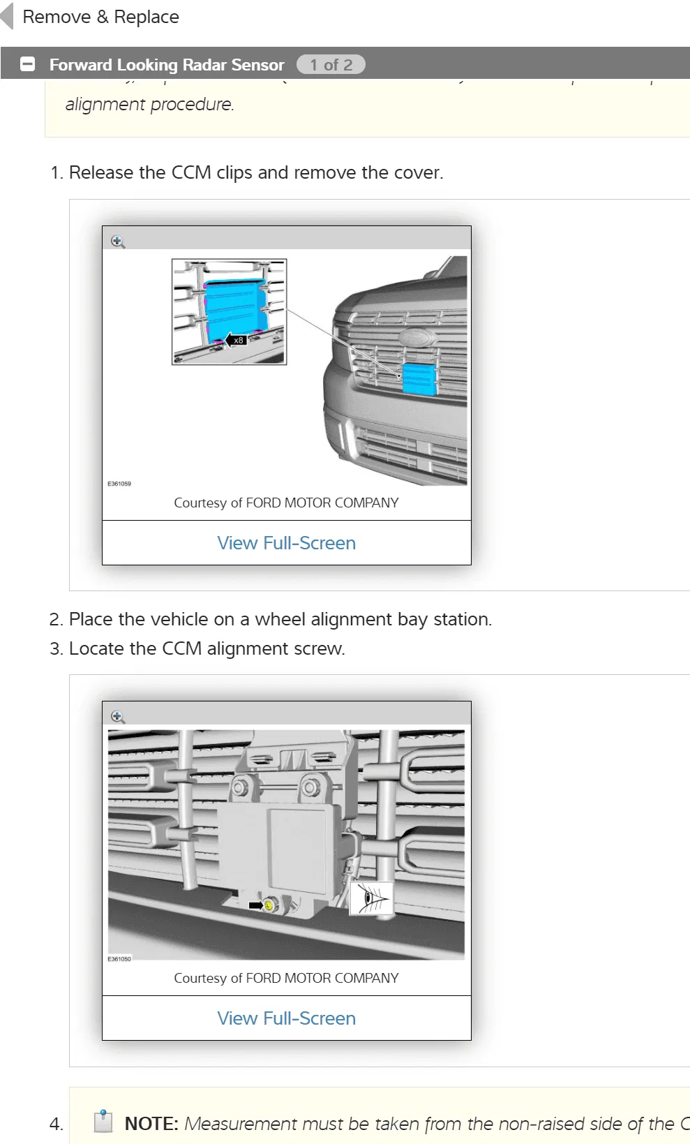

Clip location on ACC

I'm happy to report that after 4 applications over the first year, the color has been holding since. It's been about 10 months and I have not reapplied.
So reapplication hasn't been required over and over again forever. And I have put on a lot of miles in those 10 months. Just about to cross into 50k miles. Now if I could do something about my chipping paint...
