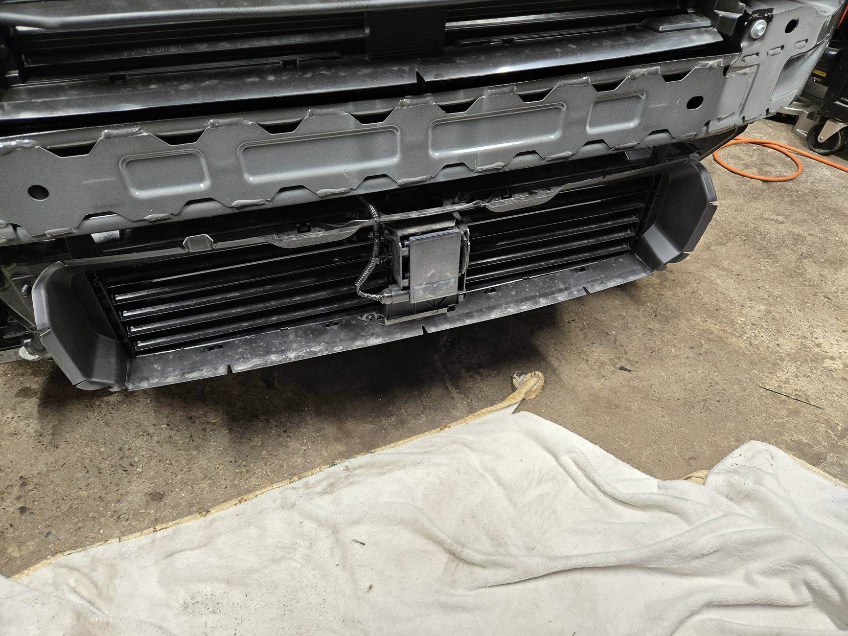

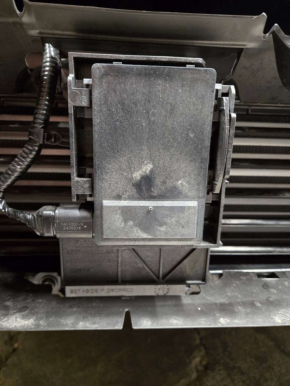

I looked at the acc DIY add on thread and the 24 to 25 is different. After a couple weeks talking with cvf. They won't have any thing available for a while to remount the acc module. So options are to get rid of it for now or buy a universal remounting bracket, probably go this route and get it out from in front of the intercooler. Found one that might work but isn't cheap.

**Update**
Intercooler is installed! Just used to acc bracket from a 25 ford maverick tremor. Part # SZ6Z14C022A.
The panel in front of the active aero shutters will either have to be removed or trimmed to fit like I did. Once the radar is relocated the rest of the install is the same.

Post digging. Just started researching Intercoolers for the Lobo with ACC and this thread popped up on google. I know its still in the general location, just a foot and some change higher maybe. Did you have to do any recalibrating for the sensor?

I didn't but results may vary. Some have had to get it recalibrate.
