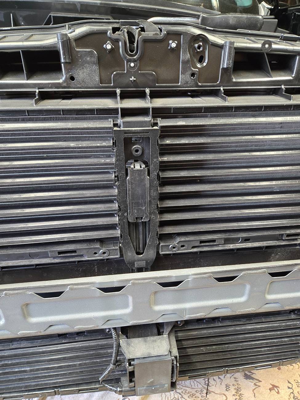

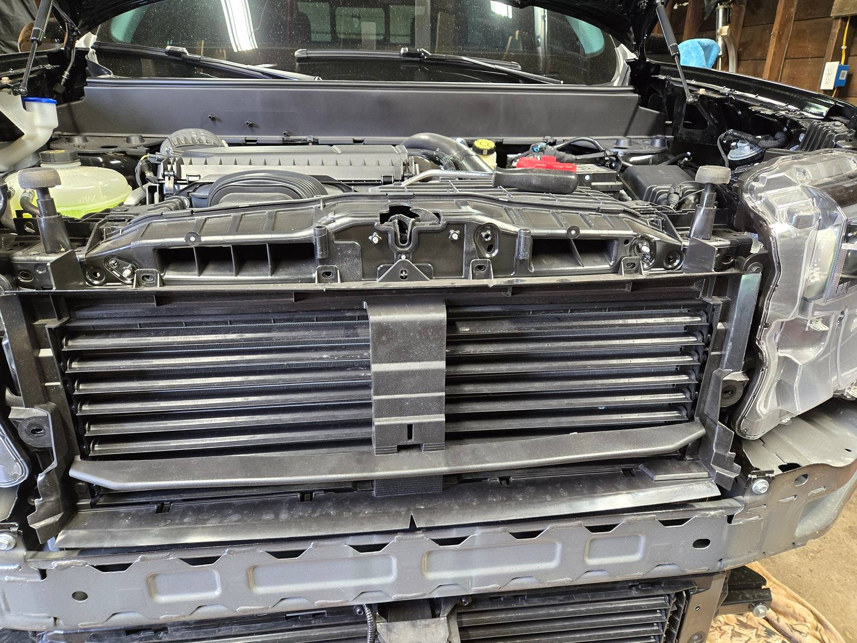

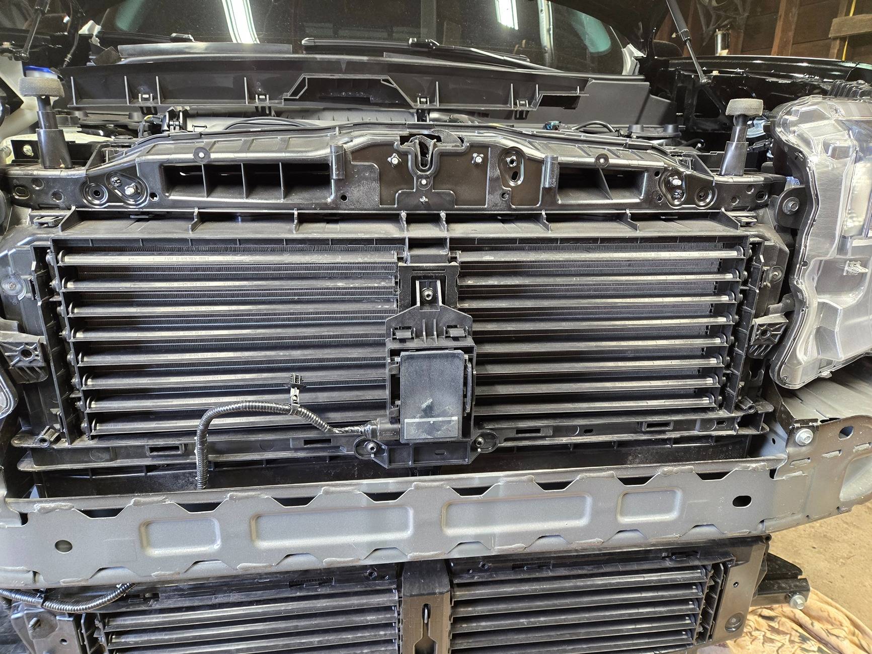

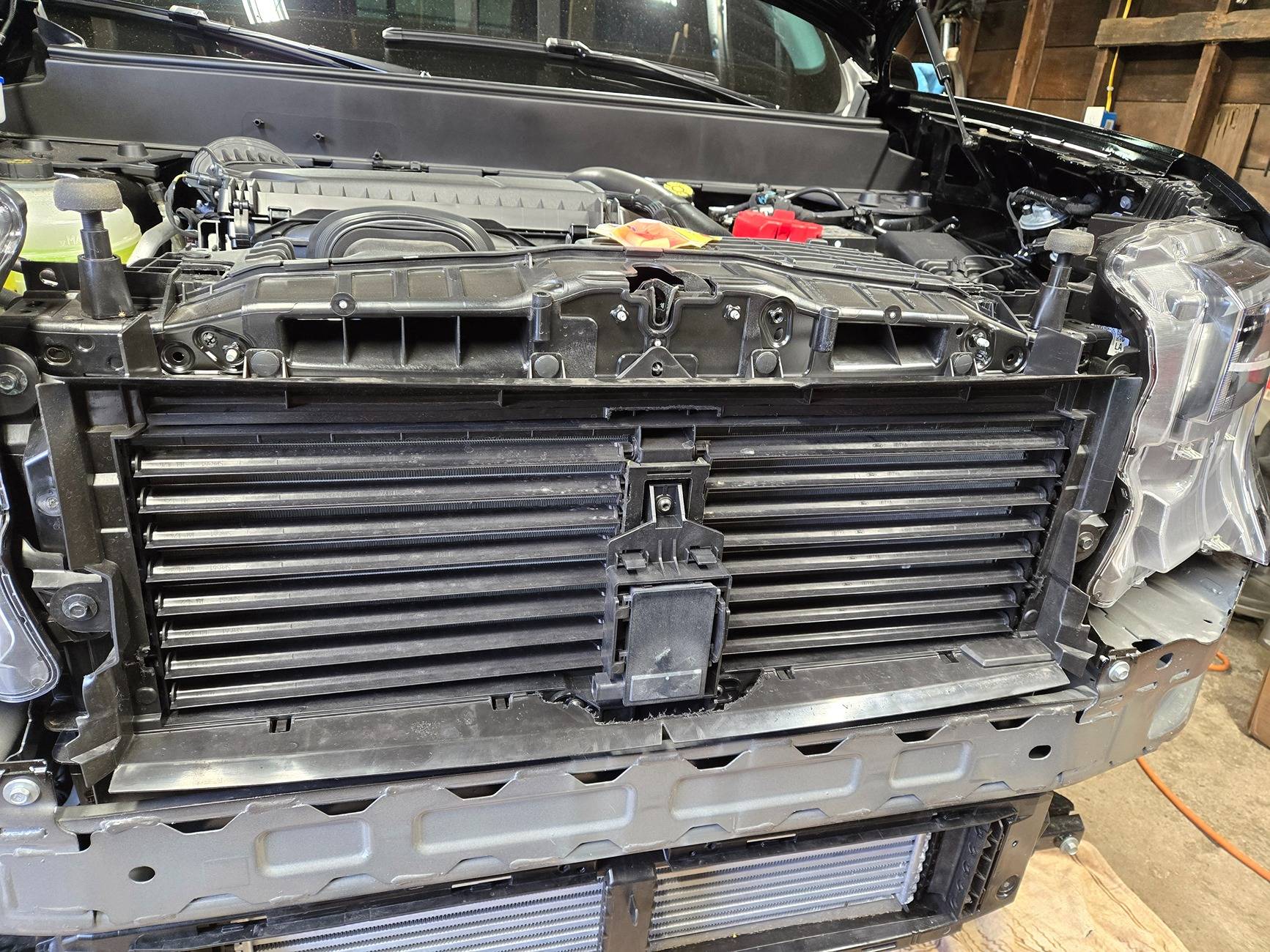

I looked at the acc DIY add on thread and the 24 to 25 is different. After a couple weeks talking with cvf. They won't have any thing available for a while to remount the acc module. So options are to get rid of it for now or buy a universal remounting bracket, probably go this route and get it out from in front of the intercooler. Found one that might work but isn't cheap.

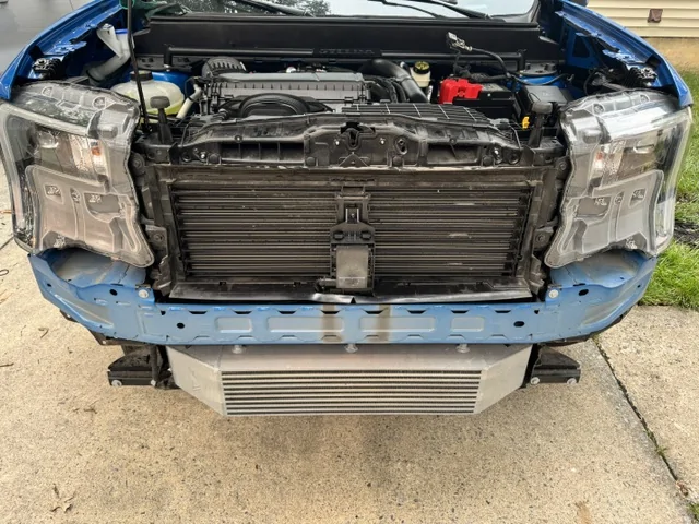

How much different is this? I know they offer these for the Corsair and they have the same location for the CCM. Maybe nobody verified? I guess I should buy one to confirm

Oh yeah, the intercooler is the same. Thought you knew of a bracket for the corsair that moved the acc.
No but also it appears not to be mentioned really anywhere that it needed to be moved. I can see though the Maverick might have less clearance however. I think the Corsair has more chin

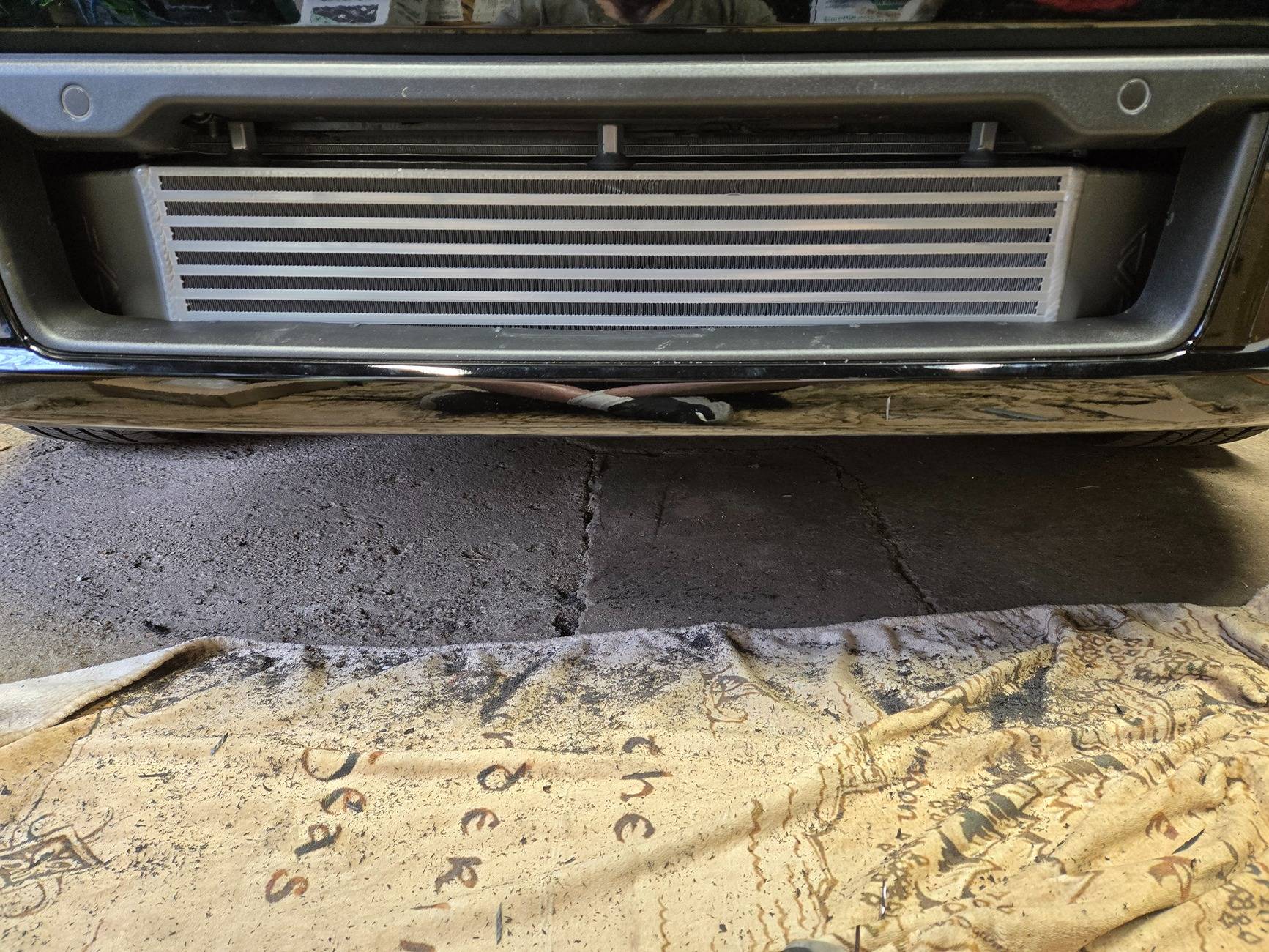

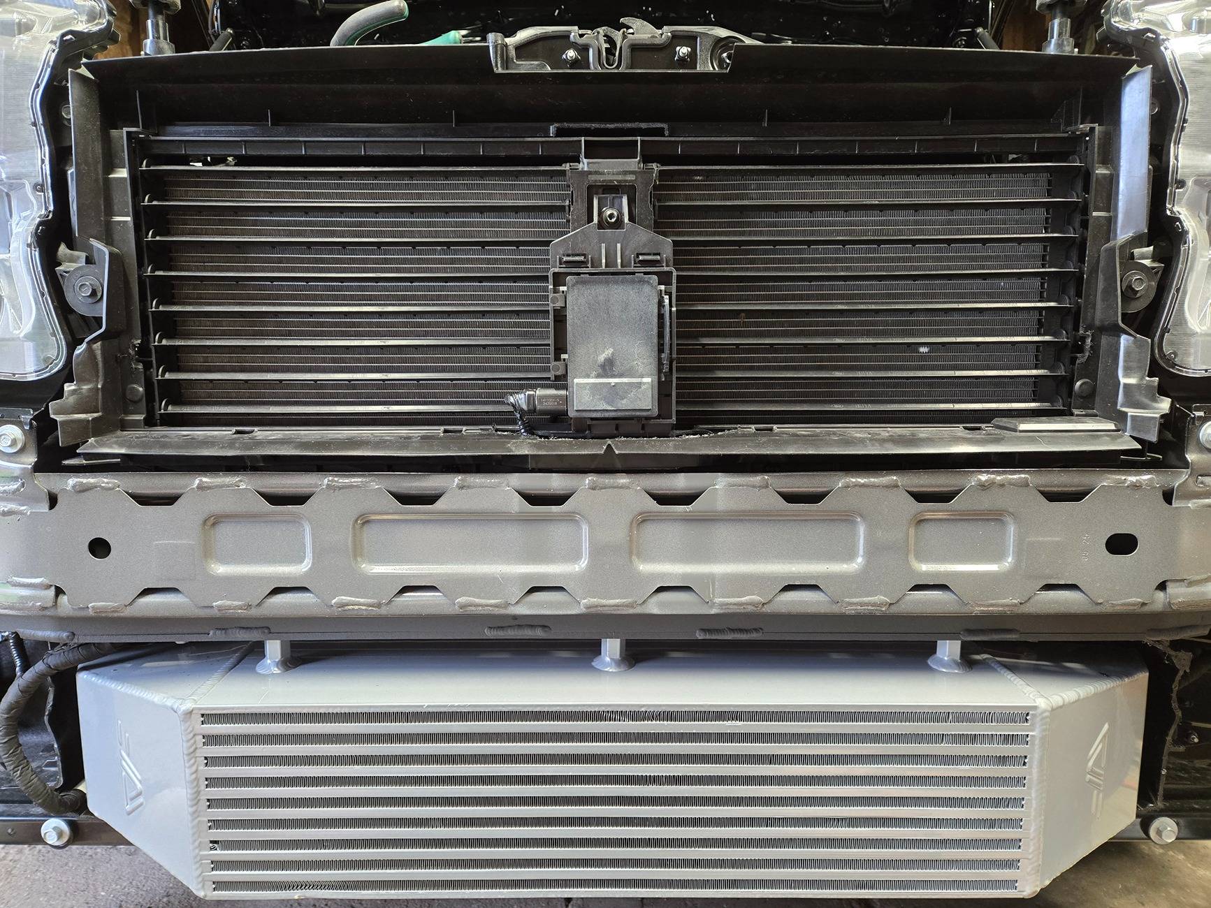

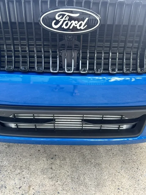

**Update**
Intercooler is installed! Just used to acc bracket from a 25 ford maverick tremor. Part # SZ6Z14C022A.
The panel in front of the active aero shutters will either have to be removed or trimmed to fit like I did. Once the radar is relocated the rest of the install is the same.
