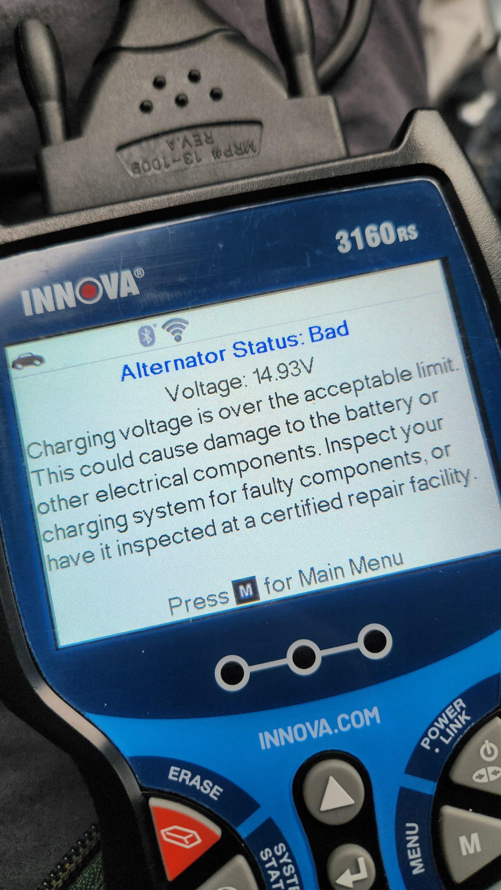

You would need to view the datastream to see what voltage the computer is commanding for charge voltage. 15 volts+ actually isn't that uncommon for modern charging systems as they now want to replenish the energy used for starting quickly and then drop down to a minimum voltage to reduce parasitic engine load.
