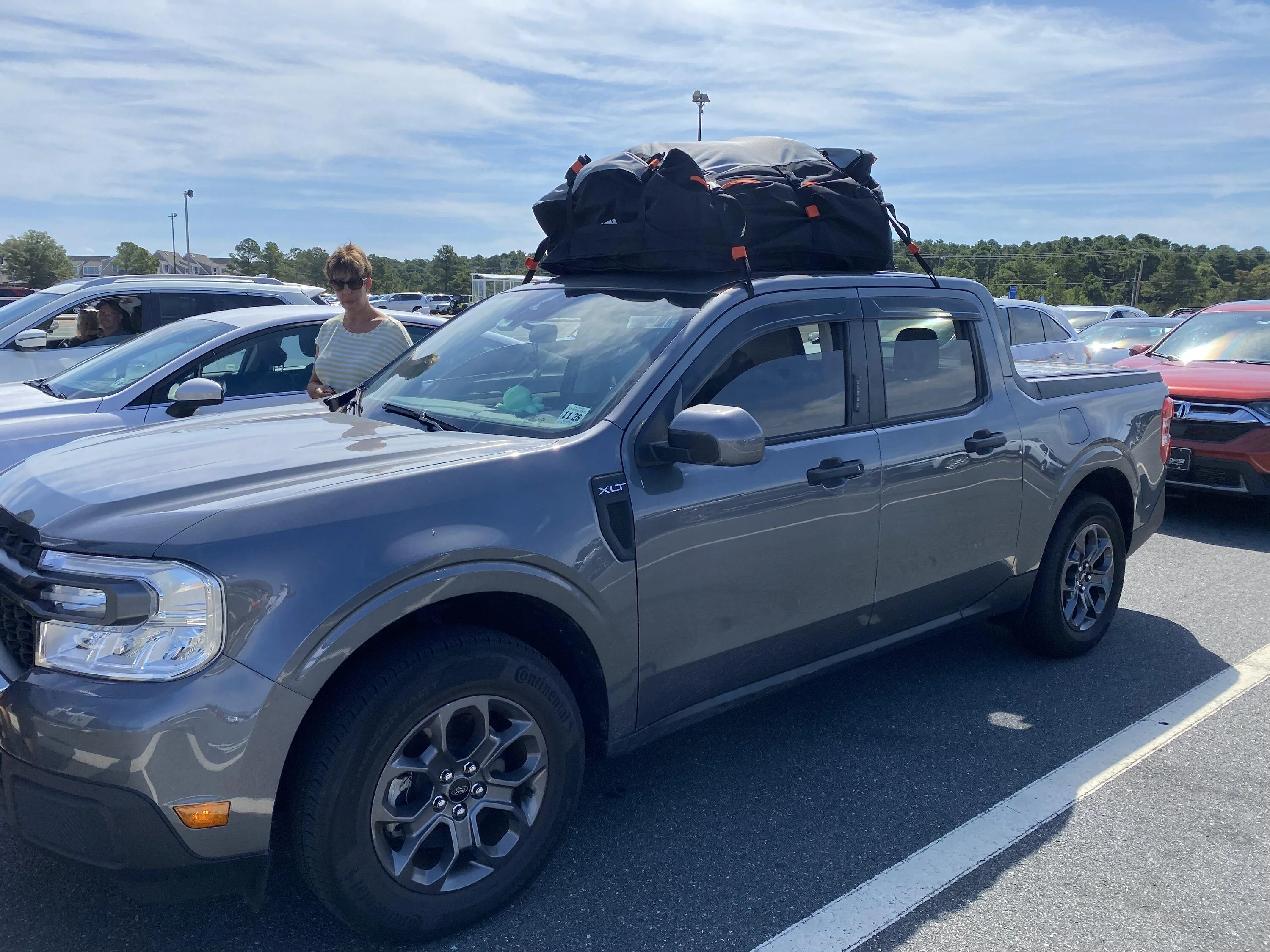

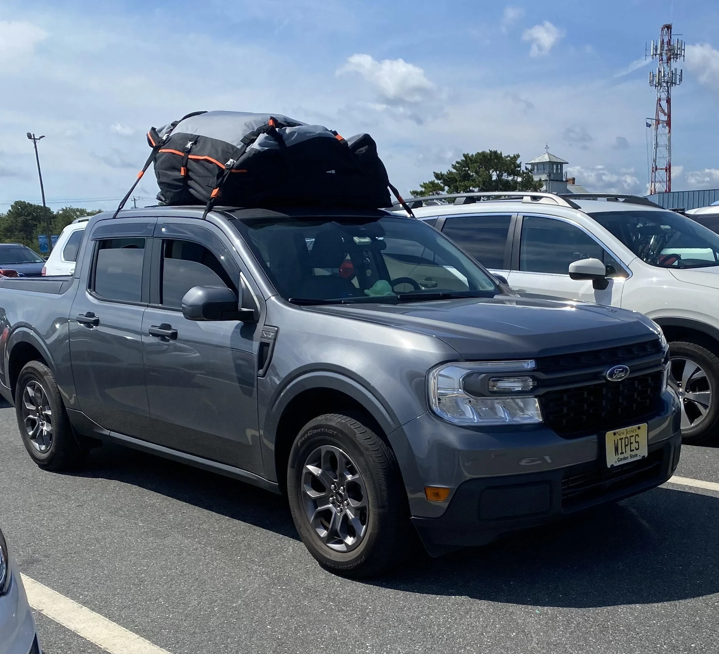

Just returned from our vacation. Yes it looks like ass. But it worked perfectly and stayed anchored securely.
Probably won’t be using it again for another year so staying under $200 made sense to me.

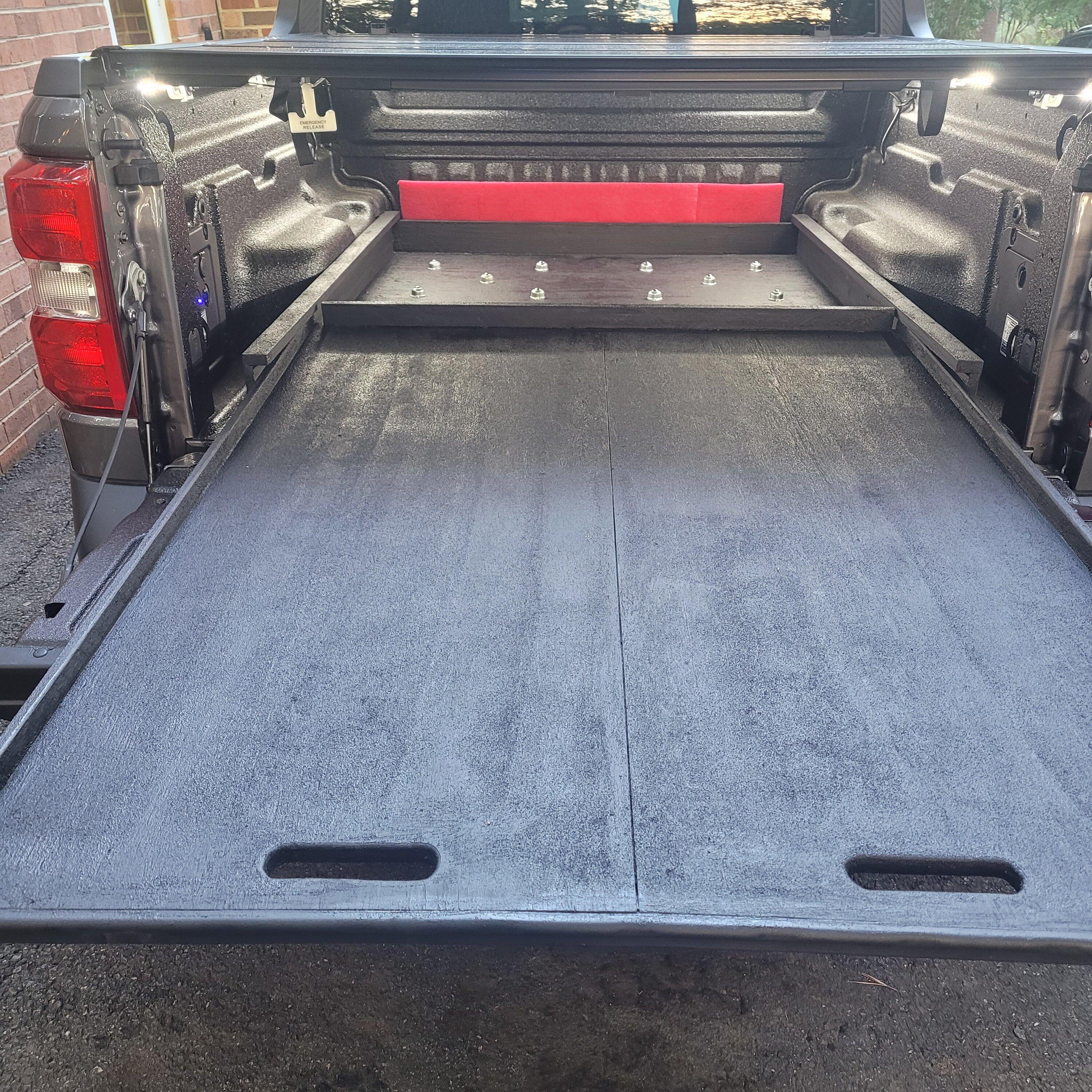

If you're referring to the slide out tray, that's what I built after watching of YouTube videos. Just search PICKUP TRUCK SLIDE OUT TRAY on YouTube and you'll see a bunch of DIY builds. Here's one.

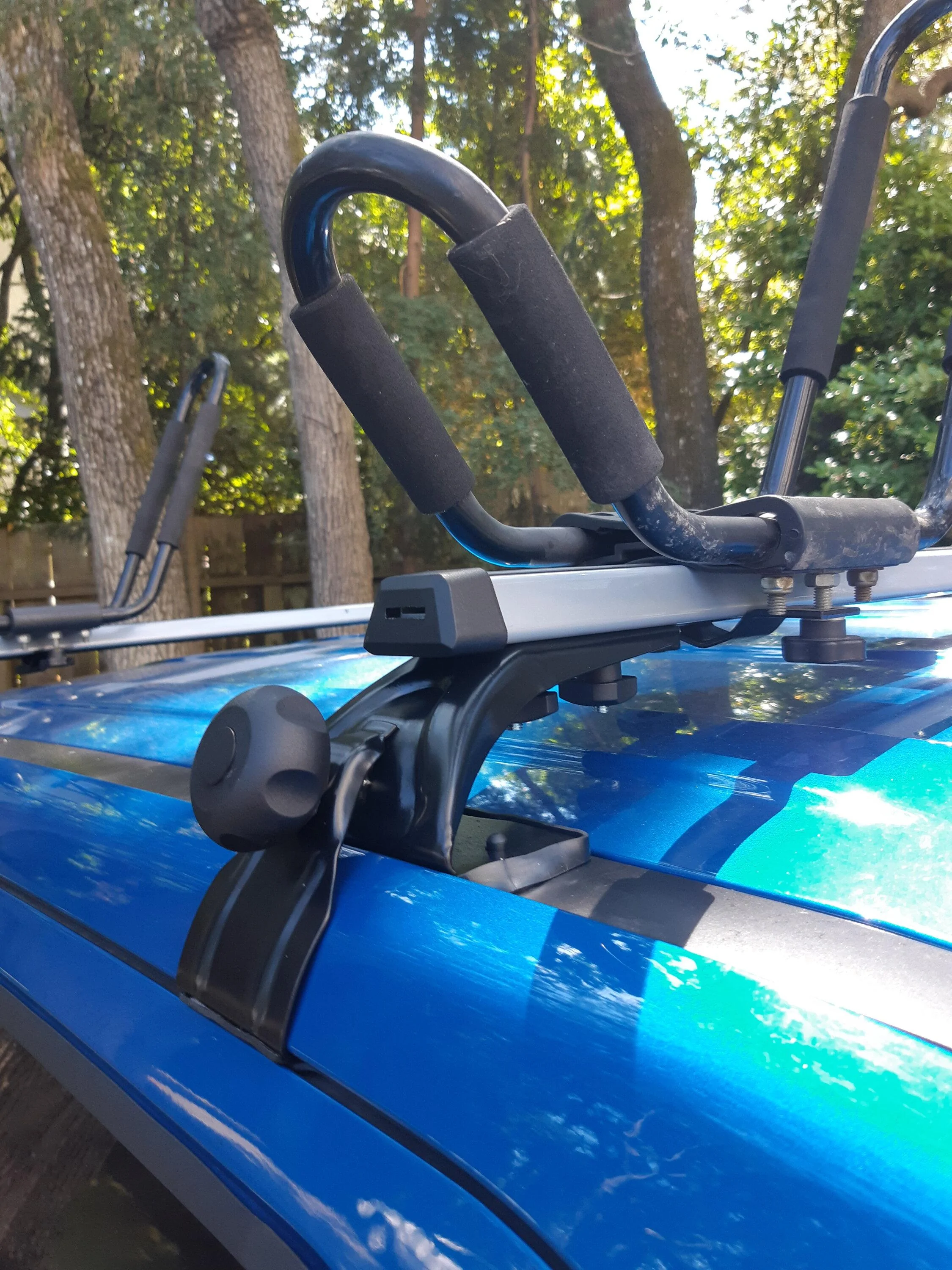

Here is a photo of the installation. Pretty low profile. Misses the antenna nicely. Fairly minor wind noise (I've added a kayak rack which does up the noise). But the rack fits really nicely and only takes a minute or two to remove or replace once you've set it up. I recommend writing front and rear on the appropriate racks as they are slightly different lengths

Looks like a nice fit, are the brackets painted or rubber coated? After use, any signs of paint wear? Thanks for sharing!
The brackets are painted but come with some stick on rubber pads. Not fancy but they work. No paint wear so far. The supplier I ordered from is showing out of stock now but Ebay has lots of sellers listing the same brackets. They are pretty generic.

I like the beefy hand knobs, no fumbling with Allen wrenches needed. Not readily seeing other racks with hand knobs. A tiny bit of added wind resistance/noise maybe but worth the convenience. Those tighten the crossbars down to the brackets correct? Looks like those would make adding and removing the entire rack quick and easy and for the rack to be securely tightened down.
UPDATE
Received my clamp on rack and a j-bar and they are not very compatible. The bottom of the cross bars for the rack are 2" wide and the slots of the bottom bracts for the j-bars is also 2" wide so none of the cross bar will seat inside the slots. It's too bad all the diagrams for these universal parts is not more exact/meaningful. The bracket measurement shows the width from bolt to bolt (3.5") and not the width of the slot for the crossbars to fit inside. My j-bar was missing all the bolts, washers, hand clamps, etc. so it had to be returned anyway. And I found another brand of j-bar which showed a measurement of 4.3" from bolt to bolt on the bottom bracket so I ordered it hoping the slot will also be wider and allow for some of the crossbar to seat at least a little down into the slot. The new j-bar is supposed to arrive on Wednesday and I have a planned trip for the following Friday morning so not a lot of time to get this all worked out.

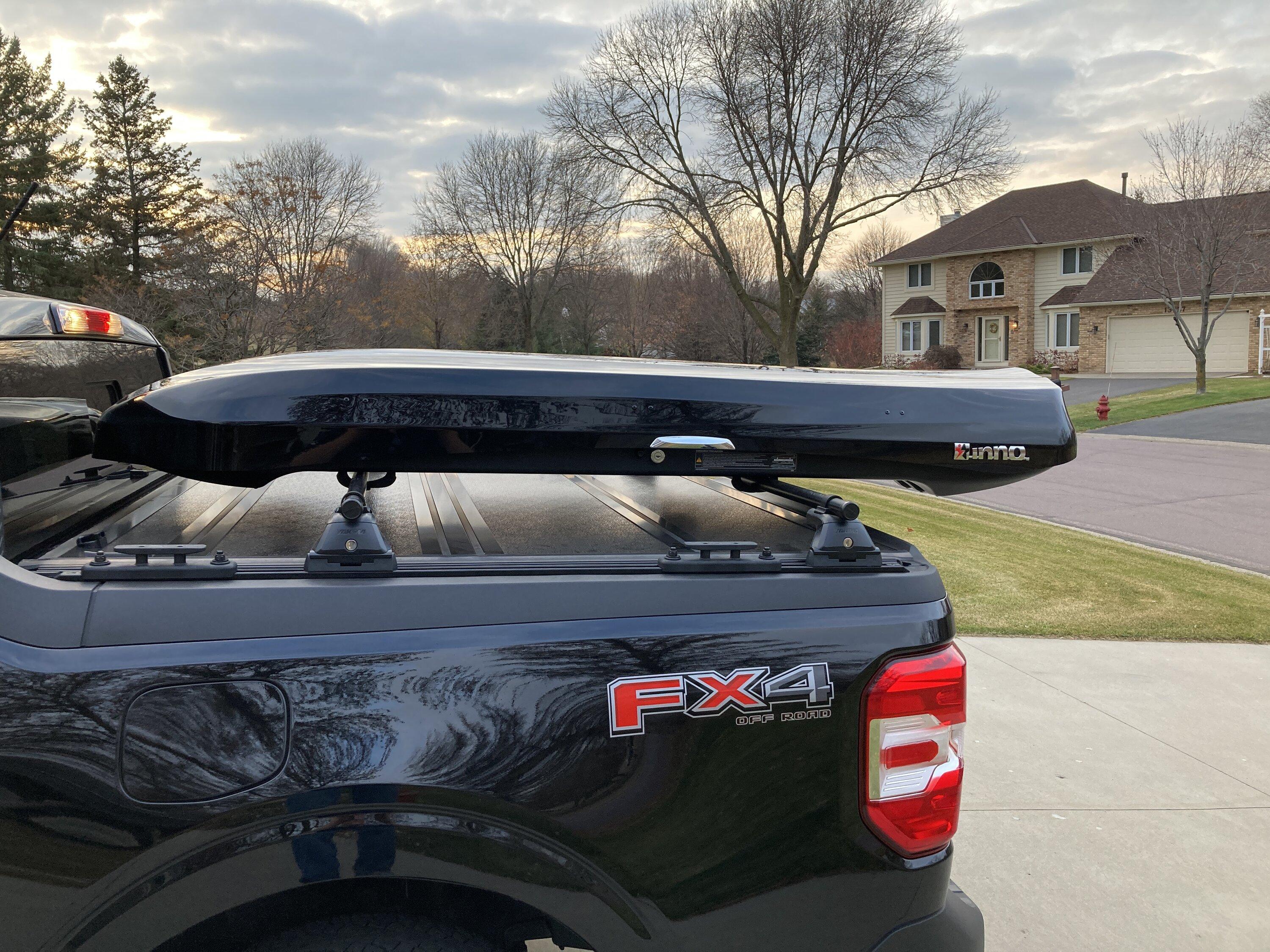

I had Yakima round bars so I did this.
I have the Ford tri-fold tonneau cover.
TruXedo Elevate TS RailsSet
$144.62​
Yakima Landing Pad 12 Sets
$143.90​
Yakima Skyline Towers
4​
$244.95​
Yakima Round Bar SL Adaptors
4​
$30.00​

cool solution. what impact on mpg did you notice and how's the noise? I think the OP definitely had some noise and serious mpg loss if he went 75-80+ mph.
you've got some decent $ in the hard tonneau but I think this still works without it?
also this might be a stupid idea and maybe you already thought of it or even tried it. but I wonder if there were would be any difference in noise & mpg if the box were mounted in reverse? the nose is out of the windstream a lot more than the tail, so perhaps flipping it would be a benefit.
