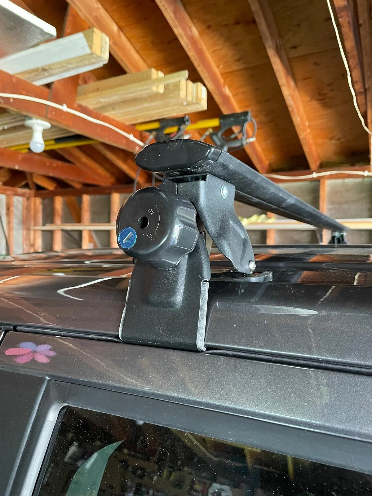

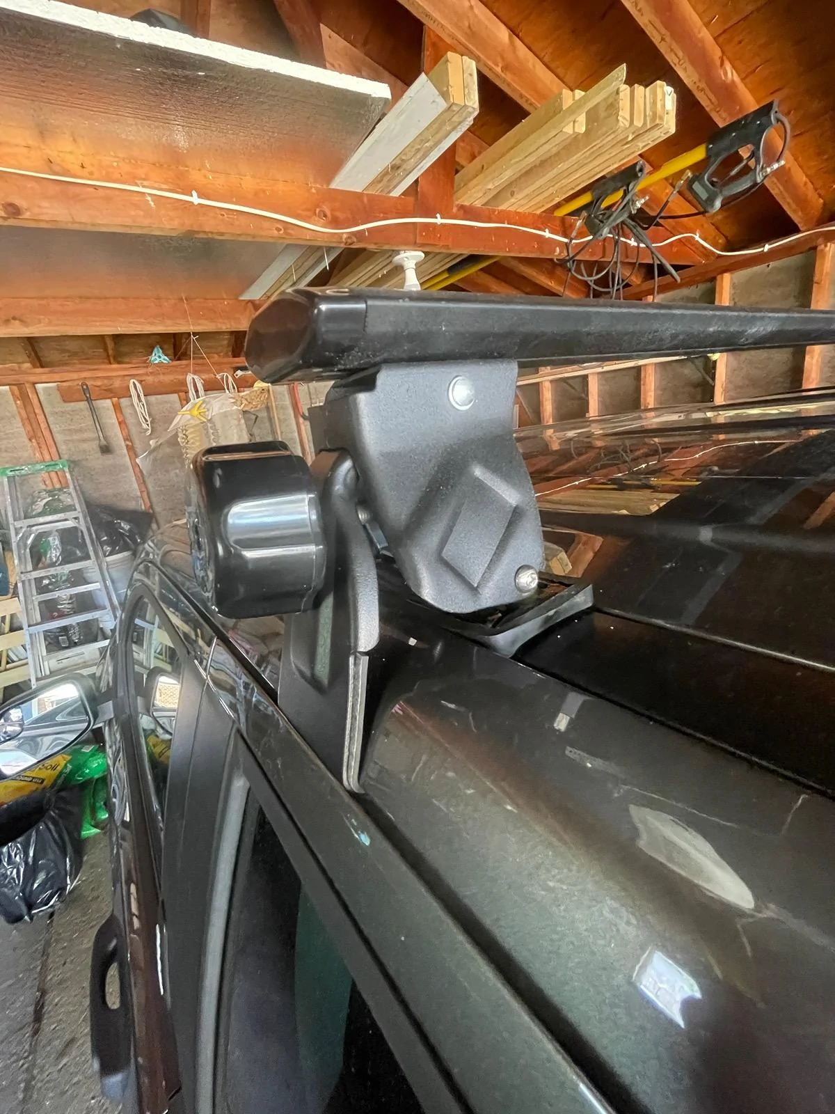

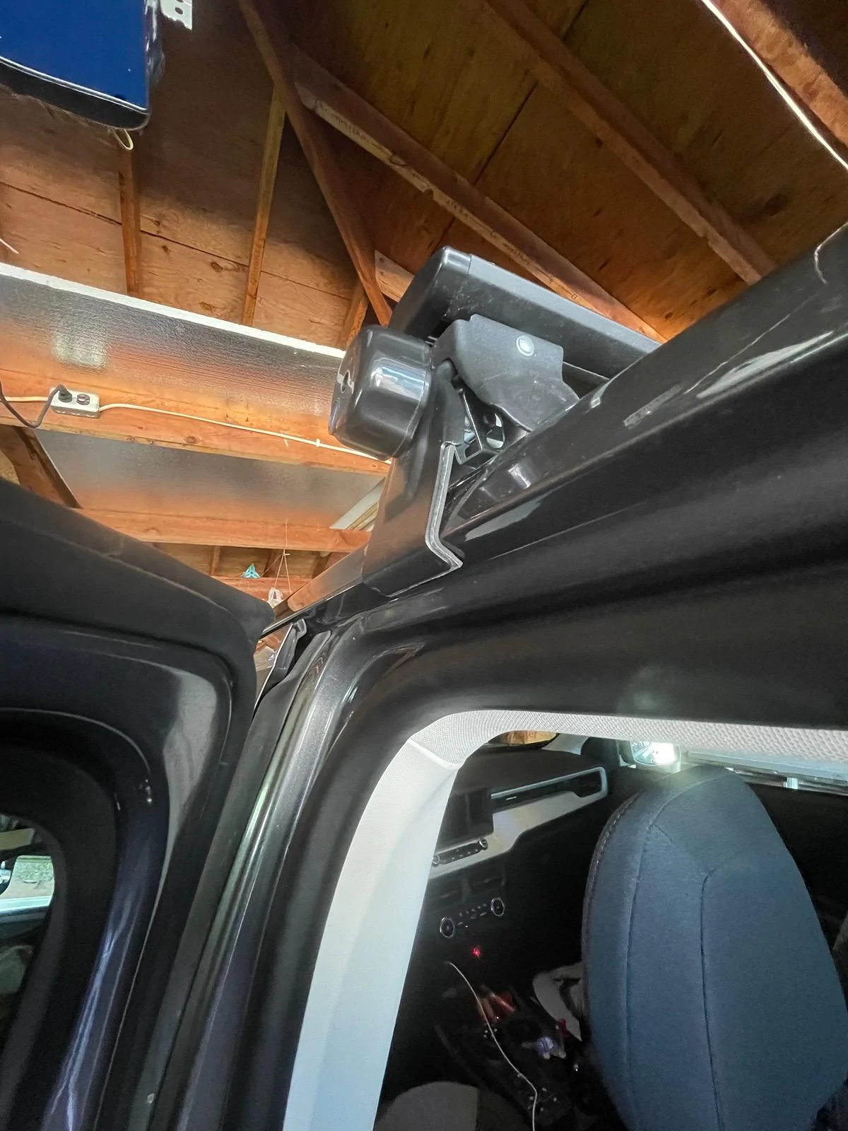

I have the Yakima towers with the clamps on my Maverick. I still use the round bars instead of the newer aero bars. The towers work with both styles of bar.
Let me know if you need any details.

Been looking for this info for a while and just stumbled upon your post. I have 48" round crossbars I was going to use but seems like they might be too short.
How far do your 58" bars hang over the roof ? Do you think the 48" bars might work ? Just tring to get ducks in a row before Mav is delivered in a month.

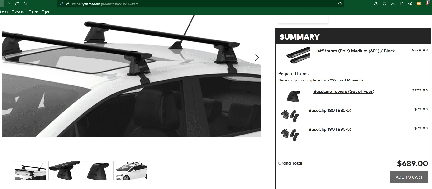

Two (2) 58-inch RoundBar (SKU: #8000409)
One (1) BaseLine Towers (Set of Four) (SKU: #8000162)
Two (2) BaseClip 180 (B85-5) (SKU: #8006180)
One (1) RoundBar SL Adapater (SKU: #8003536)
The BaseLine Towers rest on the roof.

The bars stick out less than 3 inches on either side. The 48-inch bars are not long enough.
