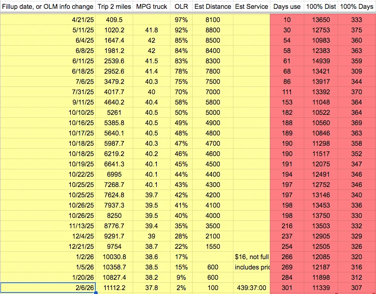

Here's the start of the reset OLM after my 1st oil change on 4/11/25. (I missed the 0% date by 3 days - 4/8/24 was the truck activation date when dealer enabled those module tracking systems)
2 last columns where I math out what the mile or days would be at 0% OLM if rest of the usage matched what I'd done so far, rounding errors possible. Trip 2 is from last oil change, with mpg so far.
End of Oct highway trip to NY and back to KC didn't impact much except avg mpg. Or did it?
Notice I managed some fillups on almost exactly monthly dates. Not planned.
The Ford app was also giving some estimated remaining miles. Maybe because I was on time based math initially? Since that is Ford servers not the truck's algorithm - they can change that at a whim, they used to give estimated service date up to my 1st oil change. Seems like the formula for that Est Distance left is rather simple - 44% = 4400?
1 month in - 8% drop. (hmmm, 8.3, time based so far)
2 months in - 17% drop. (16.6 rounded)
3 months in - 25% drop. (5 days short, 24.9 rounded)
5 months in - 42% drop. (41.5 rounded)
6 months - 50% drop. (49.8 rounded)
7 months - 65% drop. (58% if still time based, after long trip now mileage based. Or after it hits 50% it changes method to whatever is shorter?)
Ford Maverick Longest hybrid oil change interval?!? 1778174102292-6k
And even though I don't have a Lariat that would have told me exactly how many engine miles were done - I know from logging what the avg weekly is normally, and that trip at almost 100% engine miles. The engine had abouts 6500 miles on it - less than 2500 being those gentle highway miles.
I'm not concerned with the algorithm on the OLM. I was when I got truck - hence the tracking of all the figures I could on it. (I was also concerned when I got the crema in oil cap - until I saw ICE only vehicles with it, driven plenty)
So for this thread:
Longest in time - I'd be shocked if someone got OLM taking them past 1 year when few hard miles are driven.
Longest in mileage - 14k seems to be the winner!

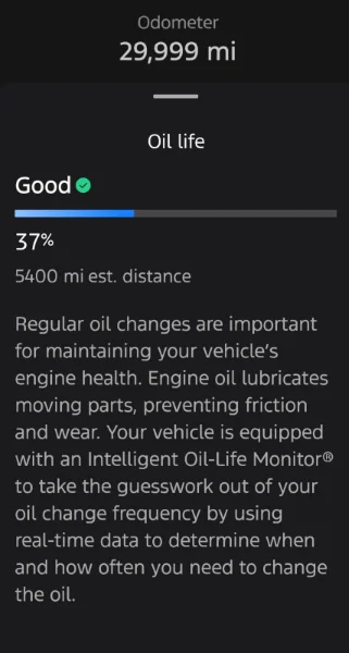

5.12 *update* - after a road trip to Yosemite, I'm at 29,999 miles now and 37% oil life, with 5400 remaining estimate = 14,500 for potential oil change interval. So it went UP, with some high speed freeway driving, medium speed foothills and a few short trips around the Valley.

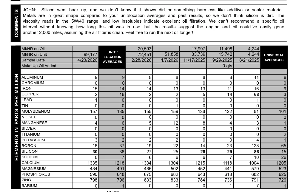

It really, really shouldn't. The OLM is doing math that has no basis in reality, on something that needs to be properly tested to accurately reflect. Here's my recent oil sample report, with 26,726 on the oil:
Ford Maverick Longest hybrid oil change interval?!? Screenshot_2026-05-14_13-43-23
After this oil change on 4-23, the truck sat for a week getting the battery replaced, was back on the road 4-30, OLM hit 0% at 104,998 (or 5,821 miles) on 5-12, 1,750 of those miles being deadhead (no trailer attached).
So, just because I tow, the OLM drops to 0% in 2 weeks, with half the recommended miles, so I probably reset it 5-6 times in between actual oil changes. :LOL:
Actually, I think I may have to start replacing the air filter more often than getting an oil change...
ETA: I would be interested to hear from an EB owner on what their reports look like, I suspect they will be fine past 10k even with "normal" drive cycles.
