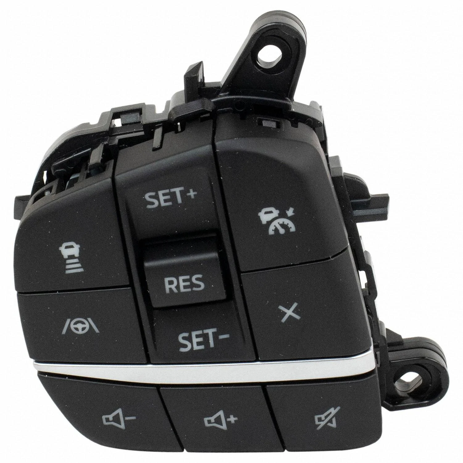

I have a different question for you along the same lines. Lariat owner with ACC and lane Centering, is there a way to code the Lane Centering to work on it's own without having ACC activated?
It will depend if lane centering requires both the front camera and lower radar sensor. If it only requires the front camera then in theory yes it should be able to be made workable without ACC.
If that is the case you'd have to use switch SW8585 instead of SW8579, program the SCCM accordingly then program the IPMA, PSCM and IPC modules for lane centering.
Assuming that all works all the buttons on the switch SW8585 pictured below would work now except for the ACC button which is the upper left button.
That looks like the switch I have but I will have to double check. I still want ACC to work when I hit the button for it, I just want Lane Centering to work independently from ACC. Maybe it's a lost cause and I just have to accept they are one in the same.
