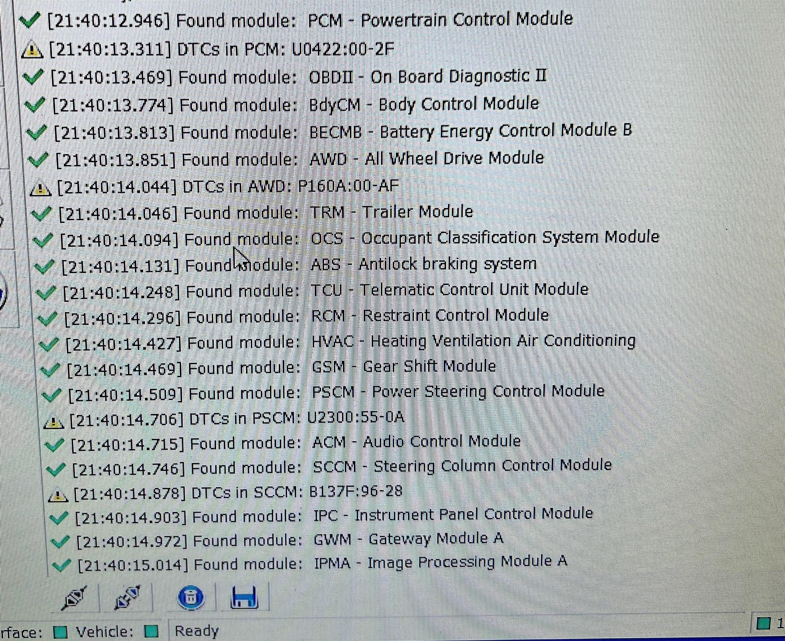

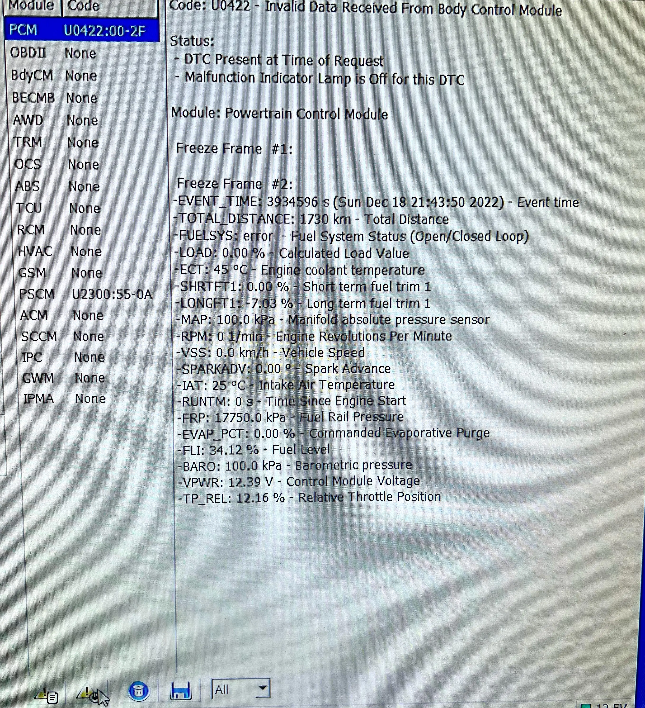

As the title says I installed the ACC left buttons instead of the regular CC buttons as I intend on doing the ACC mod in the future, just not right now. It seems like reading the thread that this should work, but now I’m reading another thread that says it will not. The buttons function for cruise and volume, but I’m getting the service AWD P160 error. Is there anyway to make this work as is?
