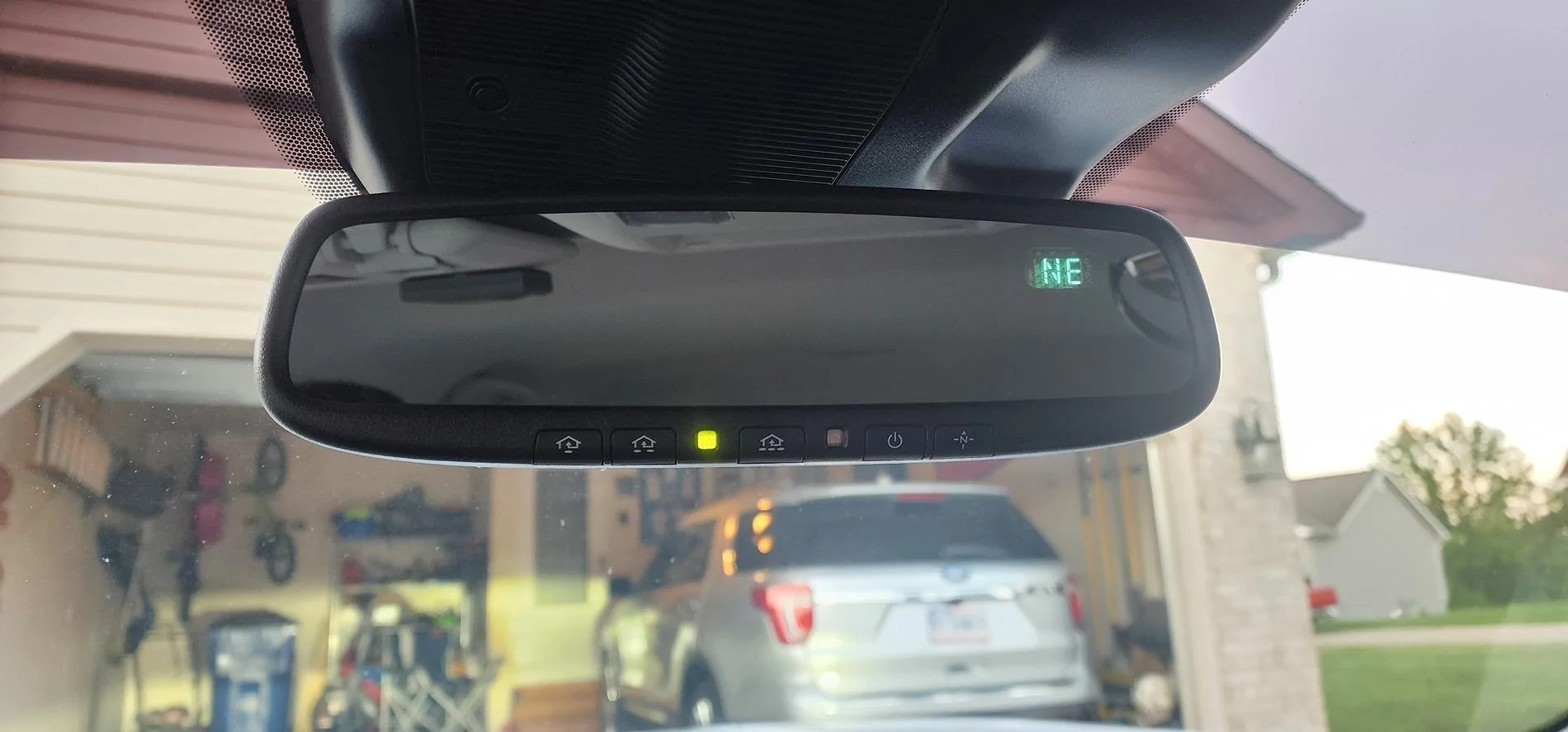

Arrived today & installed in 30 minutes. Love have the dimming mirror and built in garage door openers, no more clip on garage door opener on the sun visor....
I used @Crowman directions for wiring up the mirror to the proper colored wires coming off the dome light harness. I used the included pigtail for the mirrors harness, cut it down to 7". As the pigtail was 4' long before cutting.
Still surprised how inexpensive this mod was, 31.85 shipped isn't bad at all. 20.38 for the mirror and 11.47 for shipping. I keep the compass off as I really only wanted it for the openers and dimming at night.
Ford Maverick Kia Homelink mirror installed 20240701_202101
