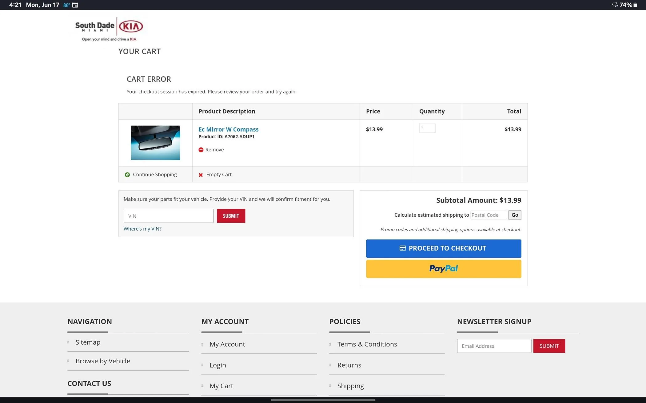

Anybody else get a cart error when trying to check out?

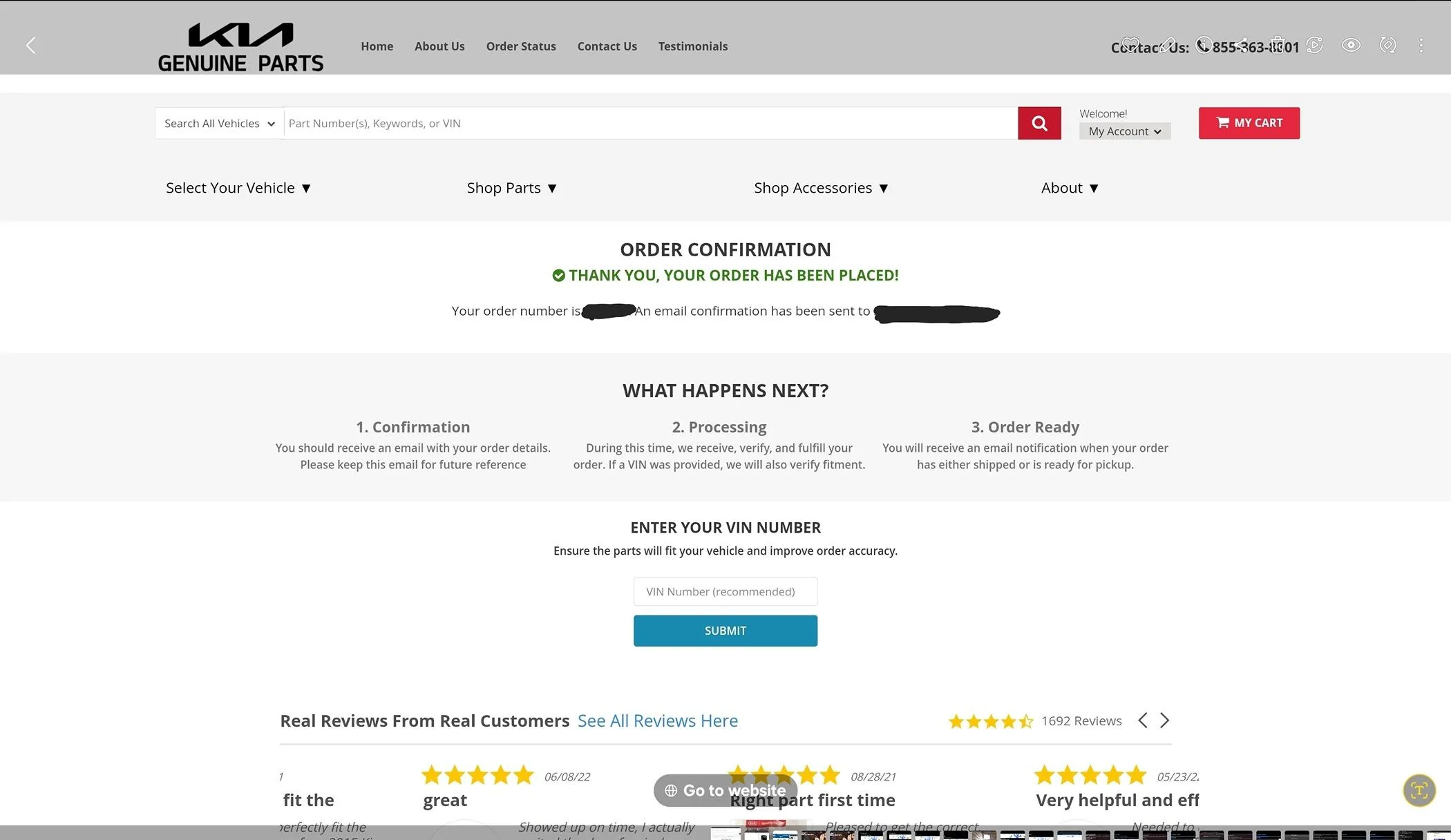

Ok, order placed...👍😎
