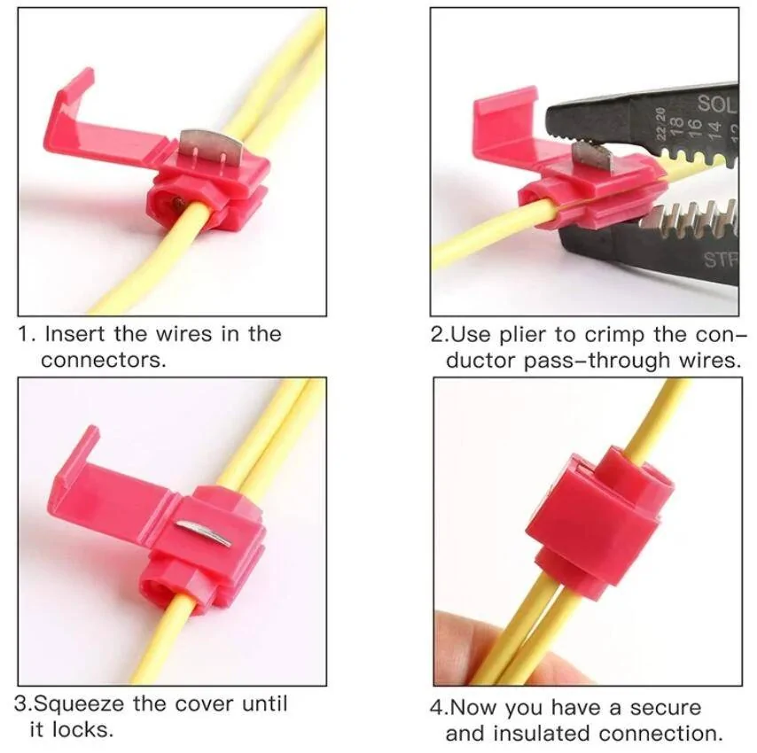

Whichever mirror you get, it should come with a wire lead to a connector AND the mating connector as a pigtail. You can either splice the pigtail directly to the vehicle wiring or into the YTB harness. Either solution works.
The dome light area is a tight space with short wire leads, and the T-taps that come with the mirrors are tough to fit up there. I would purchase either the YTB harness or this style of lower-profile IDC taps (though IDC taps can be controversial).
Agree, if you tap the dome light power, getting the smallest gauge taps in there is tough, and the dome light wire gauge is very small, so getting a good connection is difficult. Further, I had to go back in the with a pick to snug up the dome light connector pins, as the work to attach the taps, unplugging and replugging the connector caused the dome light to be intermittent.

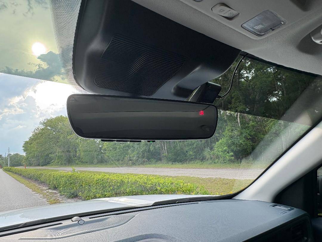

I have a 24 lariat, this combo took about 15 minutes to install and worth every penny!
