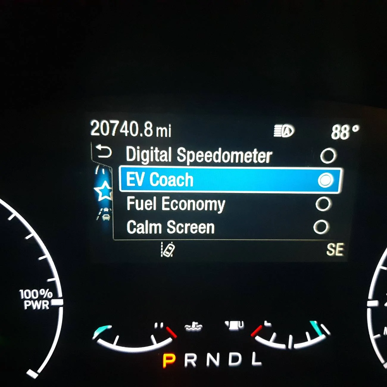

As a hybrid owner myself 🤔 hmmm.
Every little bit helps.
Thank you 👍
I don't recall seeing a "hybrid coach" on our earlier year hybrids. Brake coach, yeah.

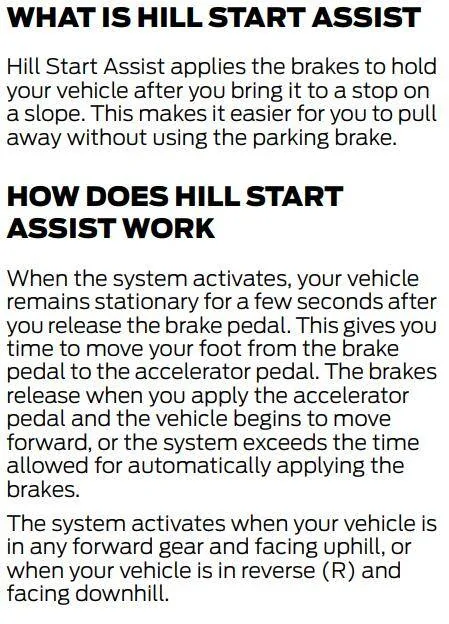

In the 1950's hill holder feature was incorporated in some manual transmission vehicles. After stopping on uphill incline, driver can remove right foot from brake and position foot at accelerator. Brake holds until clutch is engaged, mitigating rollback. It operated much like Auto Hold in modern cars.
I understand you perfectly, so you don't have to repeat yourself. This feature you're describing is called Hill Start Assist in modern Ford vehicles, manual and automatic. It is a separate feature from Auto Hold in your Maverick and can't be turned off.
My manual transmission Ford Focus also has this feature.
From the Maverick Owner's manual:
