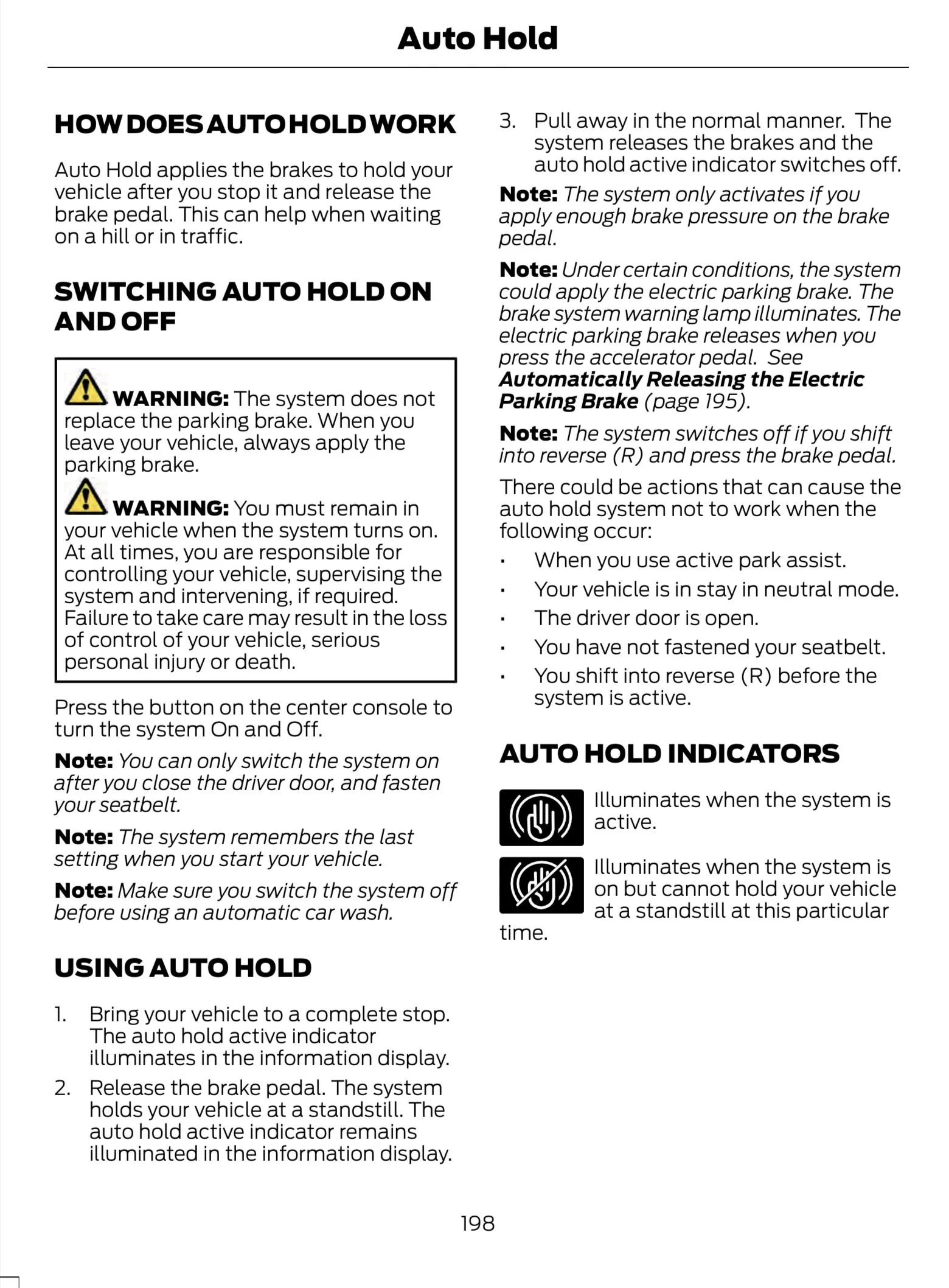

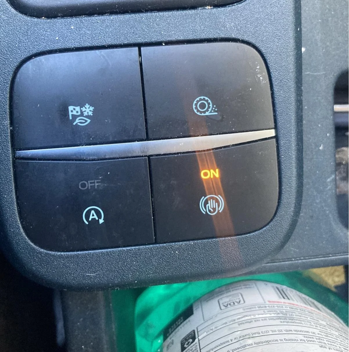

Please, any existing owners confirm something about the Auto Hold feature. If you have it turned on and shut down the truck, upon restart the truck should automatically turn Auto Hold back on. It's supposed to remember at start up if it was on or off at last shut down. Thanks.
Remember-Auto hold MUST be turned off when driving thru a car wash, once shifted into neutral.

It stays on as long as you don't turn the function off manually. It is a great feature and I love it, no reason to shut it off.

Good to hear Auto Hold is working as described in the manual. I ask because the manual for my '21 Lincoln Navigator has the exact same verbage in the manual as the Maverick's, but it will not remember the last setting. On start up it comes on, but immediately turns off. Back to the Maverick though, I'll be checking this myself when I get mine. Thanks all.
