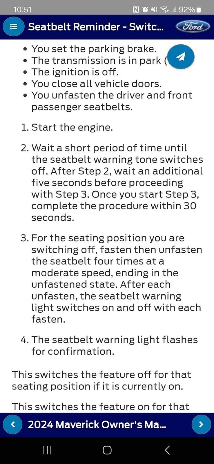

This is how you disable the seatbelt chimes

Sure did. You have to do it for the passenger seat too
And the process often has to be repeated several times. But patience will eventually pay off. If you can't get it to work, just abandon the effort and try another day.
I did both driver & passenger seats with no helper. Although some have said you need someone sitting in both front seats to do the passenger. That was not the case for me. One thing to try if you initially fail is to try it with the Parking Brake ON, or OFF, if ON doesn't work.
NOTE: If you take the truck to a dealer for software updates, the process may have to be done over again, afterward.

For my 2025 Lariat Hybrid AWD I had to ignore steps 1. and 2. In the OM and do 3. and 4. Only and it worked.

Do you need to be sitting in the seat you are trying turn off or not sitting in it?

My 2024 manual (hardcopy for Ecoboost) is slightly different.
In Step 1, it specifically states to turn on but do NOT start the vehicle.
I guess if doesn't work one way, try the other.
Sitting in seat. Literally cross out steps 1. and 2. Then follow everything else precisely top to bottom.
