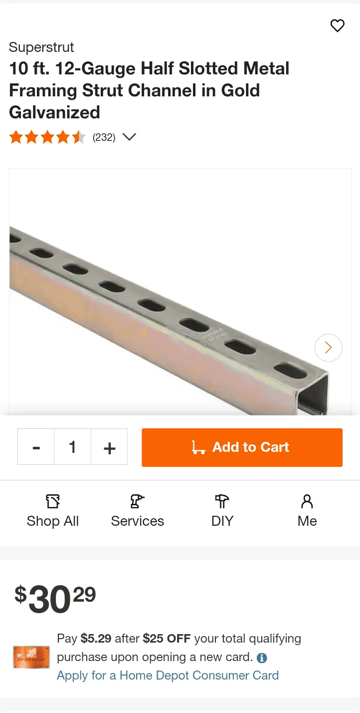

Available at big box or electrical supply. There are many fittings available online. Search for strut channel or unistrut

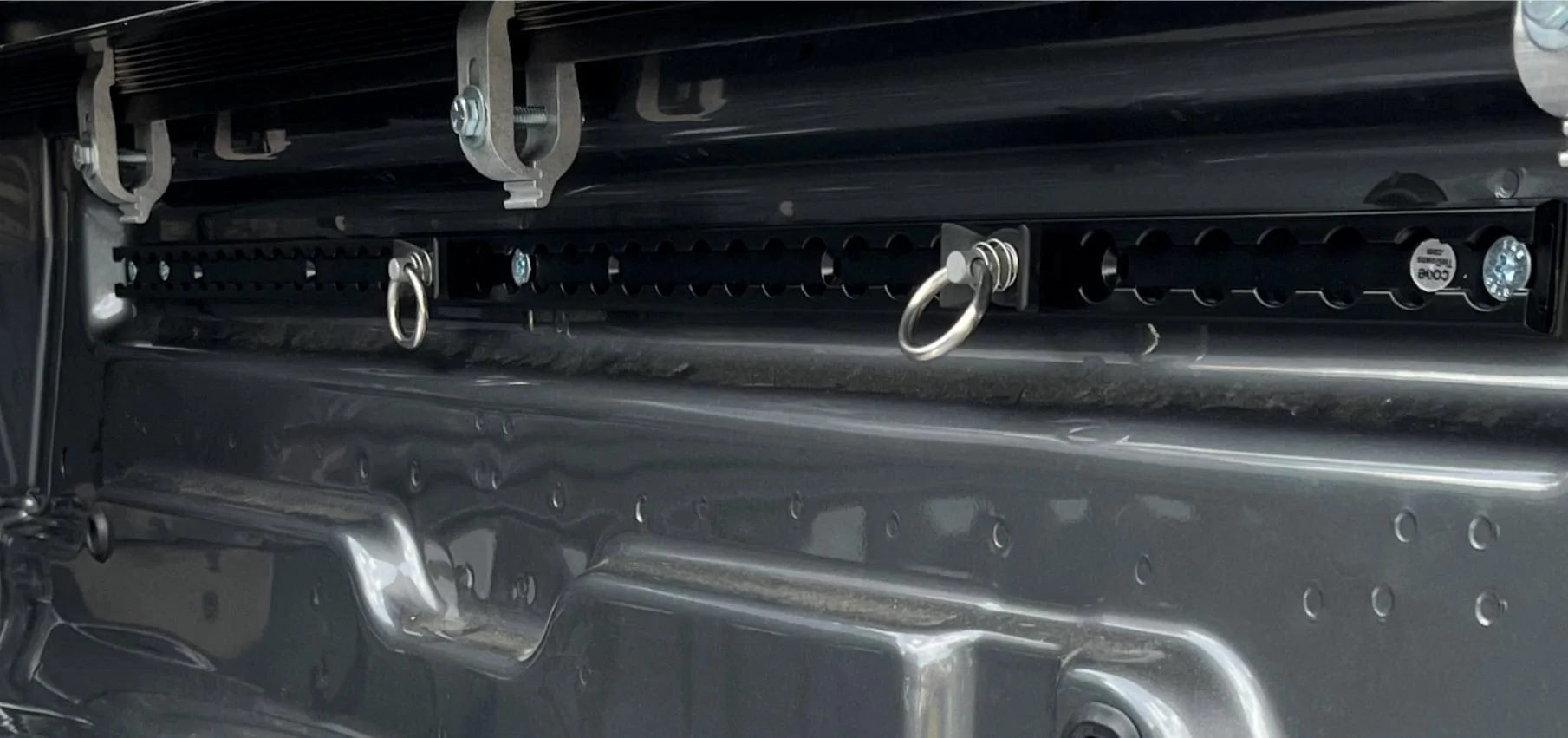

I cut about 6" off of a pair of 48" angled L-track kits that only cost CDN$78 from Calgary. They each came with a heavy duty tiedown slider, end caps and a full set of nuts, bolts and body washers that I discarded. I bought some M8x30 countersunk bolts that threaded right into the existing nuts in the body, and drilled the required extra holes in the L-track. I think it actually works better than the super-overpriced Ford rails. All-in it was about $90 Canadian, or call it $60 American.

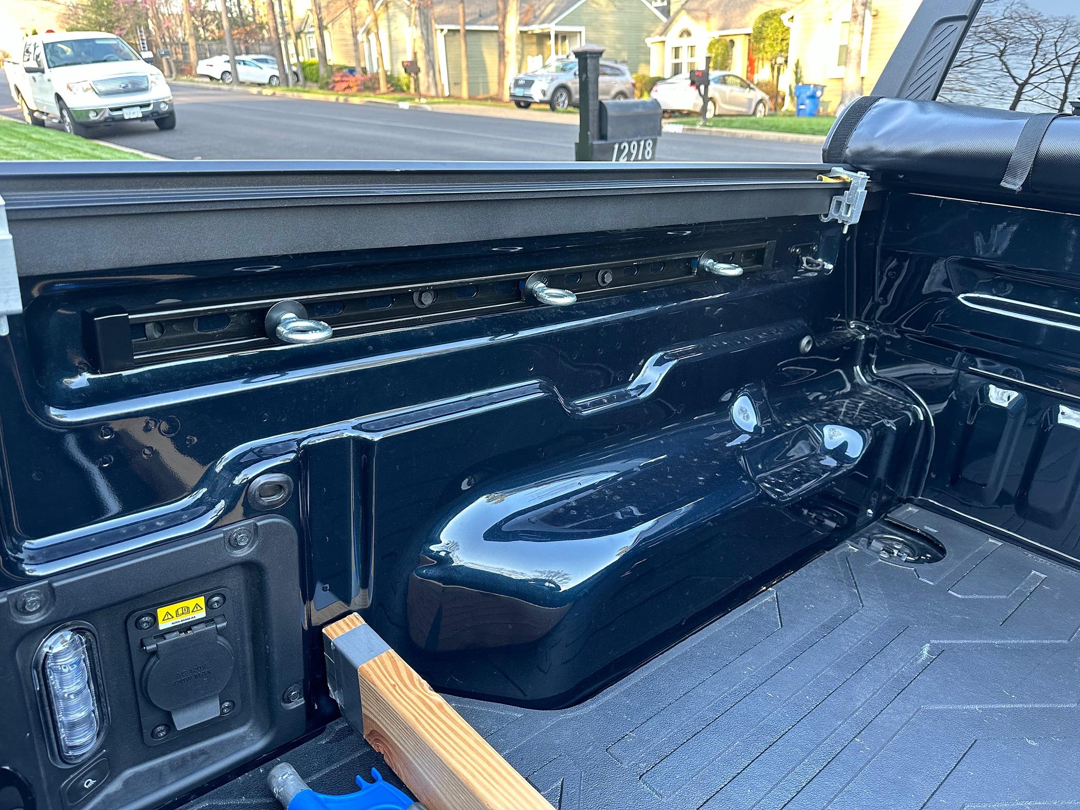

I bought 36” black strut channels from Grainger. 14 guage looks better than the 12 guage imo. The eye bolts can’t slide past the mounting bolt heads on the 14 guage so put in an extra eye bolt as well for full coverage.

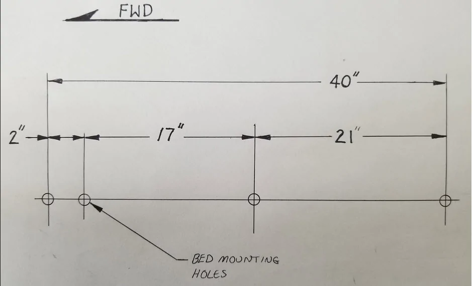

BE CAREFUL if you order after market. I bought a set of rails for my XL when I found out that they were not standard equipment. My set was from Amazon, EXPRESSLY DESIGNED TO FIT THE MAVERICK. Well, the holes didn't match up. I ended up drilling and pop-riveting them into place. They work fine, but it was a PITA. I would recommend that you get exact measurements for the manuracturer on how far apart the holes are on his rail, then compare that to the holes in your walls. Good Luck. P.S. The adjustable pad eyes really come in handy for tightening up large objects like a kayak.
