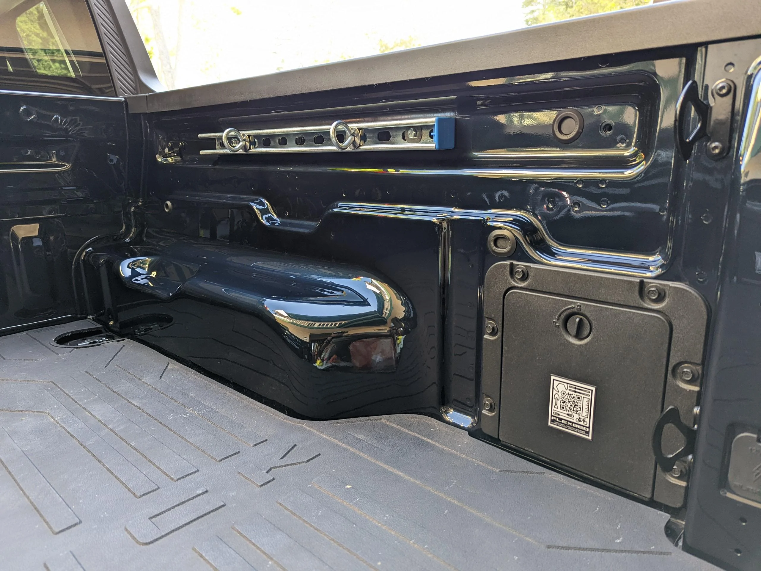

Super easy DIY project. Only thing about it is that you can buy 24" length rails only versus Ford's suggested 30". Only way to get this is if you buy a full length rails and you cut your own. I initially was going to follow Ford's diy video, but I actually followed this guy's video, super helpful and all the hardware he lists fit perfectly, so I recommend following his video here:
The materials were split between Home Depot and Lowe's but my Lowe's is a smaller one not as fully stocked. All said and done right around $50.
Final product looks good, I would like them to be black, but I have no idea what could maintain the paint without the strut cone nuts shaving it off when they slide. Any suggestions let me know please! (Also, like an idiot I only bought two end caps so I'll have to buy two more.)
