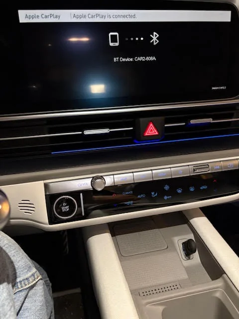

I have a well-reviewed Ottocast Mini 2-1 wireless adapter that I use with my iPhone 16 in our Ioniq 6 (the 24s have wireless charging but NOT wireless carplay!) - anyway, we've had it all only a couple of months, When I first put in the adapter it worked great sarting up fast and connecting to the phone, but lately it's 50/50 that it will connect immediately to the phone. It always starts up quickly and the car recognizes the dongle as CarPlay... but then it just sits there with a blinking blue link LED until it and the phone connect (LED on solid and CarPlay pops on the screen). Sometimes it works near instantly, sometimes it takes a minute, sometimes I need to remove/re-install the dongle.
Ottocast is actively looking into this. They've been surprisingly supportive and the dongle itself can be updated over the air from the phone app, so we'll see if they find a fix though I suspect it's more of an issue with Apple.
https://www.amazon.com/OTTOCAST-Wir...dapter/dp/B0F2SX1JHJ/ref=ast_sto_dp_puis?th=1
You can see the screen I get when it's waiting for the phone. The dongle is plugged into the USB port - the charging pad is there above and to the left (it works better than the charging pad in the Maverick plus is has a grid of amber LEDs that show when it's actively charging).
