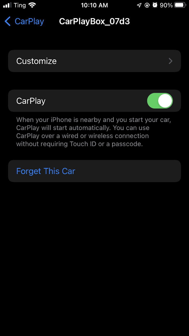

I just got this yesterday, so this may be some quirks with getting things setup correctly. I've updated the device to the latest firmware and factory reset, and reconnected everything.
I'm trying to figure out how to get the TNVTEC carplay unit to consistently connect and launch automatically when I get in the truck. What I'm gathering is that the device boots, your phone does a bluetooth handshake with it, and then your phone switches to WIFI connection to the unit to launch Carplay, and your bluetooth connection to the device drops at that point.
It seems my phone is showing WIFI connected, but it's not always launching Carplay. Does anyone else know if there's something I need to do in particular to make sure the handshake launches correctly? Do I need to go into the 192.168.2.1 settings menu for the device and make it delay 5 seconds to let the SYNC3 system boot up first maybe?
go to iphone settings, general/car play/carplaybox/turn on carplay to start automatically
