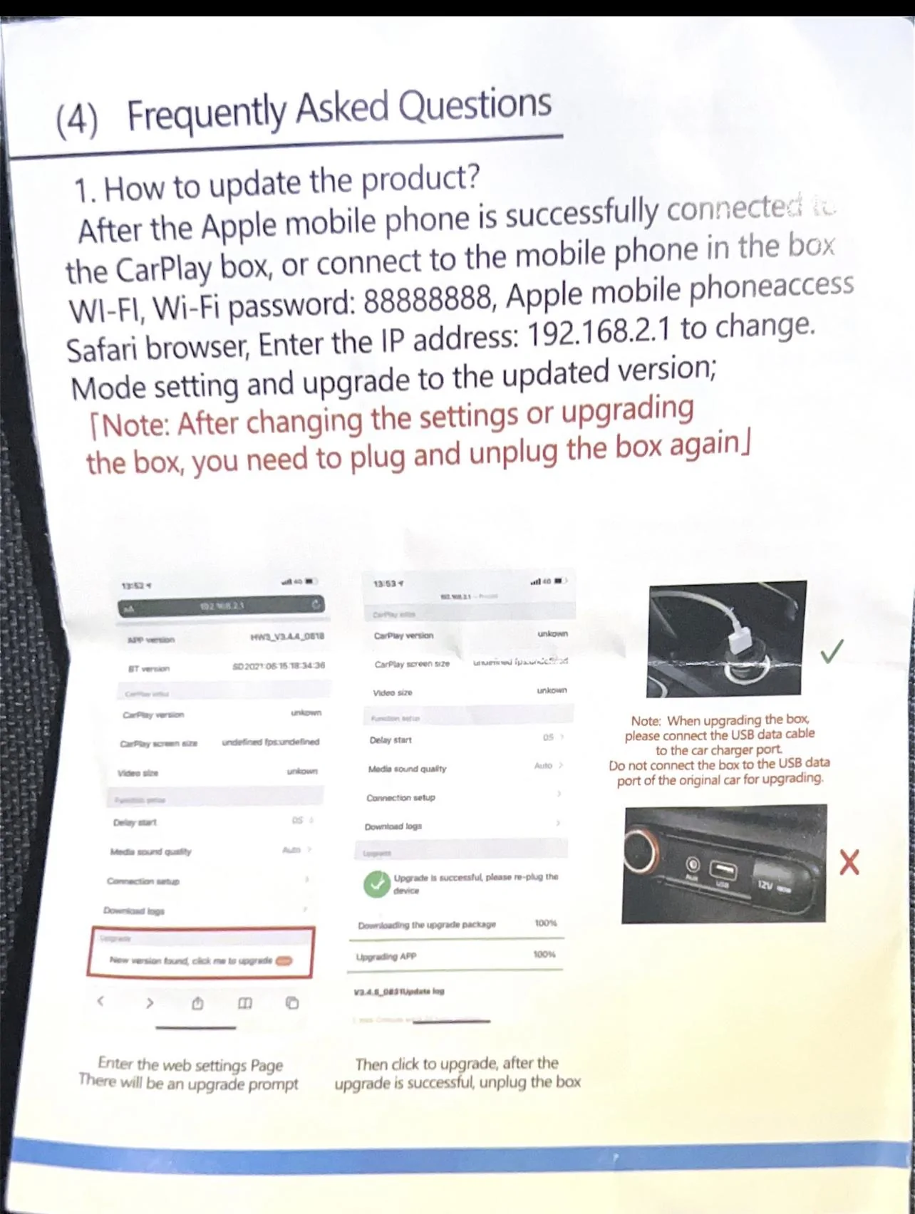

Is there anyway to update the tnvtec itself? Mine has barely worked over the past few months. Im ready to return it.

Yeah, look at the pamphlet. You go to the IP address in safari and it will let you update.
Unfortunately I lost the pamphlet :(
